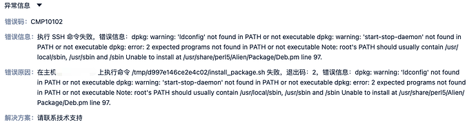

【问题描述】使用pbd部署集群及OCP完成后,初始化过程中的问题,Install ocp agent 步骤出的问题。
错误提示:
错误码CMP10102
错误信息执行 SSH 命令失败,错误信息:dpkg: warning: 'ldconfig' not found in PATH or not executable dpkg: warning: 'start-stop-daemon' not found in PATH or not executable dpkg: error: 2 expected programs not found in PATH or not executable Note: root's PATH should usually contain /usr/local/sbin, /usr/sbin and /sbin Unable to install at /usr/share/perl5/Alien/Package/Deb.pm line 97.
错误原因在主机 10.46.128.11 上执行命令 /tmp/d997e146ce2e4c02/install_package.sh 失败,退出码:2,错误信息:dpkg: warning: 'ldconfig' not found in PATH or not executable dpkg: warning: 'start-stop-daemon' not found in PATH or not executable dpkg: error: 2 expected programs not found in PATH or not executable Note: root's PATH should usually contain /usr/local/sbin, /usr/sbin and /sbin Unable to install at /usr/share/perl5/Alien/Package/Deb.pm line 97.
