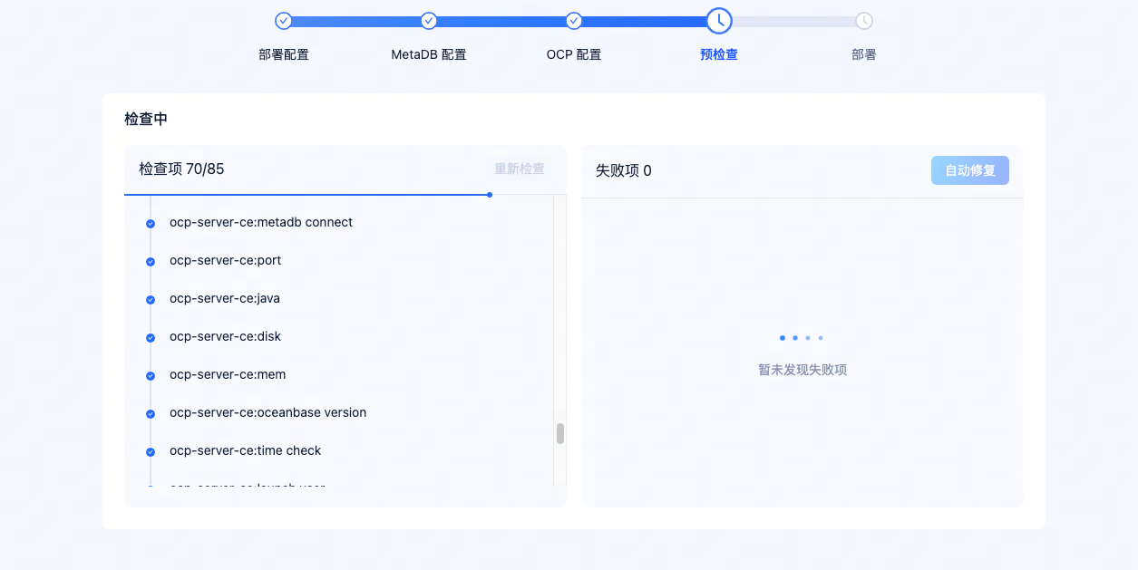

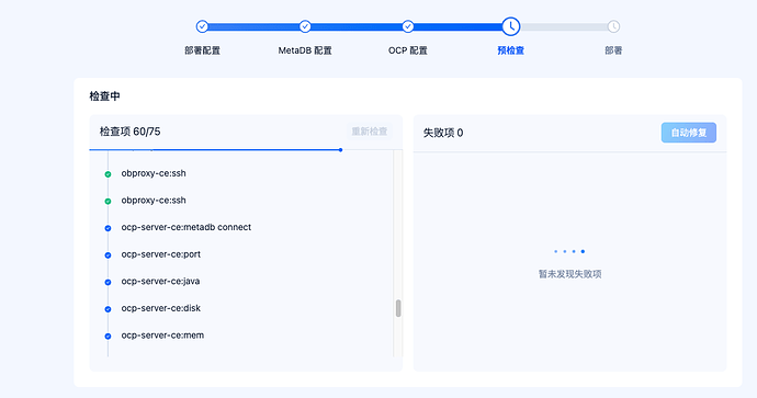

【问题描述】全新集群与OCP安装预检查会夯住,会进入死循环等待。

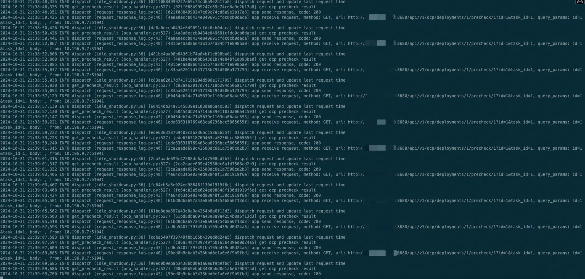

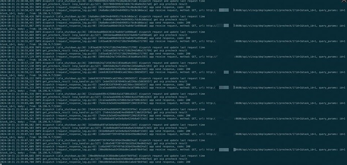

obd web后台日志:
【 使用环境 】 测试环境
【 OceanBase Deploy: v2.10.1 】
obd web后台日志:

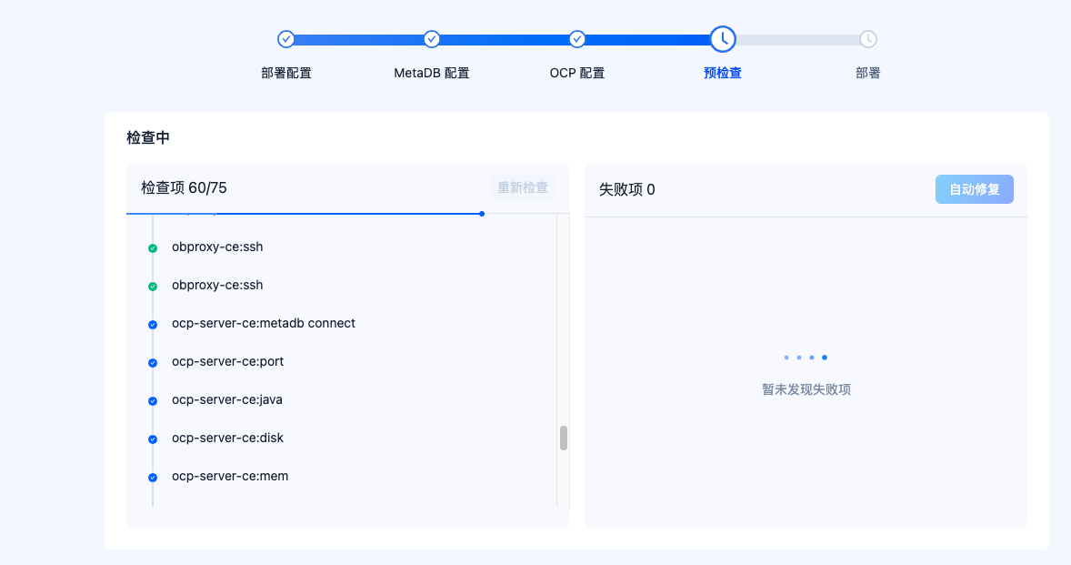

刷新页面重新检查也是卡住么
是的,刷新页面也没有用,这个有尝试过 。

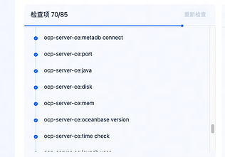

卡在了哪一项能截图看看么
就是我截图中的那块,这些应该都是没检查通过的
其他的是绿色的,应该是通过的吧。
你的ocp服务ip选择的是单独ip么
可以提供一下配置信息么。这边复现一下
ocp是节点是与observer复用的机器,我一共有a、b、c三台机器,ocp也是部署在a上面的,我的部署机器也是a,我的场景是在用三台机器搭建一个ob测试集群。

[2024-11-01 15:45:33.599] [DEBUG] - Applying oceanbase-ce-param-4.2.1.4 for oceanbase-ce-4.2.1.8-108000022024072217.el7-499b676f2ede5a16e0c07b2b15991d1160d972e8
[2024-11-01 15:45:34.234] [DEBUG] - Search param plugin for obproxy-ce
[2024-11-01 15:45:34.235] [DEBUG] - Found for obproxy-ce-param-4.3.0 for obproxy-ce-4.3.1.0
[2024-11-01 15:45:34.235] [DEBUG] - Applying obproxy-ce-param-4.3.0 for obproxy-ce-4.3.1.0-4.el7-835f4803c1f4da186439323b66c51db4662678a3
[2024-11-01 15:45:34.394] [DEBUG] - Search param plugin for ocp-server-ce
[2024-11-01 15:45:34.395] [DEBUG] - Found for ocp-server-ce-param-4.2.1 for ocp-server-ce-4.3.2
[2024-11-01 15:45:34.395] [DEBUG] - Applying ocp-server-ce-param-4.2.1 for ocp-server-ce-4.3.2-20241012145836.el7-610610e2daf63f6df08af686f9a88b6d8cefcc52
[2024-11-01 15:45:34.637] [INFO] Open ssh connection
[2024-11-01 15:45:34.642] [DEBUG] - host: 192.168.1.22, port: 1046, user: dba, password: None
[2024-11-01 15:45:34.732] [DEBUG] - host: 192.168.1.23, port: 1046, user: dba, password: None
[2024-11-01 15:45:34.815] [DEBUG] - host: 192.168.1.24, port: 1046, user: dba, password: None
[2024-11-01 15:45:34.939] [DEBUG] - Call ocp-server-ce-py_script_start_check-4.2.2 for ocp-server-ce-4.3.2-20241012145836.el7-610610e2daf63f6df08af686f9a88b6d8cefcc52
[2024-11-01 15:45:34.939] [DEBUG] - import start_check
[2024-11-01 15:45:34.946] [DEBUG] - add start_check ref count to 1
[2024-11-01 15:45:34.947] [INFO] Check before start ocp-server
[2024-11-01 15:45:34.952] [DEBUG] -- oceanbase version check
[2024-11-01 15:45:34.953] [DEBUG] -- dba@192.168.1.24 execute: sudo -n true
[2024-11-01 15:45:34.972] [DEBUG] -- exited code 0
[2024-11-01 15:45:34.973] [DEBUG] -- dba@192.168.1.24 execute: sudo cat /home/dba/obtest/ocp/run/ocp-server.pid
[2024-11-01 15:45:35.032] [DEBUG] -- exited code 1, error output:
[2024-11-01 15:45:35.032] [DEBUG] cat: /home/dba/obtest/ocp/run/ocp-server.pid: No such file or directory
[2024-11-01 15:45:35.033] [DEBUG]
[2024-11-01 15:45:35.033] [DEBUG] -- user check
[2024-11-01 15:45:35.033] [DEBUG] -- dba@192.168.1.24 execute: sudo id -u dba
[2024-11-01 15:45:35.090] [DEBUG] -- exited code 0
[2024-11-01 15:45:35.091] [DEBUG] -- port check
[2024-11-01 15:45:35.091] [DEBUG] -- dba@192.168.1.24 execute: bash -c 'cat /proc/net/{udp*,tcp*}' | awk -F' ' '{if($4=="0A") print $2,$4,$10}' | grep ':1F9A' | awk -F' ' '{print $3}' | uniq
[2024-11-01 15:45:35.150] [DEBUG] -- exited code 0
[2024-11-01 15:45:35.150] [DEBUG] -- java check
[2024-11-01 15:45:35.151] [DEBUG] -- dba@192.168.1.24 append '/home/dba/obtest/ocp/jre/bin:' to PATH
[2024-11-01 15:45:35.151] [DEBUG] -- dba@192.168.1.24 execute: sudo java -version
[2024-11-01 15:45:35.288] [DEBUG] -- exited code 0
[2024-11-01 15:45:35.288] [DEBUG] -- java version <ssh.SshReturn object at 0x7fa526aa0ca0>
[2024-11-01 15:45:35.288] [DEBUG] -- java_major_version 1.8.0
[2024-11-01 15:45:35.288] [DEBUG] -- java_update_version 412
[2024-11-01 15:45:35.288] [DEBUG] -- clockdiff check
[2024-11-01 15:45:35.289] [DEBUG] -- dba@192.168.1.24 execute: clockdiff -o 127.0.0.1
[2024-11-01 15:45:35.333] [DEBUG] -- exited code 0
[2024-11-01 15:45:35.334] [DEBUG] -- memory check
[2024-11-01 15:45:35.334] [DEBUG] -- dba@192.168.1.24 execute: cat /proc/meminfo
[2024-11-01 15:45:35.379] [DEBUG] -- exited code 0
[2024-11-01 15:45:35.380] [DEBUG] -- disk check
[2024-11-01 15:45:35.380] [DEBUG] -- dba@192.168.1.24 execute: sudo df --block-size=1024
[2024-11-01 15:45:35.440] [DEBUG] -- exited code 0
[2024-11-01 15:45:35.441] [DEBUG] -- get disk info for path /dev, total: 135092436992 avail: 135092436992
[2024-11-01 15:45:35.441] [DEBUG] -- get disk info for path /dev/shm, total: 135103266816 avail: 135103266816
[2024-11-01 15:45:35.441] [DEBUG] -- get disk info for path /run, total: 135103266816 avail: 135099285504
[2024-11-01 15:45:35.441] [DEBUG] -- get disk info for path /sys/fs/cgroup, total: 135103266816 avail: 135103266816
[2024-11-01 15:45:35.441] [DEBUG] -- get disk info for path /, total: 1179617349632 avail: 408825524224
[2024-11-01 15:45:35.441] [DEBUG] -- get disk info for path /boot, total: 1023303680 avail: 829292544
[2024-11-01 15:45:35.441] [DEBUG] -- get disk info for path /run/user/1521, total: 27020656640 avail: 27020656640
[2024-11-01 15:45:35.442] [DEBUG] -- dba@192.168.1.24 execute: sudo df --block-size=1024 /home/dba/obtest/logs
[2024-11-01 15:45:35.500] [DEBUG] -- exited code 0
[2024-11-01 15:45:35.500] [DEBUG] -- get disk info for path /, total: 1179617349632 avail: 408825507840
[2024-11-01 15:45:35.500] [DEBUG] -- dba@192.168.1.24 execute: ls /home/dba/obtest/ocp/.bootstrapped
[2024-11-01 15:45:35.546] [DEBUG] -- exited code 2, error output:
[2024-11-01 15:45:35.546] [DEBUG] ls: cannot access /home/dba/obtest/ocp/.bootstrapped: No such file or directory
[2024-11-01 15:45:35.605] [DEBUG] - sub start_check ref count to 0
[2024-11-01 15:45:35.605] [DEBUG] - export start_check
[2024-11-01 15:45:35.605] [DEBUG] - plugin ocp-server-ce-py_script_start_check-4.2.2 result: True
[2024-11-01 15:45:35.605] [DEBUG] - Call ocp-server-ce-py_script_start-4.2.1 for ocp-server-ce-4.3.2-20241012145836.el7-610610e2daf63f6df08af686f9a88b6d8cefcc52
[2024-11-01 15:45:35.606] [DEBUG] - import start
[2024-11-01 15:45:35.610] [DEBUG] - add start ref count to 1
[2024-11-01 15:45:35.610] [DEBUG] -- metadb connect check
[2024-11-01 15:45:35.611] [DEBUG] -- connect 192.168.1.24 -P2883 -uroot@ocp_meta -p******
[2024-11-01 15:45:35.614] [DEBUG] -- execute sql: show databases;. args: None
[2024-11-01 15:45:35.628] [DEBUG] -- connect 192.168.1.24 -P2883 -uroot@ocp_monitor -p******
[2024-11-01 15:45:35.631] [DEBUG] -- execute sql: show databases;. args: None
[2024-11-01 15:45:35.644] [DEBUG] -- meta tenant and monitor tenant connect successful
[2024-11-01 15:45:35.644] [INFO] Start ocp-server-ce
[2024-11-01 15:45:35.645] [DEBUG] -- dba@192.168.1.24 execute: cat /home/dba/obtest/ocp/run/ocp-server.pid
[2024-11-01 15:45:35.651] [DEBUG] -- exited code 1, error output:
[2024-11-01 15:45:35.652] [DEBUG] cat: /home/dba/obtest/ocp/run/ocp-server.pid: No such file or directory
[2024-11-01 15:45:35.652] [DEBUG] -- dba@192.168.1.24 append '/home/dba/obtest/ocp/jre/bin:' to PATH
[2024-11-01 15:45:35.652] [DEBUG] -- write cd /home/dba/obtest/ocp; export JDBC_URL=jdbc:oceanbase://192.168.1.24:2883/meta_database; export JDBC_USERNAME=root@ocp_meta;export JDBC_PASSWORD='******'; export JDBC_PUBLIC_KEY=;export OCP_INITIAL_ADMIN_PASSWORD='******';java -Dfile.encoding=UTF-8 -jar -Xms4g -Xmx4g -Docp.iam.encrypted-system-password=oceanbase /home/dba/obtest/ocp/lib/ocp-server.jar --bootstrap --progress-log=/home/dba/obtest/logs/bootstrap.log --with-property=server.port:8090 --with-property=logging.file.max-size:100MB --with-property=ocp.logging.file.total.size.cap:1GB --with-property=ocp.monitordb.host:192.168.1.24 --with-property=ocp.monitordb.username:root@ocp_monitor --with-property=ocp.monitordb.port:2883 --with-property=ocp.monitordb.password:'pwd4dba_' --with-property=ocp.monitordb.database:monitor_database --with-property=logging.file.name:/home/dba/obtest/logs/ocp-server.log --with-property=ocp.site.url:http://192.168.1.24:8090 --with-property=obsdk.ob.connection.mode:direct --with-property=ocp.iam.login.client.max-attempts:60 --with-property=ocp.iam.login.client.lockout-minutes:1 --with-property=ocp.file.local.built-in.dir:/home/dba/obtest/ocp/ocp-server/lib --with-property=ocp.log.download.tmp.dir:/home/dba/obtest/ocp/logs/ocp --with-property=ocp.file.local.dir:/home/dba/obtest/software > /dev/null 2>&1 & to dba@192.168.1.24:1046: /home/dba/obtest/ocp/cmd.sh
[2024-11-01 15:45:35.743] [DEBUG] - local execute: rsync -h
[2024-11-01 15:45:35.749] [DEBUG] - exited code 0
[2024-11-01 15:45:35.749] [DEBUG] - dba@192.168.1.24 execute: rsync -h
[2024-11-01 15:45:35.757] [DEBUG] - exited code 0
[2024-11-01 15:45:35.757] [DEBUG] - current remote_transporter RemoteTransporter.RSYNC
[2024-11-01 15:45:35.758] [DEBUG] -- dba@192.168.1.24 execute: mkdir -p /home/dba/obtest/ocp
[2024-11-01 15:45:35.803] [DEBUG] -- exited code 0
[2024-11-01 15:45:35.803] [DEBUG] -- send /tmp/tmp7gp2a1zo to /home/dba/obtest/ocp/cmd.sh by rsync
[2024-11-01 15:45:35.804] [DEBUG] -- local execute: yes | rsync -a -W -L -e "ssh -o StrictHostKeyChecking=no -p 1046" /tmp/tmp7gp2a1zo dba@192.168.1.24:/home/dba/obtest/ocp/cmd.sh
[2024-11-01 15:45:35.950] [DEBUG] -- exited code 0
[2024-11-01 15:45:35.951] [DEBUG] -- dba@192.168.1.24 execute: chmod +x /home/dba/obtest/ocp/cmd.sh;sudo chown -R dba /home/dba/obtest/ocp/cmd.sh;sudo su - dba -c '/home/dba/obtest/ocp/cmd.sh' &
[2024-11-01 15:45:35.983] [DEBUG] -- exited code 0
[2024-11-01 15:45:35.984] [DEBUG] -- dba@192.168.1.24 execute: ps -aux | grep -F 'java -Dfile.encoding=UTF-8 -jar -Xms4g -Xmx4g -Docp.iam.encrypted-system-password=oceanbase /home/dba/obtest/ocp/lib/ocp-server.jar --bootstrap' | grep -v grep | awk '{print $2}'
[2024-11-01 15:45:36.078] [DEBUG] -- exited code 0
[2024-11-01 15:45:36.078] [ERROR] failed to start 192.168.1.24 ocp server
[2024-11-01 15:45:36.167] [INFO] [ERROR] failed to start 192.168.1.24 ocp server
[2024-11-01 15:45:36.168] [ERROR] start ocp-server-ce failed
[2024-11-01 15:45:36.168] [DEBUG] - sub start ref count to 0
[2024-11-01 15:45:36.168] [DEBUG] - export start
[2024-11-01 15:45:36.168] [DEBUG] - plugin ocp-server-ce-py_script_start-4.2.1 result: False
[2024-11-01 15:45:36.168] [ERROR] ocp-server-ce start failed
[2024-11-01 15:45:36.173] [DEBUG] - share lock /home/dba/.obd/lock/mirror_and_repo release, count 2
[2024-11-01 15:45:36.173] [DEBUG] - share lock /home/dba/.obd/lock/mirror_and_repo release, count 1
[2024-11-01 15:45:36.173] [DEBUG] - share lock /home/dba/.obd/lock/mirror_and_repo release, count 0
[2024-11-01 15:45:36.173] [DEBUG] - unlock /home/dba/.obd/lock/mirror_and_repo
[2024-11-01 15:45:36.173] [DEBUG] - exclusive lock /home/dba/.obd/lock/deploy_dba_ob_test release, count 0
[2024-11-01 15:45:36.173] [DEBUG] - unlock /home/dba/.obd/lock/deploy_dba_ob_test
[2024-11-01 15:45:36.173] [DEBUG] - share lock /home/dba/.obd/lock/global release, count 0
[2024-11-01 15:45:36.174] [DEBUG] - unlock /home/dba/.obd/lock/global
[2024-11-01 15:45:36.174] [INFO] See https://www.oceanbase.com/product/ob-deployer/error-codes .
[2024-11-01 15:45:36.174] [INFO] Trace ID: 4653e9a0-9825-11ef-9559-246e96c6abc8
[2024-11-01 15:45:36.174] [INFO] If you want to view detailed obd logs, please run: obd display-trace 4653e9a0-9825-11ef-9559-246e96c6abc8
还是启动失败,我拿了一下日志。

我下了最新版本的all-in-one安装包,重装了一遍,看样子还是这样,问题应该就是出在ocp上面,之前我手动安装过集群的,是没有问题的,加上ocp组件出的问题。
这个是个死循环,昨天尝试让它执行了一夜,也是没有过去的。
* ocp-server-ce:metadb connect
* ocp-server-ce:port
* ocp-server-ce:java
* ocp-server-ce:disk
* ocp-server-ce:mem
* ocp-server-ce:oceanbase version
* ocp-server-ce:time check
* ocp-server-ce:launch user
* ocp-server-ce:sudo nopasswd
* ocp-server-ce:clockdiff
* ocp-server-ce:admin_password
* ocp-server-ce:tenant cpu
* ocp-server-ce:tenant mem
* ocp-server-ce:tenant log disk
* ocp-server-ce:dir
卡住等待的是这些项目的预检查 。
提供一份yaml文件看看 有可能是参数配置有问题导致的
确认一下 dba用户是obd的安装用户么
主机内存是否大于20G
是的,obd的安装用户是dba,我这个是物理机,内存肯定是大于20G的 。
很奇怪。用的什么浏览器,换一个试试
