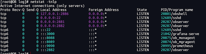

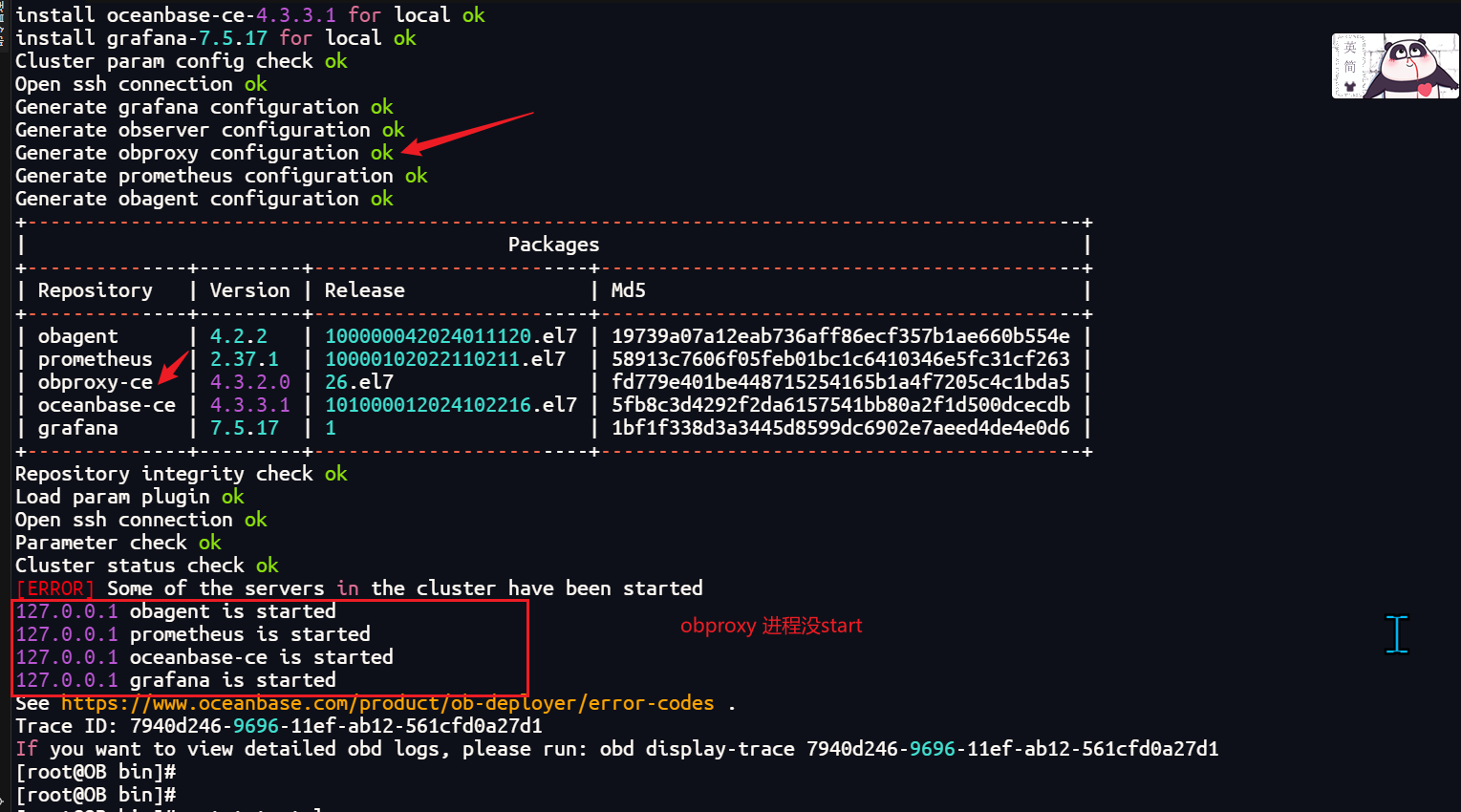

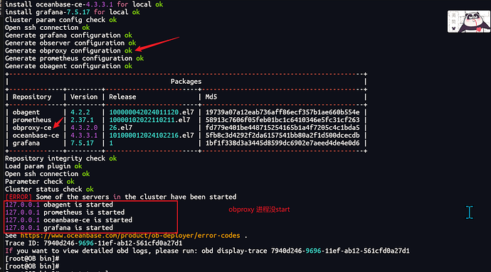

ob4.3社区版执行obd demo 后obproxy进程没起来
【 使用环境 】 测试环境
【 OB or 其他组件 】obproxy
【 使用版本 】社区版ob4.3
【问题描述】ob4.3社区版执行obd demo 后obproxy进程没起来
已经尝试:
重新下载ob4.3 all-in-one 的压缩包, 重新安装,还是无法解决;

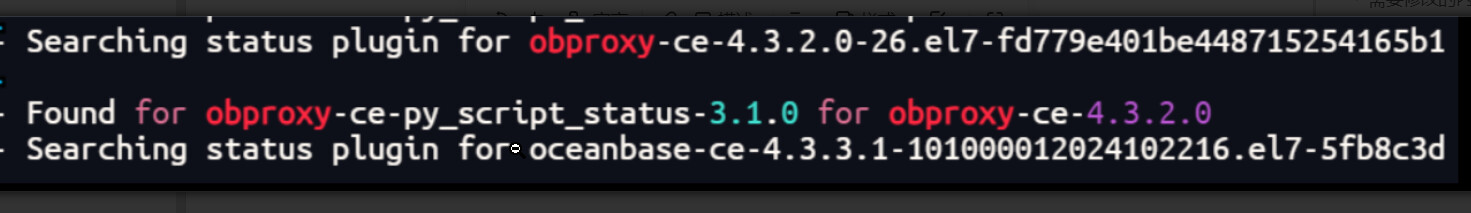

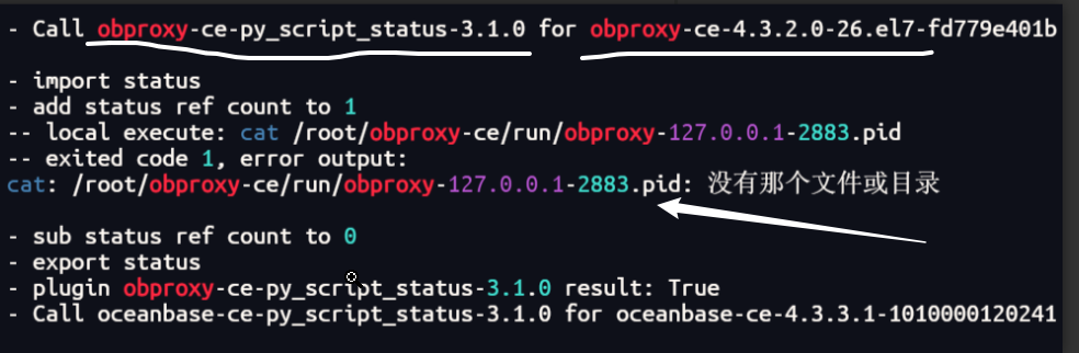

> Call obproxy-ce-py_script_status-3.1.0 for obproxy-ce-4.3.2.0-26.el7-fd779e401be448715254165b1a4f7205c4c1bda5
> [2024-10-30 16:13:06.807] [7940d246-9696-11ef-ab12-561cfd0a27d1] [DEBUG] - import status
> [2024-10-30 16:13:06.809] [7940d246-9696-11ef-ab12-561cfd0a27d1] [DEBUG] - add status ref count to 1
> [2024-10-30 16:13:06.809] [7940d246-9696-11ef-ab12-561cfd0a27d1] [DEBUG] -- local execute: cat /root/obproxy-ce/run/obproxy-127.0.0.1-2883.pid
> [2024-10-30 16:13:06.819] [7940d246-9696-11ef-ab12-561cfd0a27d1] [DEBUG] -- exited code 1, error output:
> [2024-10-30 16:13:06.820] [7940d246-9696-11ef-ab12-561cfd0a27d1] [DEBUG] cat: /root/obproxy-ce/run/obproxy-127.0.0.1-2883.pid: 没有那个文件或目录
> [2024-10-30 16:13:06.821] [7940d246-9696-11ef-ab12-561cfd0a27d1] [DEBUG] - sub status ref count to 0
> [2024-10-30 16:13:06.821] [7940d246-9696-11ef-ab12-561cfd0a27d1] [DEBUG] - export status
> [2024-10-30 16:13:06.821] [7940d246-9696-11ef-ab12-561cfd0a27d1] [DEBUG] - plugin obproxy-ce-py_script_status-3.1.0 result: True
> [2024-10-30 16:13:06.821] [7940d246-9696-11ef-ab12-561cfd0a27d1] [DEBUG] - Call oceanbase-ce-py_script_status-3.1.0 for oceanbase-ce-4.3.3.1-101000012024102216.el7-5fb8c3d4292f2da6157541bb80a2f1d500dcecdb

发一份详细obd日志看一下
[2024-10-30 16:13:06.112] [7940d246-9696-11ef-ab12-561cfd0a27d1] [DEBUG] - Search install plugin for obproxy-ce
[2024-10-30 16:13:06.113] [7940d246-9696-11ef-ab12-561cfd0a27d1] [DEBUG] - Found for obproxy-ce-install-4.2.1 for obproxy-ce-4.3.2.0
[2024-10-30 16:13:06.113] [7940d246-9696-11ef-ab12-561cfd0a27d1] [DEBUG] - Search install plugin for oceanbase-ce
[2024-10-30 16:13:06.114] [7940d246-9696-11ef-ab12-561cfd0a27d1] [DEBUG] - Found for oceanbase-ce-install-4.0.0.0 for oceanbase-ce-4.3.3.1
[2024-10-30 16:13:06.114] [7940d246-9696-11ef-ab12-561cfd0a27d1] [DEBUG] - Search install plugin for grafana
[2024-10-30 16:13:06.114] [7940d246-9696-11ef-ab12-561cfd0a27d1] [DEBUG] - Found for grafana-install-7.5.17 for grafana-7.5.17
[2024-10-30 16:13:06.114] [7940d246-9696-11ef-ab12-561cfd0a27d1] [DEBUG] - create instance repository for obagent-4.2.2
[2024-10-30 16:13:06.116] [7940d246-9696-11ef-ab12-561cfd0a27d1] [DEBUG] - obagent-4.2.2 is already install
[2024-10-30 16:13:06.116] [7940d246-9696-11ef-ab12-561cfd0a27d1] [DEBUG] - create instance repository for prometheus-2.37.1
[2024-10-30 16:13:06.116] [7940d246-9696-11ef-ab12-561cfd0a27d1] [DEBUG] - prometheus-2.37.1 is already install
[2024-10-30 16:13:06.116] [7940d246-9696-11ef-ab12-561cfd0a27d1] [DEBUG] - create instance repository for obproxy-ce-4.3.2.0
[2024-10-30 16:13:06.117] [7940d246-9696-11ef-ab12-561cfd0a27d1] [DEBUG] - obproxy-ce-4.3.2.0 is already install
[2024-10-30 16:13:06.117] [7940d246-9696-11ef-ab12-561cfd0a27d1] [DEBUG] - create instance repository for oceanbase-ce-4.3.3.1
[2024-10-30 16:13:06.119] [7940d246-9696-11ef-ab12-561cfd0a27d1] [DEBUG] - oceanbase-ce-4.3.3.1 is already install
[2024-10-30 16:13:06.119] [7940d246-9696-11ef-ab12-561cfd0a27d1] [DEBUG] - create instance repository for grafana-7.5.17
[2024-10-30 16:13:06.185] [7940d246-9696-11ef-ab12-561cfd0a27d1] [DEBUG] - grafana-7.5.17 is already install
[2024-10-30 16:13:06.186] [7940d246-9696-11ef-ab12-561cfd0a27d1] [DEBUG] - Searching install plugin for components ...
[2024-10-30 16:13:06.186] [7940d246-9696-11ef-ab12-561cfd0a27d1] [DEBUG] - Search install plugin for obagent
[2024-10-30 16:13:06.187] [7940d246-9696-11ef-ab12-561cfd0a27d1] [DEBUG] - Found for obagent-install-1.3.0 for obagent-4.2.2
[2024-10-30 16:13:06.187] [7940d246-9696-11ef-ab12-561cfd0a27d1] [DEBUG] - Search install plugin for prometheus
[2024-10-30 16:13:06.187] [7940d246-9696-11ef-ab12-561cfd0a27d1] [DEBUG] - Found for prometheus-install-2.37.1 for prometheus-2.37.1
[2024-10-30 16:13:06.187] [7940d246-9696-11ef-ab12-561cfd0a27d1] [DEBUG] - Search install plugin for obproxy-ce
[2024-10-30 16:13:06.188] [7940d246-9696-11ef-ab12-561cfd0a27d1] [DEBUG] - Found for obproxy-ce-install-4.2.1 for obproxy-ce-4.3.2.0
[2024-10-30 16:13:06.188] [7940d246-9696-11ef-ab12-561cfd0a27d1] [DEBUG] - Search install plugin for oceanbase-ce
[2024-10-30 16:13:06.189] [7940d246-9696-11ef-ab12-561cfd0a27d1] [DEBUG] - Found for oceanbase-ce-install-4.0.0.0 for oceanbase-ce-4.3.3.1
[2024-10-30 16:13:06.189] [7940d246-9696-11ef-ab12-561cfd0a27d1] [DEBUG] - Search install plugin for grafana
[2024-10-30 16:13:06.190] [7940d246-9696-11ef-ab12-561cfd0a27d1] [DEBUG] - Found for grafana-install-7.5.17 for grafana-7.5.17
[2024-10-30 16:13:06.195] [7940d246-9696-11ef-ab12-561cfd0a27d1] [INFO] +--------------------------------------------------------------------------------------------+
[2024-10-30 16:13:06.195] [7940d246-9696-11ef-ab12-561cfd0a27d1] [INFO] |                                          Packages                                          |
[2024-10-30 16:13:06.195] [7940d246-9696-11ef-ab12-561cfd0a27d1] [INFO] +--------------+---------+------------------------+------------------------------------------+
[2024-10-30 16:13:06.195] [7940d246-9696-11ef-ab12-561cfd0a27d1] [INFO] | Repository   | Version | Release                | Md5                                      |
[2024-10-30 16:13:06.195] [7940d246-9696-11ef-ab12-561cfd0a27d1] [INFO] | obagent      | 4.2.2   | 100000042024011120.el7 | 19739a07a12eab736aff86ecf357b1ae660b554e |
[2024-10-30 16:13:06.195] [7940d246-9696-11ef-ab12-561cfd0a27d1] [INFO] | prometheus   | 2.37.1  | 10000102022110211.el7  | 58913c7606f05feb01bc1c6410346e5fc31cf263 |
[2024-10-30 16:13:06.195] [7940d246-9696-11ef-ab12-561cfd0a27d1] [INFO] | obproxy-ce   | 4.3.2.0 | 26.el7                 | fd779e401be448715254165b1a4f7205c4c1bda5 |
[2024-10-30 16:13:06.196] [7940d246-9696-11ef-ab12-561cfd0a27d1] [INFO] | oceanbase-ce | 4.3.3.1 | 101000012024102216.el7 | 5fb8c3d4292f2da6157541bb80a2f1d500dcecdb |
[2024-10-30 16:13:06.196] [7940d246-9696-11ef-ab12-561cfd0a27d1] [INFO] | grafana      | 7.5.17  | 1                      | 1bf1f338d3a3445d8599dc6902e7aeed4de4e0d6 |
[2024-10-30 16:13:06.196] [7940d246-9696-11ef-ab12-561cfd0a27d1] [INFO] +--------------+---------+------------------------+------------------------------------------+
[2024-10-30 16:13:06.196] [7940d246-9696-11ef-ab12-561cfd0a27d1] [INFO] Repository integrity check
[2024-10-30 16:13:06.329] [7940d246-9696-11ef-ab12-561cfd0a27d1] [INFO] Load param plugin
[2024-10-30 16:13:06.330] [7940d246-9696-11ef-ab12-561cfd0a27d1] [DEBUG] - Searching param plugin for components ...
[2024-10-30 16:13:06.331] [7940d246-9696-11ef-ab12-561cfd0a27d1] [DEBUG] - Search param plugin for obagent
[2024-10-30 16:13:06.332] [7940d246-9696-11ef-ab12-561cfd0a27d1] [DEBUG] - Found for obagent-param-4.2.2 for obagent-4.2.2
[2024-10-30 16:13:06.332] [7940d246-9696-11ef-ab12-561cfd0a27d1] [DEBUG] - Applying obagent-param-4.2.2 for obagent-4.2.2-100000042024011120.el7-19739a07a12eab736aff86ecf357b1ae660b554e
[2024-10-30 16:13:06.332] [7940d246-9696-11ef-ab12-561cfd0a27d1] [DEBUG] - Search param plugin for prometheus
[2024-10-30 16:13:06.333] [7940d246-9696-11ef-ab12-561cfd0a27d1] [DEBUG] - Found for prometheus-param-2.37.1 for prometheus-2.37.1
[2024-10-30 16:13:06.333] [7940d246-9696-11ef-ab12-561cfd0a27d1] [DEBUG] - Applying prometheus-param-2.37.1 for prometheus-2.37.1-10000102022110211.el7-58913c7606f05feb01bc1c6410346e5fc31cf263
[2024-10-30 16:13:06.333] [7940d246-9696-11ef-ab12-561cfd0a27d1] [DEBUG] - Search param plugin for obproxy-ce
[2024-10-30 16:13:06.334] [7940d246-9696-11ef-ab12-561cfd0a27d1] [DEBUG] - Found for obproxy-ce-param-4.3.0 for obproxy-ce-4.3.2.0
[2024-10-30 16:13:06.334] [7940d246-9696-11ef-ab12-561cfd0a27d1] [DEBUG] - Applying obproxy-ce-param-4.3.0 for obproxy-ce-4.3.2.0-26.el7-fd779e401be448715254165b1a4f7205c4c1bda5
[2024-10-30 16:13:06.334] [7940d246-9696-11ef-ab12-561cfd0a27d1] [DEBUG] - Search param plugin for oceanbase-ce
[2024-10-30 16:13:06.335] [7940d246-9696-11ef-ab12-561cfd0a27d1] [DEBUG] - Found for oceanbase-ce-param-4.3.3.0 for oceanbase-ce-4.3.3.1
[2024-10-30 16:13:06.336] [7940d246-9696-11ef-ab12-561cfd0a27d1] [DEBUG] - Applying oceanbase-ce-param-4.3.3.0 for oceanbase-ce-4.3.3.1-101000012024102216.el7-5fb8c3d4292f2da6157541bb80a2f1d500dcecdb
[2024-10-30 16:13:06.336] [7940d246-9696-11ef-ab12-561cfd0a27d1] [DEBUG] - Search param plugin for grafana
[2024-10-30 16:13:06.337] [7940d246-9696-11ef-ab12-561cfd0a27d1] [DEBUG] - Found for grafana-param-7.5.17 for grafana-7.5.17
[2024-10-30 16:13:06.337] [7940d246-9696-11ef-ab12-561cfd0a27d1] [DEBUG] - Applying grafana-param-7.5.17 for grafana-7.5.17-1-1bf1f338d3a3445d8599dc6902e7aeed4de4e0d6
[2024-10-30 16:13:06.462] [7940d246-9696-11ef-ab12-561cfd0a27d1] [DEBUG] - Searching generate_config plugin for components ...
[2024-10-30 16:13:06.462] [7940d246-9696-11ef-ab12-561cfd0a27d1] [DEBUG] - Searching generate_config plugin for obagent-4.2.2-100000042024011120.el7-19739a07a12eab736aff86ecf357b1ae660b554e
[2024-10-30 16:13:06.463] [7940d246-9696-11ef-ab12-561cfd0a27d1] [DEBUG] - Found for obagent-py_script_generate_config-0.1 for obagent-4.2.2
[2024-10-30 16:13:06.463] [7940d246-9696-11ef-ab12-561cfd0a27d1] [DEBUG] - Searching generate_config plugin for prometheus-2.37.1-10000102022110211.el7-58913c7606f05feb01bc1c6410346e5fc31cf263
[2024-10-30 16:13:06.463] [7940d246-9696-11ef-ab12-561cfd0a27d1] [DEBUG] - Found for prometheus-py_script_generate_config-2.37.1 for prometheus-2.37.1
[2024-10-30 16:13:06.464] [7940d246-9696-11ef-ab12-561cfd0a27d1] [DEBUG] - Searching generate_config plugin for obproxy-ce-4.3.2.0-26.el7-fd779e401be448715254165b1a4f7205c4c1bda5
[2024-10-30 16:13:06.464] [7940d246-9696-11ef-ab12-561cfd0a27d1] [DEBUG] - Found for obproxy-ce-py_script_generate_config-4.2.3 for obproxy-ce-4.3.2.0
[2024-10-30 16:13:06.464] [7940d246-9696-11ef-ab12-561cfd0a27d1] [DEBUG] - Searching generate_config plugin for oceanbase-ce-4.3.3.1-101000012024102216.el7-5fb8c3d4292f2da6157541bb80a2f1d500dcecdb
[2024-10-30 16:13:06.465] [7940d246-9696-11ef-ab12-561cfd0a27d1] [DEBUG] - Found for oceanbase-ce-py_script_generate_config-4.3.0.0 for oceanbase-ce-4.3.3.1
[2024-10-30 16:13:06.465] [7940d246-9696-11ef-ab12-561cfd0a27d1] [DEBUG] - Searching generate_config plugin for grafana-7.5.17-1-1bf1f338d3a3445d8599dc6902e7aeed4de4e0d6
[2024-10-30 16:13:06.466] [7940d246-9696-11ef-ab12-561cfd0a27d1] [DEBUG] - Found for grafana-py_script_generate_config-7.5.17 for grafana-7.5.17
[2024-10-30 16:13:06.466] [7940d246-9696-11ef-ab12-561cfd0a27d1] [INFO] Open ssh connection
[2024-10-30 16:13:06.600] [7940d246-9696-11ef-ab12-561cfd0a27d1] [DEBUG] - Call obagent-py_script_generate_config-0.1 for obagent-4.2.2-100000042024011120.el7-19739a07a12eab736aff86ecf357b1ae660b554e
[2024-10-30 16:13:06.601] [7940d246-9696-11ef-ab12-561cfd0a27d1] [DEBUG] - plugin obagent-py_script_generate_config-0.1 result: True
[2024-10-30 16:13:06.601] [7940d246-9696-11ef-ab12-561cfd0a27d1] [DEBUG] - Call prometheus-py_script_generate_config-2.37.1 for prometheus-2.37.1-10000102022110211.el7-58913c7606f05feb01bc1c6410346e5fc31cf263
[2024-10-30 16:13:06.601] [7940d246-9696-11ef-ab12-561cfd0a27d1] [DEBUG] - plugin prometheus-py_script_generate_config-2.37.1 result: True
[2024-10-30 16:13:06.602] [7940d246-9696-11ef-ab12-561cfd0a27d1] [DEBUG] - Call obproxy-ce-py_script_generate_config-4.2.3 for obproxy-ce-4.3.2.0-26.el7-fd779e401be448715254165b1a4f7205c4c1bda5
[2024-10-30 16:13:06.602] [7940d246-9696-11ef-ab12-561cfd0a27d1] [DEBUG] - plugin obproxy-ce-py_script_generate_config-4.2.3 result: True
[2024-10-30 16:13:06.603] [7940d246-9696-11ef-ab12-561cfd0a27d1] [DEBUG] - Call oceanbase-ce-py_script_generate_config-4.3.0.0 for oceanbase-ce-4.3.3.1-101000012024102216.el7-5fb8c3d4292f2da6157541bb80a2f1d500dcecdb
[2024-10-30 16:13:06.607] [7940d246-9696-11ef-ab12-561cfd0a27d1] [DEBUG] - plugin oceanbase-ce-py_script_generate_config-4.3.0.0 result: True
[2024-10-30 16:13:06.608] [7940d246-9696-11ef-ab12-561cfd0a27d1] [DEBUG] - Call grafana-py_script_generate_config-7.5.17 for grafana-7.5.17-1-1bf1f338d3a3445d8599dc6902e7aeed4de4e0d6
[2024-10-30 16:13:06.609] [7940d246-9696-11ef-ab12-561cfd0a27d1] [DEBUG] - plugin grafana-py_script_generate_config-7.5.17 result: True
[2024-10-30 16:13:06.609] [7940d246-9696-11ef-ab12-561cfd0a27d1] [INFO] Parameter check
[2024-10-30 16:13:06.611] [7940d246-9696-11ef-ab12-561cfd0a27d1] [DEBUG] - 127.0.0.1 obagent-4.2.2-100000042024011120.el7-19739a07a12eab736aff86ecf357b1ae660b554e param check
[2024-10-30 16:13:06.611] [7940d246-9696-11ef-ab12-561cfd0a27d1] [DEBUG] - 127.0.0.1 prometheus-2.37.1-10000102022110211.el7-58913c7606f05feb01bc1c6410346e5fc31cf263 param check
[2024-10-30 16:13:06.612] [7940d246-9696-11ef-ab12-561cfd0a27d1] [DEBUG] - 127.0.0.1 obproxy-ce-4.3.2.0-26.el7-fd779e401be448715254165b1a4f7205c4c1bda5 param check
[2024-10-30 16:13:06.613] [7940d246-9696-11ef-ab12-561cfd0a27d1] [DEBUG] - 127.0.0.1 oceanbase-ce-4.3.3.1-101000012024102216.el7-5fb8c3d4292f2da6157541bb80a2f1d500dcecdb param check
[2024-10-30 16:13:06.613] [7940d246-9696-11ef-ab12-561cfd0a27d1] [DEBUG] - 127.0.0.1 grafana-7.5.17-1-1bf1f338d3a3445d8599dc6902e7aeed4de4e0d6 param check
[2024-10-30 16:13:06.743] [7940d246-9696-11ef-ab12-561cfd0a27d1] [INFO] Cluster status check
[2024-10-30 16:13:06.745] [7940d246-9696-11ef-ab12-561cfd0a27d1] [DEBUG] - Searching status plugin for components ...
[2024-10-30 16:13:06.745] [7940d246-9696-11ef-ab12-561cfd0a27d1] [DEBUG] - Searching status plugin for obagent-4.2.2-100000042024011120.el7-19739a07a12eab736aff86ecf357b1ae660b554e
[2024-10-30 16:13:06.747] [7940d246-9696-11ef-ab12-561cfd0a27d1] [DEBUG] - Found for obagent-py_script_status-1.3.0 for obagent-4.2.2
[2024-10-30 16:13:06.747] [7940d246-9696-11ef-ab12-561cfd0a27d1] [DEBUG] - Searching status plugin for prometheus-2.37.1-10000102022110211.el7-58913c7606f05feb01bc1c6410346e5fc31cf263
[2024-10-30 16:13:06.747] [7940d246-9696-11ef-ab12-561cfd0a27d1] [DEBUG] - Found for prometheus-py_script_status-2.37.1 for prometheus-2.37.1
[2024-10-30 16:13:06.748] [7940d246-9696-11ef-ab12-561cfd0a27d1] [DEBUG] - Searching status plugin for obproxy-ce-4.3.2.0-26.el7-fd779e401be448715254165b1a4f7205c4c1bda5
[2024-10-30 16:13:06.748] [7940d246-9696-11ef-ab12-561cfd0a27d1] [DEBUG] - Found for obproxy-ce-py_script_status-3.1.0 for obproxy-ce-4.3.2.0
[2024-10-30 16:13:06.749] [7940d246-9696-11ef-ab12-561cfd0a27d1] [DEBUG] - Searching status plugin for oceanbase-ce-4.3.3.1-101000012024102216.el7-5fb8c3d4292f2da6157541bb80a2f1d500dcecdb
[2024-10-30 16:13:06.749] [7940d246-9696-11ef-ab12-561cfd0a27d1] [DEBUG] - Found for oceanbase-ce-py_script_status-3.1.0 for oceanbase-ce-4.3.3.1
[2024-10-30 16:13:06.750] [7940d246-9696-11ef-ab12-561cfd0a27d1] [DEBUG] - Searching status plugin for grafana-7.5.17-1-1bf1f338d3a3445d8599dc6902e7aeed4de4e0d6
[2024-10-30 16:13:06.750] [7940d246-9696-11ef-ab12-561cfd0a27d1] [DEBUG] - Found for grafana-py_script_status-7.5.17 for grafana-7.5.17
[2024-10-30 16:13:06.750] [7940d246-9696-11ef-ab12-561cfd0a27d1] [DEBUG] - Call obagent-py_script_status-1.3.0 for obagent-4.2.2-100000042024011120.el7-19739a07a12eab736aff86ecf357b1ae660b554e
[2024-10-30 16:13:06.751] [7940d246-9696-11ef-ab12-561cfd0a27d1] [DEBUG] - import status
[2024-10-30 16:13:06.752] [7940d246-9696-11ef-ab12-561cfd0a27d1] [DEBUG] - add status ref count to 1
[2024-10-30 16:13:06.753] [7940d246-9696-11ef-ab12-561cfd0a27d1] [DEBUG] -- local execute: cat /root/obagent/run/ob_agentd.pid
[2024-10-30 16:13:06.763] [7940d246-9696-11ef-ab12-561cfd0a27d1] [DEBUG] -- exited code 0
[2024-10-30 16:13:06.764] [7940d246-9696-11ef-ab12-561cfd0a27d1] [DEBUG] -- local execute: ls /proc/20868
[2024-10-30 16:13:06.774] [7940d246-9696-11ef-ab12-561cfd0a27d1] [DEBUG] -- exited code 0
[2024-10-30 16:13:06.775] [7940d246-9696-11ef-ab12-561cfd0a27d1] [DEBUG] - sub status ref count to 0
[2024-10-30 16:13:06.775] [7940d246-9696-11ef-ab12-561cfd0a27d1] [DEBUG] - export status
[2024-10-30 16:13:06.775] [7940d246-9696-11ef-ab12-561cfd0a27d1] [DEBUG] - plugin obagent-py_script_status-1.3.0 result: True
[2024-10-30 16:13:06.776] [7940d246-9696-11ef-ab12-561cfd0a27d1] [DEBUG] - Call prometheus-py_script_status-2.37.1 for prometheus-2.37.1-10000102022110211.el7-58913c7606f05feb01bc1c6410346e5fc31cf263
[2024-10-30 16:13:06.776] [7940d246-9696-11ef-ab12-561cfd0a27d1] [DEBUG] - import status
[2024-10-30 16:13:06.777] [7940d246-9696-11ef-ab12-561cfd0a27d1] [DEBUG] - add status ref count to 1
[2024-10-30 16:13:06.778] [7940d246-9696-11ef-ab12-561cfd0a27d1] [DEBUG] -- local execute: cat /root/prometheus/run/prometheus.pid
[2024-10-30 16:13:06.793] [7940d246-9696-11ef-ab12-561cfd0a27d1] [DEBUG] -- exited code 0
[2024-10-30 16:13:06.794] [7940d246-9696-11ef-ab12-561cfd0a27d1] [DEBUG] -- local execute: ls /proc/20995
[2024-10-30 16:13:06.807] [7940d246-9696-11ef-ab12-561cfd0a27d1] [DEBUG] - Call obproxy-ce-py_script_status-3.1.0 for obproxy-ce-4.3.2.0-26.el7-fd779e401be448715254165b1a4f7205c4c1bda5
[2024-10-30 16:13:06.822] [7940d246-9696-11ef-ab12-561cfd0a27d1] [DEBUG] - import status
[2024-10-30 16:13:06.823] [7940d246-9696-11ef-ab12-561cfd0a27d1] [DEBUG] - add status ref count to 1
[2024-10-30 16:13:06.824] [7940d246-9696-11ef-ab12-561cfd0a27d1] [DEBUG] -- local execute: cat /root/oceanbase-ce/run/observer.pid
[2024-10-30 16:13:06.834] [7940d246-9696-11ef-ab12-561cfd0a27d1] [DEBUG] -- exited code 0
[2024-10-30 16:13:06.835] [7940d246-9696-11ef-ab12-561cfd0a27d1] [DEBUG] -- local execute: ls /proc/20287
[2024-10-30 16:13:06.845] [7940d246-9696-11ef-ab12-561cfd0a27d1] [DEBUG] -- exited code 0
[2024-10-30 16:13:06.846] [7940d246-9696-11ef-ab12-561cfd0a27d1] [DEBUG] - sub status ref count to 0
[2024-10-30 16:13:06.846] [7940d246-9696-11ef-ab12-561cfd0a27d1] [DEBUG] - export status
[2024-10-30 16:13:06.847] [7940d246-9696-11ef-ab12-561cfd0a27d1] [DEBUG] - plugin oceanbase-ce-py_script_status-3.1.0 result: True
[2024-10-30 16:13:06.847] [7940d246-9696-11ef-ab12-561cfd0a27d1] [DEBUG] - Call grafana-py_script_status-7.5.17 for grafana-7.5.17-1-1bf1f338d3a3445d8599dc6902e7aeed4de4e0d6
[2024-10-30 16:13:06.847] [7940d246-9696-11ef-ab12-561cfd0a27d1] [DEBUG] - import status
[2024-10-30 16:13:06.849] [7940d246-9696-11ef-ab12-561cfd0a27d1] [DEBUG] - add status ref count to 1
[2024-10-30 16:13:06.849] [7940d246-9696-11ef-ab12-561cfd0a27d1] [DEBUG] -- local execute: cat /root/grafana/run/grafana.pid
[2024-10-30 16:13:06.861] [7940d246-9696-11ef-ab12-561cfd0a27d1] [DEBUG] -- exited code 0
[2024-10-30 16:13:06.861] [7940d246-9696-11ef-ab12-561cfd0a27d1] [DEBUG] -- local execute: ls /proc/21042
[2024-10-30 16:13:06.873] [7940d246-9696-11ef-ab12-561cfd0a27d1] [DEBUG] -- exited code 0
[2024-10-30 16:13:06.873] [7940d246-9696-11ef-ab12-561cfd0a27d1] [DEBUG] - sub status ref count to 0
[2024-10-30 16:13:06.874] [7940d246-9696-11ef-ab12-561cfd0a27d1] [DEBUG] - export status
[2024-10-30 16:13:06.874] [7940d246-9696-11ef-ab12-561cfd0a27d1] [DEBUG] - plugin grafana-py_script_status-7.5.17 result: True

ps -ef|grep obproxy看一下
[root@OB log]# ps -ef|grep obproxy
root 48062 22586 0 18:17 pts/2 00:00:00 grep --color=auto obproxy
没有2883端口

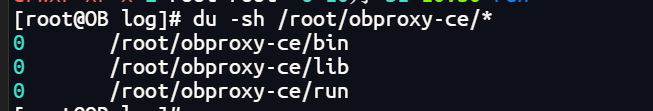

obproxy版本不对,重新部署一下obproxy
obd cluster component del obproxy-ce
obd cluster component add obproxy-ce
