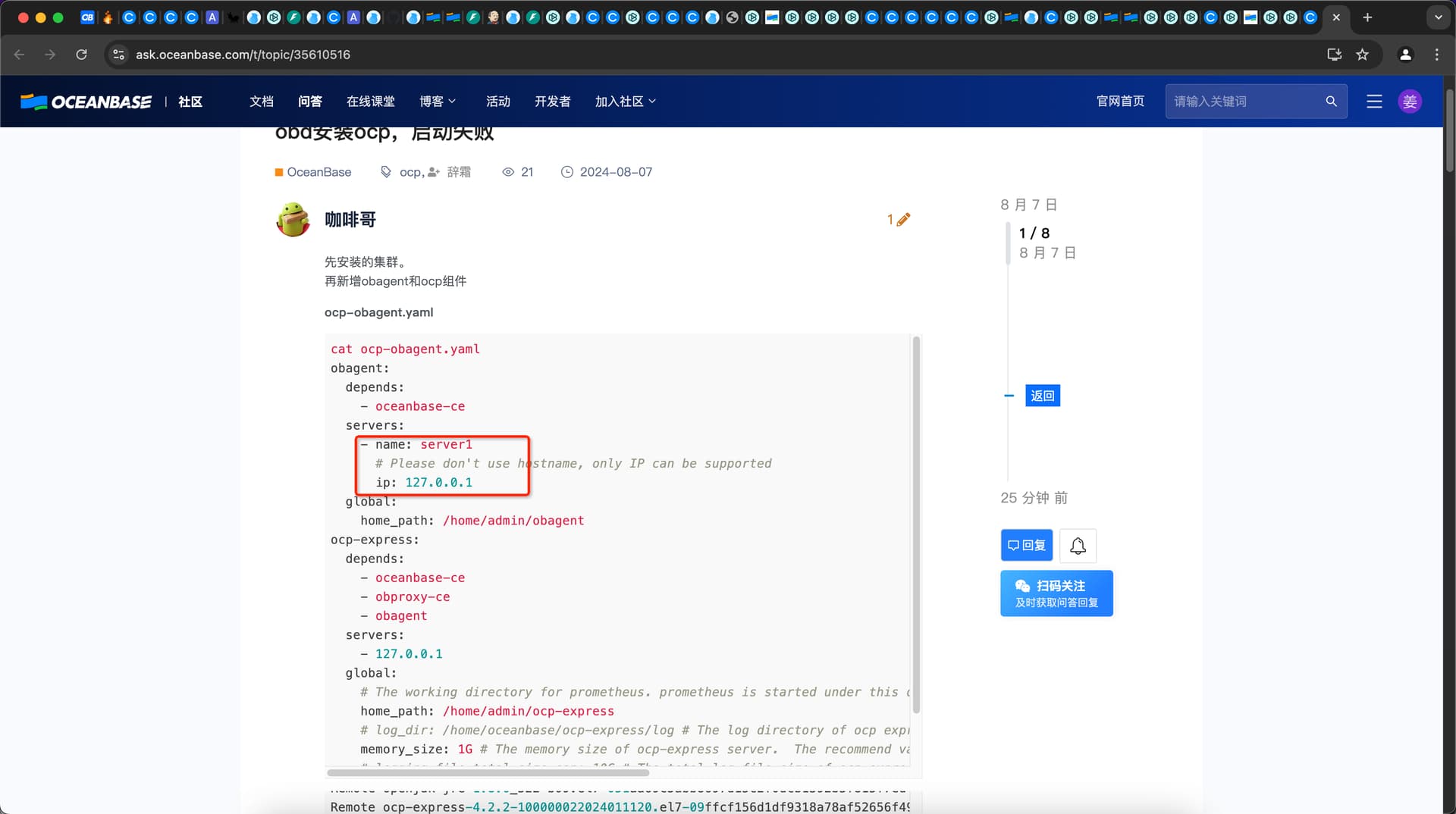

obd安装ocp,启动失败
先安装的集群。
再新增obagent和ocp组件
ocp-obagent.yaml
cat ocp-obagent.yaml
obagent:
  depends:
    - oceanbase-ce
  servers:
    - name: server1
      # Please don't use hostname, only IP can be supported
      ip: 127.0.0.1
  global:
    home_path: /home/admin/obagent
ocp-express:
  depends:
    - oceanbase-ce
    - obproxy-ce
    - obagent
  servers:
    - 127.0.0.1
  global:
    # The working directory for prometheus. prometheus is started under this directory. This is a required field.
    home_path: /home/admin/ocp-express
    # log_dir: /home/oceanbase/ocp-express/log # The log directory of ocp express server. The default value is {home_path}/log.
    memory_size: 1G # The memory size of ocp-express server.  The recommend value is 512MB * (expect node num + expect tenant num) * 60MB.
    # logging_file_total_size_cap: 10G # The total log file size of ocp-express server
    # logging_file_max_history: 1 # The maximum of retention days the log archive log files to keep. The default value is unlimited

config文件再看一下是否存在语法问题
这个配置文件前面发了。
还是说看当前正在使用的。
这里只填ip就行,不用name和ip这种格式
和ob风格保持一致
666啊,改了这果然好了。
加组件的配置文件
obagent:
  depends:
    - oceanbase-ce
  servers:
    - 127.0.0.1
  global:
ocp-express:
  depends:
    - oceanbase-ce
    - obproxy-ce
    - obagent
  servers:
    - 127.0.0.1
  global:
重新卸载安装的命令:
#  kill  obagent相关进程
ps -ef|grep obagent
kill -9 xx
# 删除相关目录
rm -rf /home/admin/obagent
rm -rf /home/admin/ocp-express
# 删除租户ocp_meta
obd cluster tenant drop obdemo -t ocp_meta
obd cluster tenant show obdemo
# 重新安装
obd cluster component add obdemo -c ocp-obagent.yaml
