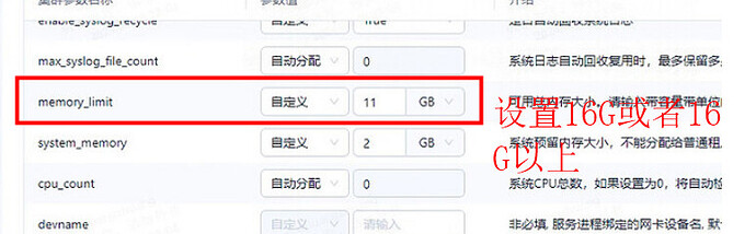

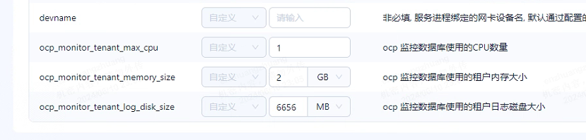

老师,我虚拟机14g的内存,装ocp可以吗?[WARN] OBD-1017: (192.168.12.10) The value of the “vm.max_map_count” must be within [327600, 1310720] (Current value: 65530, Recommended value: 655360)
[WARN] OBD-2000: (192.168.12.10) not enough memory. (Free: 4465M, Need: 11264M)
Start observer ok
observer program health check ok
Connect to observer ok
Initialize oceanbase-ce ok
Create tenant ocp_meta ok
[ERROR] OBD-5000: create resource pool ocp_meta_pool unit=‘ocp_meta_unit’, unit_num=1, zone_list=(‘zone1’) execute failed
[ERROR] create resource pool failed, you can try again by using SQL “drop resource pool ocp_meta_pool” to delete the resource pool, if you are certain that the resource pool is not being used. error info: (1235, ‘unit MEMORY_SIZE less than __min_full_resource_pool_memory not supported’)
希望王老师解答下
兄弟,这个提示有点明显啊 :joy:
当前设置的memory资源过低。可以看下机器资源是否充足,可以调整下,另外system_memory可以设置成自动分配。
