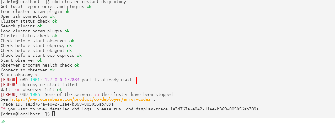

【问题描述】重启集群后2883端口被占用,导致多个组件无法启动成功,检查后未发现端口占用情况。
[admin@localhost bin]$ obd cluster start dscpcolony
Get local repositories ok
Search plugins ok
Open ssh connection ok
Load cluster param plugin ok
Cluster status check ok
Check before start observer ok
Check before start obproxy ok
Check before start obagent ok
Check before start ocp-express ok
Start observer ok
observer program health check ok
Connect to observer ok
Start obproxy x
[ERROR] OBD-1001: 127.0.0.1:2883 port is already used
[ERROR] obproxy-ce start failed
Wait for observer init ok
| observer |
| ip | version | port | zone | status |
| 127.0.0.1 | 4.2.1.1 | 2881 | zone1 | ACTIVE |
obclient -h127.0.0.1 -P2881 -uroot -p’xxxxx’ -Doceanbase -A
See OceanBase分布式数据库-海量数据 笔笔算数 .
Trace ID: 94a82a66-e03e-11ee-af4a-005056ab789a
If you want to view detailed obd logs, please run: obd display-trace 94a82a66-e03e-11ee-af4a-005056ab789a

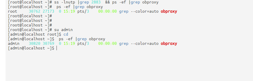

lsof -I:2883 看看呢
进程是不存在的

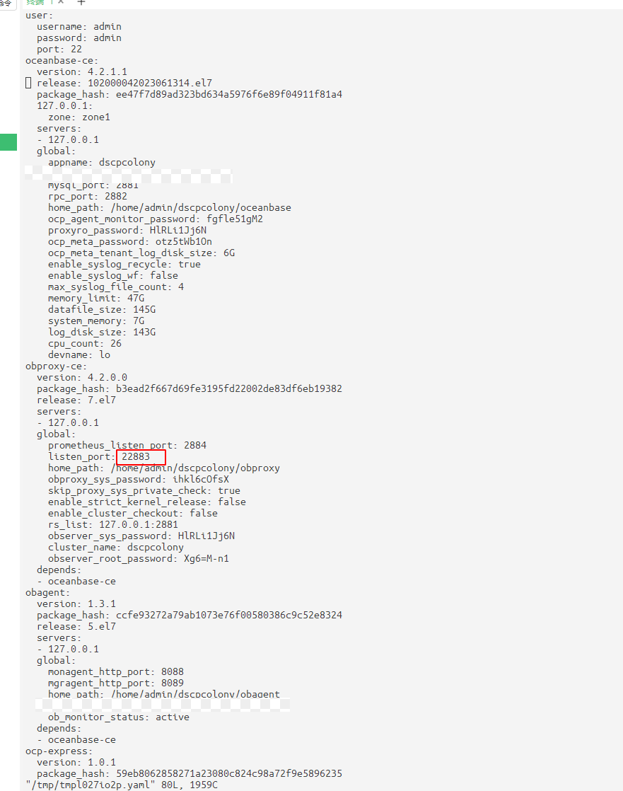

尝试修改端口,
问题依旧存在,端口没变,配置没生效?

netstat -anp|grep 2883 看下。
