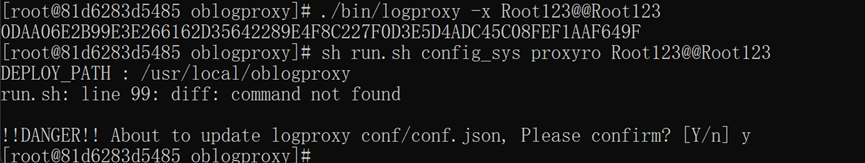

./bin/logproxy -x proxyro
/bin/logproxy -x Root123@@Root123
sh run.sh config_sys proxyro Root123@@Root123
./run.sh start

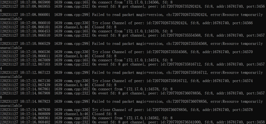

cat log/logproxy.INFO
Failed to read packet magic+version, ch:72077026735816712, error:Resource temporarily unavailable
这个是什么原因呢。
