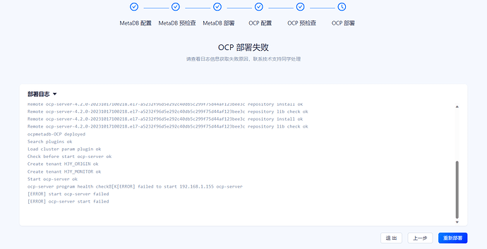

部署社区版OCP4.2.0时,卡在最后部署的阶段。
【 使用环境 】 测试环境 redhat7.7
【 使用版本 】 4.2.0
【问题描述】 部署ocp卡在最后一步,总是部署失败,日志没有详细提示!
服务器信息:32G内存 512G存储
发现由于没有安装Python环境 现尝试安装Python后重试

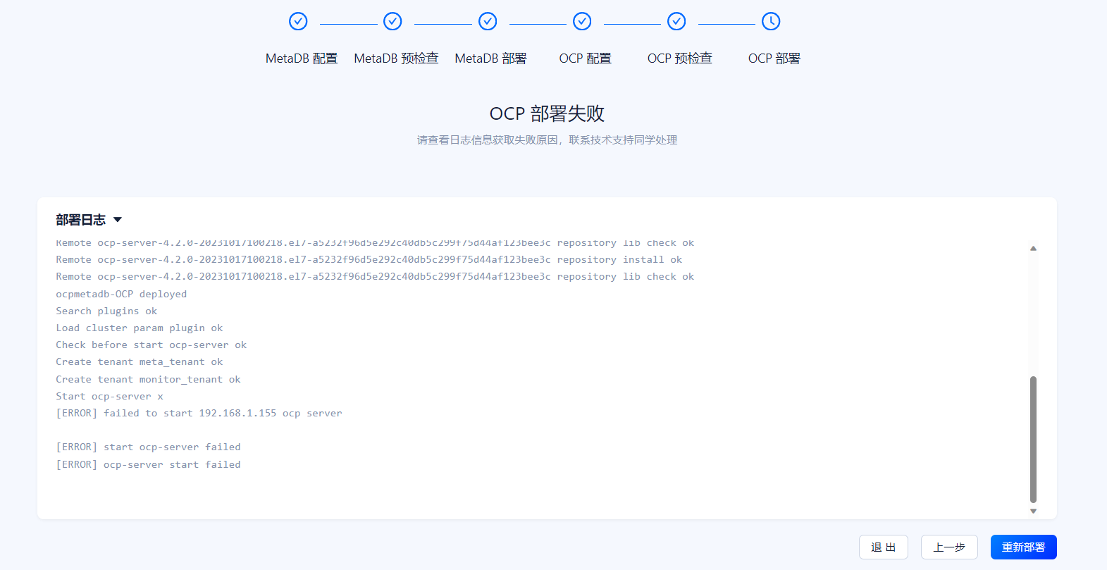

重新安装服务器相关依赖后(Python、nc) 仍然不成功

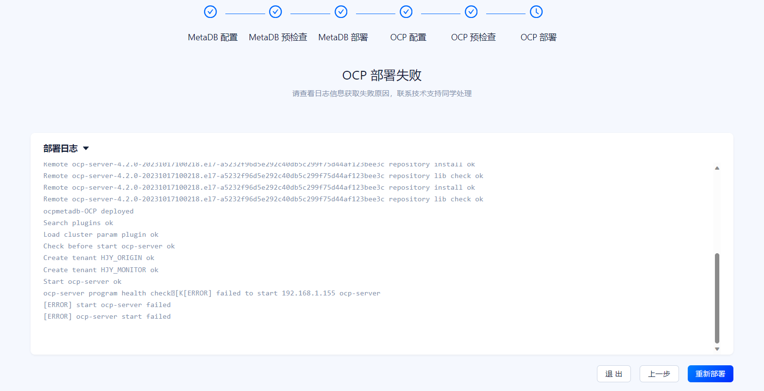

~/.ocp-installer/log/ocp 日志:
[2023-11-27 13:57:44.765] [c939d4f6-8ce6-11ee-840d-3a33b54c4dee] [DEBUG] – 192.168.1.155 program health check
[2023-11-27 13:57:44.770] [c939d4f6-8ce6-11ee-840d-3a33b54c4dee] [DEBUG] – local execute: ls /proc/4893
[2023-11-27 13:57:44.793] [c939d4f6-8ce6-11ee-840d-3a33b54c4dee] [DEBUG] – exited code 0
[2023-11-27 13:57:44.798] [c939d4f6-8ce6-11ee-840d-3a33b54c4dee] [DEBUG] – local execute: bash -c ‘cat /proc/net/{tcp*,udp*}’ | awk -F’ ’ ‘{print $2,$10}’ | grep ‘00000000:1F90’ | awk -F’ ’ ‘{print $2}’ | uniq
[2023-11-27 13:57:44.834] [c939d4f6-8ce6-11ee-840d-3a33b54c4dee] [DEBUG] – exited code 0
[2023-11-27 13:57:44.836] [c939d4f6-8ce6-11ee-840d-3a33b54c4dee] [DEBUG] – failed to start 192.168.1.155 ocp-server, remaining retries: 1
[2023-11-27 13:57:47.839] [c939d4f6-8ce6-11ee-840d-3a33b54c4dee] [DEBUG] – 192.168.1.155 program health check
[2023-11-27 13:57:47.842] [c939d4f6-8ce6-11ee-840d-3a33b54c4dee] [DEBUG] – local execute: ls /proc/4893
[2023-11-27 13:57:47.859] [c939d4f6-8ce6-11ee-840d-3a33b54c4dee] [DEBUG] – exited code 0
[2023-11-27 13:57:47.863] [c939d4f6-8ce6-11ee-840d-3a33b54c4dee] [DEBUG] – local execute: bash -c ‘cat /proc/net/{tcp*,udp*}’ | awk -F’ ’ ‘{print $2,$10}’ | grep ‘00000000:1F90’ | awk -F’ ’ ‘{print $2}’ | uniq
[2023-11-27 13:57:47.894] [c939d4f6-8ce6-11ee-840d-3a33b54c4dee] [DEBUG] – exited code 0
[2023-11-27 13:57:47.901] [c939d4f6-8ce6-11ee-840d-3a33b54c4dee] [ERROR] failed to start 192.168.1.155 ocp-server
[2023-11-27 13:57:47.902] [c939d4f6-8ce6-11ee-840d-3a33b54c4dee] [ERROR] start ocp-server failed
[2023-11-27 13:57:47.903] [c939d4f6-8ce6-11ee-840d-3a33b54c4dee] [DEBUG] - sub start ref count to 0
[2023-11-27 13:57:47.903] [c939d4f6-8ce6-11ee-840d-3a33b54c4dee] [DEBUG] - export start
[2023-11-27 13:57:47.904] [c939d4f6-8ce6-11ee-840d-3a33b54c4dee] [ERROR] ocp-server start failed
