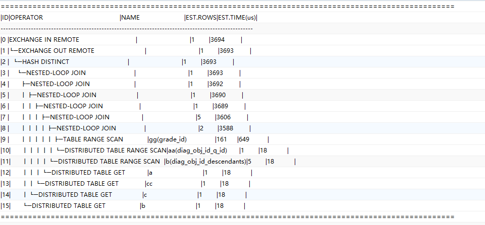

SELECT DISTINCT
	bb.diag_obj_id AS param_value,
	bb.diag_obj_name AS param_value_dispaly
FROM
	dw_actual_obj_q_stat aa
join dw_question cc ON aa.q_id = cc.q_id AND cc.diag_module IN ('教学-专项诊断')
join v_diag_ojb_diagnostician_stat bb on aa.diag_obj_id=bb.diag_obj_id_child AND bb.diag_obj_type_id_child IN ('JXBYS','JXBYB','JXBGDSY','JXBTY','JXBJS','JXBJINGSAI','JXBDXXX','JXBXYZ','JXBZZ','JXBGJTY','JXBRWYSH','JXBJJ') and bb.diag_obj_type_id in ('XK')
join v_rpt_diag_obj dd on bb.diag_obj_id_child=dd.diag_obj_id and dd.rpt_diag_obj_tag in ('本部')
join v_diag_obj_grade gg on aa.diag_obj_id=gg.diag_obj_id and gg.grade_id='232100001686'
where aa.school_code = 'bnds' AND aa.school_term_id = '2321'AND aa.school_term_id = '2321'

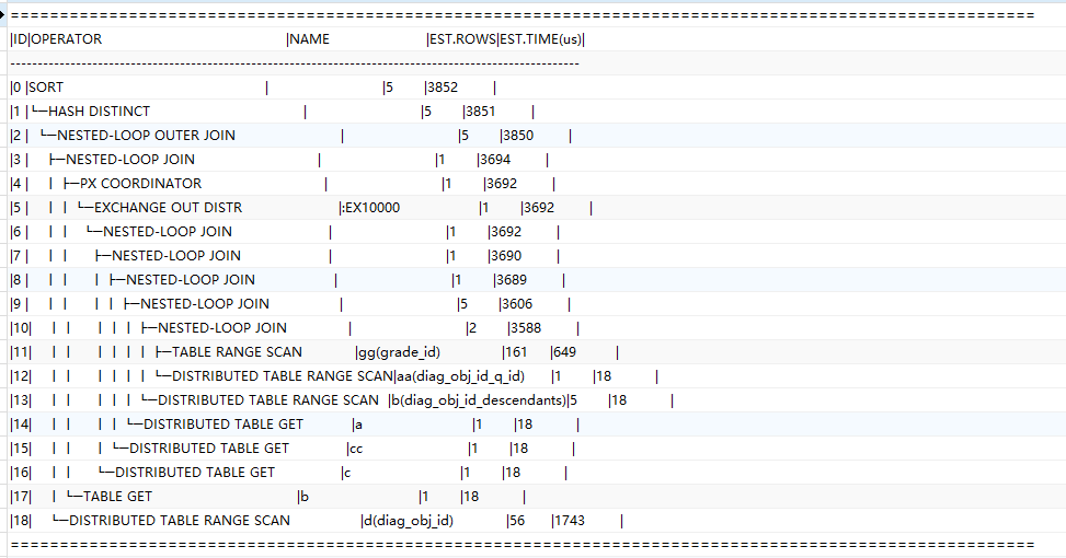

加上排序
SELECT DISTINCT
FROM
ORDER BY bb.show_seq desc

完整的explain(没有排序):
|ID|OPERATOR                                      |NAME                      |EST.ROWS|EST.TIME(us)|
|0 |EXCHANGE IN REMOTE                            |                          |1       |3694        |
|1 |└─EXCHANGE OUT REMOTE                         |                          |1       |3693        |
|2 |  └─HASH DISTINCT                             |                          |1       |3693        |
|3 |    └─NESTED-LOOP JOIN                        |                          |1       |3693        |
|4 |      ├─NESTED-LOOP JOIN                      |                          |1       |3692        |
|5 |      │ ├─NESTED-LOOP JOIN                    |                          |1       |3690        |
|6 |      │ │ ├─NESTED-LOOP JOIN                  |                          |1       |3689        |
|7 |      │ │ │ ├─NESTED-LOOP JOIN                |                          |5       |3606        |
|8 |      │ │ │ │ ├─NESTED-LOOP JOIN              |                          |2       |3588        |
|9 |      │ │ │ │ │ ├─TABLE RANGE SCAN            |gg(grade_id)              |161     |649         |
|10|      │ │ │ │ │ └─DISTRIBUTED TABLE RANGE SCAN|aa(diag_obj_id_q_id)      |1       |18          |
|11|      │ │ │ │ └─DISTRIBUTED TABLE RANGE SCAN  |b(diag_obj_id_descendants)|5       |18          |
|12|      │ │ │ └─DISTRIBUTED TABLE GET           |a                         |1       |18          |
|13|      │ │ └─DISTRIBUTED TABLE GET             |cc                        |1       |18          |
|14|      │ └─DISTRIBUTED TABLE GET               |c                         |1       |18          |
|15|      └─DISTRIBUTED TABLE GET                 |b                         |1       |18          |
Outputs & filters:
  0 - output([a.diag_obj_id], [a.diag_obj_name]), filter(nil)
  1 - output([a.diag_obj_id], [a.diag_obj_name]), filter(nil)
  2 - output([a.diag_obj_id], [a.diag_obj_name]), filter(nil), rowset=256
      distinct([a.diag_obj_id])
  3 - output([a.diag_obj_id], [a.diag_obj_name]), filter(nil), rowset=256
      conds(nil), nl_params_([aa.diag_obj_id(:6)]), use_batch=true
  4 - output([a.diag_obj_id], [a.diag_obj_name], [aa.diag_obj_id]), filter(nil), rowset=256
      conds(nil), nl_params_([aa.diag_obj_id(:4)]), use_batch=true
  5 - output([a.diag_obj_id], [a.diag_obj_name], [aa.diag_obj_id]), filter(nil), rowset=256
      conds(nil), nl_params_([aa.q_id(:0)]), use_batch=true
  6 - output([a.diag_obj_id], [a.diag_obj_name], [aa.diag_obj_id], [aa.q_id]), filter(nil), rowset=256
      conds(nil), nl_params_([b.diag_obj_id(:11)]), use_batch=true
  7 - output([aa.diag_obj_id], [aa.q_id], [b.diag_obj_id]), filter(nil), rowset=256
      conds(nil), nl_params_([aa.diag_obj_id(:2)]), use_batch=true
  8 - output([aa.diag_obj_id], [aa.q_id]), filter(nil), rowset=256
      conds(nil), nl_params_([gg.diag_obj_id(:9)]), use_batch=true
  9 - output([gg.diag_obj_id]), filter(nil), rowset=256
      access([gg.__pk_increment], [gg.diag_obj_id]), partitions(p0)
      is_index_back=true, is_global_index=false,
      range_key([gg.grade_id], [gg.__pk_increment]), range(232100001686,MIN ; 232100001686,MAX),
      range_cond([gg.grade_id = '232100001686'])
 10 - output([aa.q_id], [aa.diag_obj_id]), filter(nil), rowset=256
      access([GROUP_ID], [aa.q_id], [aa.diag_obj_id]), partitions(p0)
      is_index_back=false, is_global_index=false,
      range_key([aa.school_code], [aa.school_term_id], [aa.diag_obj_id], [aa.q_id], [aa.__pk_increment]), range(MIN ; MAX),
      range_cond([aa.school_code = 'bnds'], [cast(aa.school_term_id, DECIMAL(11, 0)) = cast('2321', DECIMAL(1, -1))], [aa.diag_obj_id = :9])
 11 - output([b.diag_obj_id]), filter(nil), rowset=256
      access([GROUP_ID], [b.diag_obj_id]), partitions(p0)
      range_key([b.diag_obj_id_descendants], [b.diag_obj_id]), range(MIN ; MAX),
      range_cond([:2 = b.diag_obj_id_descendants])
 12 - output([a.diag_obj_id], [a.diag_obj_name]), filter([a.diag_obj_type_id = 'XK']), rowset=256
      access([GROUP_ID], [a.diag_obj_id], [a.diag_obj_name], [a.diag_obj_type_id]), partitions(p0)
      is_index_back=false, is_global_index=false, filter_before_indexback[false],
      range_key([a.diag_obj_id]), range(MIN ; MAX),
      range_cond([a.diag_obj_id = :11])
 13 - output(nil), filter([cc.diag_module = '教学-专项诊断']), rowset=256
      access([GROUP_ID], [cc.diag_module]), partitions(p0)
      range_key([cc.q_id]), range(MIN ; MAX),
      range_cond([:0 = cc.q_id])
 14 - output(nil), filter([c.diag_obj_type_id IN ('JXBYS', 'JXBYB', 'JXBGDSY', 'JXBTY', 'JXBJS', 'JXBJINGSAI', 'JXBDXXX', 'JXBXYZ', 'JXBZZ', 'JXBGJTY',
      'JXBRWYSH', 'JXBJJ')]), rowset=256
      access([GROUP_ID], [c.diag_obj_type_id]), partitions(p0)
      range_key([c.diag_obj_id]), range(MIN ; MAX),
      range_cond([:4 = c.diag_obj_id])
 15 - output(nil), filter(nil), rowset=256
      access([GROUP_ID]), partitions(p0)
      range_key([b.diag_obj_id], [b.rpt_tag]), range(MIN ; MAX),
      range_cond([b.rpt_tag = '本部'], [:6 = b.diag_obj_id])
完整的explain(有排序):
|0 |SORT                                              |                          |5       |3852        |
|1 |└─HASH DISTINCT                                   |                          |5       |3851        |
|2 |  └─NESTED-LOOP OUTER JOIN                        |                          |5       |3850        |
|3 |    ├─NESTED-LOOP JOIN                            |                          |1       |3694        |
|4 |    │ ├─PX COORDINATOR                            |                          |1       |3692        |
|5 |    │ │ └─EXCHANGE OUT DISTR                      |:EX10000                  |1       |3692        |
|6 |    │ │   └─NESTED-LOOP JOIN                      |                          |1       |3692        |
|7 |    │ │     ├─NESTED-LOOP JOIN                    |                          |1       |3690        |
|8 |    │ │     │ ├─NESTED-LOOP JOIN                  |                          |1       |3689        |
|9 |    │ │     │ │ ├─NESTED-LOOP JOIN                |                          |5       |3606        |
|10|    │ │     │ │ │ ├─NESTED-LOOP JOIN              |                          |2       |3588        |
|11|    │ │     │ │ │ │ ├─TABLE RANGE SCAN            |gg(grade_id)              |161     |649         |
|12|    │ │     │ │ │ │ └─DISTRIBUTED TABLE RANGE SCAN|aa(diag_obj_id_q_id)      |1       |18          |
|13|    │ │     │ │ │ └─DISTRIBUTED TABLE RANGE SCAN  |b(diag_obj_id_descendants)|5       |18          |
|14|    │ │     │ │ └─DISTRIBUTED TABLE GET           |a                         |1       |18          |
|15|    │ │     │ └─DISTRIBUTED TABLE GET             |cc                        |1       |18          |
|16|    │ │     └─DISTRIBUTED TABLE GET               |c                         |1       |18          |
|17|    │ └─TABLE GET                                 |b                         |1       |18          |
|18|    └─DISTRIBUTED TABLE RANGE SCAN                |d(diag_obj_id)            |56      |1743        |
Outputs & filters:
  0 - output([a.diag_obj_id], [a.diag_obj_name]), filter(nil), rowset=256
      sort_keys([a.show_seq, DESC])
  1 - output([a.show_seq], [a.diag_obj_id], [a.diag_obj_name]), filter(nil), rowset=256
  2 - output([a.show_seq], [a.diag_obj_id], [a.diag_obj_name]), filter(nil), rowset=256
      conds(nil), nl_params_([c.diag_obj_id(:18)]), use_batch=false
  3 - output([a.show_seq], [a.diag_obj_id], [a.diag_obj_name], [c.diag_obj_id]), filter(nil), rowset=256
  4 - output([a.show_seq], [a.diag_obj_id], [a.diag_obj_name], [c.diag_obj_id], [aa.diag_obj_id]), filter(nil), rowset=256
  5 - output([a.show_seq], [a.diag_obj_id], [a.diag_obj_name], [c.diag_obj_id], [aa.diag_obj_id]), filter(nil), rowset=256
      is_single, dop=1
  6 - output([a.show_seq], [a.diag_obj_id], [a.diag_obj_name], [c.diag_obj_id], [aa.diag_obj_id]), filter(nil), rowset=256
  7 - output([a.show_seq], [a.diag_obj_id], [a.diag_obj_name], [aa.diag_obj_id]), filter(nil), rowset=256
  8 - output([a.show_seq], [a.diag_obj_id], [a.diag_obj_name], [aa.diag_obj_id], [aa.q_id]), filter(nil), rowset=256
  9 - output([aa.diag_obj_id], [aa.q_id], [b.diag_obj_id]), filter(nil), rowset=256
 10 - output([aa.diag_obj_id], [aa.q_id]), filter(nil), rowset=256
 11 - output([gg.diag_obj_id]), filter(nil), rowset=256
 12 - output([aa.q_id], [aa.diag_obj_id]), filter(nil), rowset=256
 13 - output([b.diag_obj_id]), filter(nil), rowset=256
 14 - output([a.diag_obj_id], [a.diag_obj_name], [a.show_seq]), filter([a.diag_obj_type_id = 'XK']), rowset=256
      access([GROUP_ID], [a.diag_obj_id], [a.diag_obj_name], [a.diag_obj_type_id], [a.show_seq]), partitions(p0)

现在看起来sort算子耗时比较多一些,方便发一下涉及到的表的schema吗?敏感信息可以隐藏一下。
不能私信吗?
从执行计划和表的结构来看,没看出来具体问题在哪,在提供一下expain extended的执行计划。可能统计信息不准导致的
无排序的expain extended:
|0 |EXCHANGE IN REMOTE                              |                          |2       |5685        |
|1 |└─EXCHANGE OUT REMOTE                           |                          |2       |5684        |
|2 |  └─HASH DISTINCT                               |                          |2       |5682        |
|3 |    └─NESTED-LOOP JOIN                          |                          |2       |5682        |

Outputs & filters:
  0 - output([a.diag_obj_id(0x7f58d2e4c0f0)], [a.diag_obj_name(0x7f58d2e56ce0)]), filter(nil)
  1 - output([a.diag_obj_id(0x7f58d2e4c0f0)], [a.diag_obj_name(0x7f58d2e56ce0)]), filter(nil)
  2 - output([a.diag_obj_id(0x7f58d2e4c0f0)], [a.diag_obj_name(0x7f58d2e56ce0)]), filter(nil), rowset=256

有排序的expain extended:
|0 |SORT                                                |                          |85      |8416        |
|1 |└─HASH DISTINCT                                     |                          |85      |8396        |
|2 |  └─NESTED-LOOP OUTER JOIN                          |                          |85      |8365        |
|3 |    ├─NESTED-LOOP JOIN                              |                          |2       |5687        |
|4 |    │ ├─PX COORDINATOR                              |                          |2       |5660        |
|5 |    │ │ └─EXCHANGE OUT DISTR                        |:EX10000                  |2       |5658        |
|6 |    │ │   └─NESTED-LOOP JOIN                        |                          |2       |5655        |
|7 |    │ │     ├─NESTED-LOOP JOIN                      |                          |2       |5628        |
|8 |    │ │     │ ├─NESTED-LOOP JOIN                    |                          |78      |4207        |
|9 |    │ │     │ │ ├─MERGE JOIN                        |                          |18      |3887        |
|10|    │ │     │ │ │ ├─TABLE RANGE SCAN                |cc(idx_m_q)               |1529    |45          |
|11|    │ │     │ │ │ └─SORT                            |                          |171     |3644        |
|12|    │ │     │ │ │   └─NESTED-LOOP JOIN              |                          |171     |3579        |
|13|    │ │     │ │ │     ├─TABLE RANGE SCAN            |gg(grade_id)              |161     |640         |
|14|    │ │     │ │ │     └─DISTRIBUTED TABLE RANGE SCAN|aa(diag_obj_id_q_id)      |1       |18          |
|15|    │ │     │ │ └─DISTRIBUTED TABLE RANGE SCAN      |b(diag_obj_id_descendants)|5       |18          |
|16|    │ │     │ └─DISTRIBUTED TABLE GET               |a                         |1       |18          |
|17|    │ │     └─DISTRIBUTED TABLE GET                 |c                         |1       |18          |
|18|    │ └─TABLE GET                                   |b                         |1       |18          |
|19|    └─DISTRIBUTED TABLE RANGE SCAN                  |d(diag_obj_id)            |56      |1743        |
Outputs & filters:
  0 - output([a.diag_obj_id(0x7f58adc4c650)], [a.diag_obj_name(0x7f58adc57240)]), filter(nil), rowset=256
      sort_keys([a.show_seq(0x7f58adc59640), DESC])
  1 - output([a.show_seq(0x7f58adc59640)], [a.diag_obj_id(0x7f58adc4c650)], [a.diag_obj_name(0x7f58adc57240)]), filter(nil), rowset=256
      distinct([a.diag_obj_id(0x7f58adc4c650)])
  2 - output([a.show_seq(0x7f58adc59640)], [a.diag_obj_id(0x7f58adc4c650)], [a.diag_obj_name(0x7f58adc57240)]), filter(nil), rowset=256
      conds(nil), nl_params_([c.diag_obj_id(0x7f58adc500e0)(:18)]), use_batch=false
  3 - output([a.show_seq(0x7f58adc59640)], [a.diag_obj_id(0x7f58adc4c650)], [a.diag_obj_name(0x7f58adc57240)], [c.diag_obj_id(0x7f58adc500e0)]), filter(nil), rowset=256
      conds(nil), nl_params_([aa.diag_obj_id(0x7f58adc73030)(:6)]), use_batch=true
  4 - output([a.show_seq(0x7f58adc59640)], [a.diag_obj_id(0x7f58adc4c650)], [a.diag_obj_name(0x7f58adc57240)], [c.diag_obj_id(0x7f58adc500e0)], [aa.diag_obj_id(0x7f58adc73030)]), filter(nil), rowset=256
  5 - output([a.show_seq(0x7f58adc59640)], [a.diag_obj_id(0x7f58adc4c650)], [a.diag_obj_name(0x7f58adc57240)], [c.diag_obj_id(0x7f58adc500e0)], [aa.diag_obj_id(0x7f58adc73030)]), filter(nil), rowset=256
      is_single, dop=1

像是走的较差的执行计划
请问d表是哪自来的,在原来的sql中并没有看到别名为d表的,只有dd表
select /*+ no_rewrite */ 加hint试下呢
是视图 v_diag_ojb_diagnostician_stat 中的表
加hint后,是否有排序都变慢了,二者时间差不多了
视图结构如下:
CREATE VIEW `v_diag_ojb_diagnostician_stat` AS SELECT
/*+ INLINE */
`a`.`diag_obj_id` AS `diag_obj_id`,
`a`.`diag_obj_name` AS `diag_obj_name`,
`a`.`diag_obj_principal_id` AS `diag_obj_principal_id`,
`a`.`diag_obj_principal_name` AS `diag_obj_principal_name`,
`a`.`diag_obj_type_id` AS `diag_obj_type_id`,
`a`.`school_code` AS `school_code`,
`a`.`school_term_id` AS `school_term_id`,
`a`.`show_seq` AS `show_seq`,
`a`.`participate_in_diag` AS `participate_in_diag_obj`,
`c`.`participate_in_diag` AS `participate_in_diag_obj_child`,
`e`.`participate_in_diag` AS `participate_in_diag`,
`e`.`diagnostician_id` AS `diagnostician_id`,
`e`.`diagnostician_name` AS `diagnostician_name`,
`e`.`diagnostician_type_id` AS `diagnostician_type_id`,
`e`.`diag_code` AS `diag_code`,
`c`.`diag_obj_id` AS `diag_obj_id_child`,
`c`.`diag_obj_name` AS `diag_obj_name_child`,
`c`.`diag_obj_principal_id` AS `diag_obj_principal_id_child`,
`c`.`diag_obj_principal_name` AS `diag_obj_principal_name_child`,
`c`.`diag_obj_type_id` AS `diag_obj_type_id_child`,
`c`.`show_seq` AS `show_seq_child`
FROM
					`edu_dw`.`dw_diag_obj` `a`
					JOIN `edu_dw`.`dw_diag_obj_closure` `b` ON ( `a`.`diag_obj_id` = `b`.`diag_obj_id` ))
				JOIN `edu_dw`.`dw_diag_obj` `c` ON ( `b`.`diag_obj_id_descendants` = `c`.`diag_obj_id` ))
		LEFT JOIN `edu_dw`.`dw_diag_obj_tician_rtl` `d` ON ( `c`.`diag_obj_id` = `d`.`diag_obj_id` ))
	LEFT JOIN `edu_dw`.`dw_diagnostician` `e` ON ( `d`.`diagnostician_id` = `e`.`diagnostician_id` ))
怀疑使用了视图的sql,排序优化策略有问题,结果集也就11条
有排序的情况下,多扫描了视图中的d表,不知道优化器怎么算的
