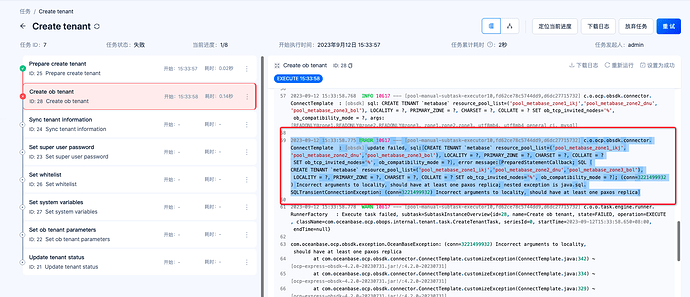

ocp-express 创建租户报错
我看sql参数里 locality 对应的都是只读副本,这样不支持,可以选全功能副本

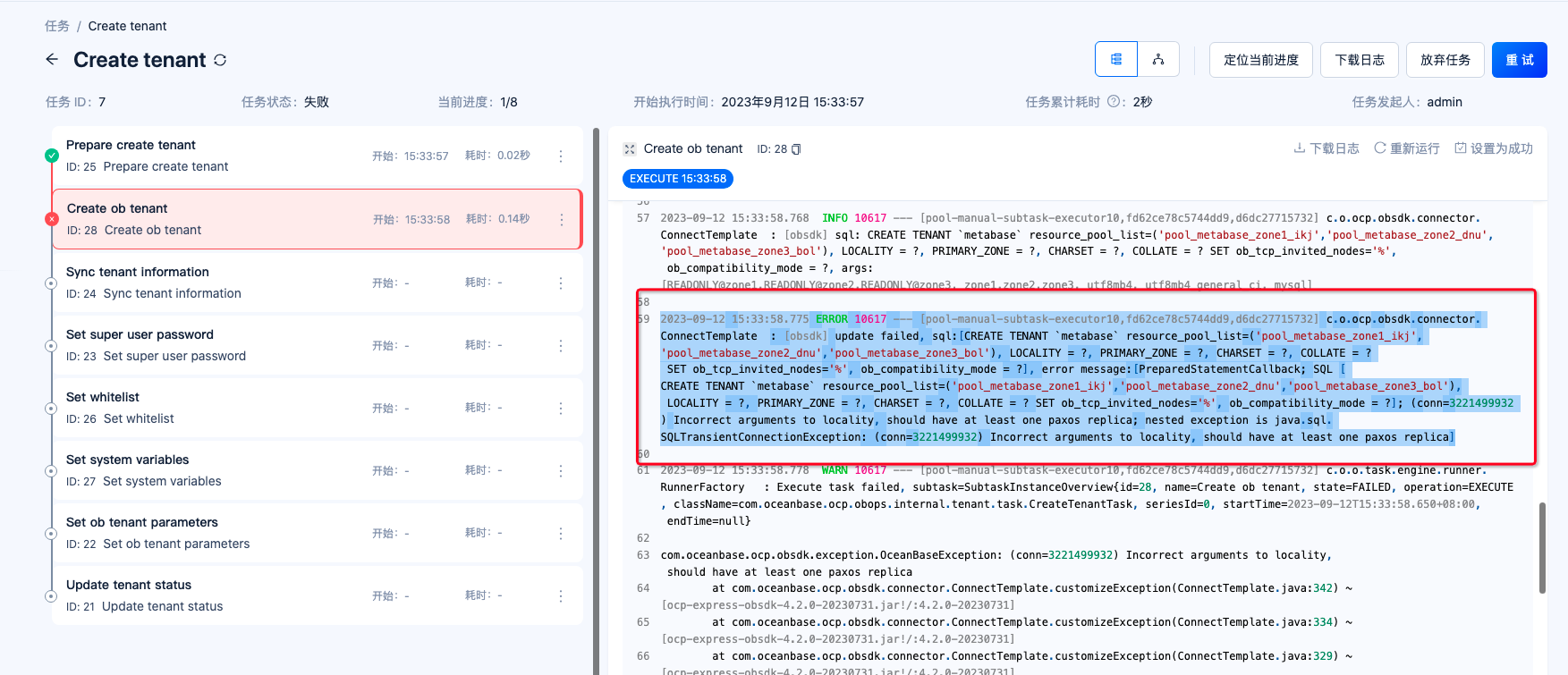

选择全功能副本后报错
023-09-13 11:13:51.967 ERROR 10617 --- [pool-manual-subtask-executor16,2fd9e456b72d4b1d,ea39b62c8f79] c.o.ocp.obsdk.connector.ObConnectors     : [obsdk] create ob connector of 'direct' mode failed, message:[obsdk] init ob connector failed, connectProperties=ConnectProperties(connectionMode=direct, address=10.32.0.103, port=2881, obsAddrList=[ObServerAddr(address=10.32.0.101, port=2881), ObServerAddr(address=10.32.0.102, port=2881), ObServerAddr(address=10.32.0.103, port=2881)], username=root, tenantName=aliyun_dts, clusterName=null, obClusterId=null, proxy=null, compatibilityMode=MYSQL, database=oceanbase), cause:java.sql.SQLSyntaxErrorException: Could not connect to 10.32.0.103:2881 : (conn=3222049115) Access denied
2023-09-13 11:13:51.969 ERROR 10617 --- [pool-manual-subtask-executor16,2fd9e456b72d4b1d,ea39b62c8f79] c.o.ocp.core.obsdk.ObAccessorFactory     : [ObAccessorFactory] create tenant accessor failed, error message:[obsdk] init ob connector failed, connectProperties=ConnectProperties(connectionMode=direct, address=10.32.0.103, port=2881, obsAddrList=[ObServerAddr(address=10.32.0.101, port=2881), ObServerAddr(address=10.32.0.102, port=2881), ObServerAddr(address=10.32.0.103, port=2881)], username=root, tenantName=aliyun_dts, clusterName=null, obClusterId=null, proxy=null, compatibilityMode=MYSQL, database=oceanbase), cause:java.sql.SQLSyntaxErrorException: Could not connect to 10.32.0.103:2881 : (conn=3222049115) Access denied
2023-09-13 11:13:51.972  WARN 10617 --- [pool-manual-subtask-executor16,2fd9e456b72d4b1d,ea39b62c8f79] c.o.o.task.engine.runner.RunnerFactory   : Execute task failed, subtask=SubtaskInstanceOverview{id=619, name=Set system variables, state=FAILED, operation=EXECUTE, className=com.oceanbase.ocp.obops.internal.tenant.task.SetSystemVariablesTask, seriesId=1, startTime=2023-09-13T11:13:51.879+08:00, endTime=null}, failedMessage=Failed to connect to the aliyun_dts tenant. Place check if the password of tenant is correctly  .
com.oceanbase.ocp.core.exception.ConnectFailedException: [OCP ConnectFailedException]: status=500 INTERNAL_SERVER_ERROR, errorCode=OB_TENANT_CONNECT_FAILED, args=aliyun_dts
服务器连接,访问,权限,先查下
是root用户的吧
报错写的是root 用户

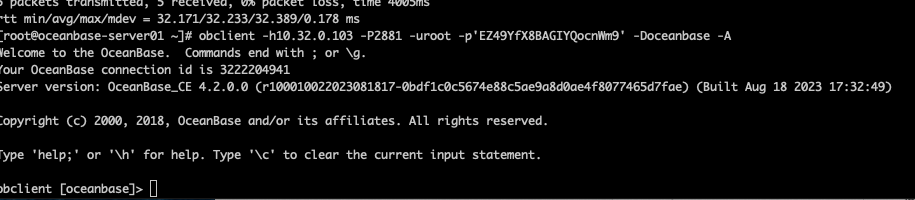

你在 ocp 所在的机器 用root 连 下 103:2881 看下
obclient -h10.32.0.103 -P2881 -uroot -p’EZ49YfX8BAGIYQocnWm9’ -Doceanbase -A
上面的截图就是 root 哦
