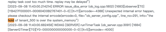

【问题现象及影响】
日志报错:
[root@08b49246b7a9 /]# obd display-trace bcde959e-4d2a-11ee-ad88-0242ac110037
[2023-09-07 11:00:44.773] [DEBUG] - cmd: [‘obhwxc’]
[2023-09-07 11:00:44.773] [DEBUG] - opts: {‘servers’: None, ‘components’: None, ‘force_delete’: None, ‘strict_check’: None, ‘without_parameter’: None}
[2023-09-07 11:00:44.774] [DEBUG] - mkdir /root/.obd/lock/
[2023-09-07 11:00:44.774] [DEBUG] - unknown lock mode
[2023-09-07 11:00:44.774] [DEBUG] - try to get share lock /root/.obd/lock/global
[2023-09-07 11:00:44.794] [DEBUG] - share lock /root/.obd/lock/global
, count 1
[2023-09-07 11:00:44.794] [DEBUG] - Get Deploy by name
[2023-09-07 11:00:44.795] [DEBUG] - mkdir /root/.obd/cluster/
[2023-09-07 11:00:44.795] [DEBUG] - mkdir /root/.obd/config_parser/
[2023-09-07 11:00:44.795] [DEBUG] - try to get exclusive lock /root/.obd/lock/deploy_obhwxc
[2023-09-07 11:00:44.795] [DEBUG] - exclusive lock /root/.obd/lock/deploy_obhwxc
, count 1
[2023-09-07 11:00:44.801] [DEBUG] - Deploy status judge
[2023-09-07 11:00:44.801] [INFO] Get local repositories
[2023-09-07 11:00:44.802] [DEBUG] - mkdir /root/.obd/repository
[2023-09-07 11:00:44.802] [DEBUG] - Get local repository oceanbase-ce-4.2.0.0-763eab84be6e4062201e04d56dde8323c4b059b5
[2023-09-07 11:00:44.802] [DEBUG] - Search repository oceanbase-ce version: 4.2.0.0, tag: 763eab84be6e4062201e04d56dde8323c4b059b5, release: None, package_hash: None
[2023-09-07 11:00:44.803] [DEBUG] - try to get share lock /root/.obd/lock/mirror_and_repo
[2023-09-07 11:00:44.803] [DEBUG] - share lock /root/.obd/lock/mirror_and_repo
, count 1
[2023-09-07 11:00:44.803] [DEBUG] - mkdir /root/.obd/repository/oceanbase-ce
[2023-09-07 11:00:44.805] [DEBUG] - Found repository oceanbase-ce-4.2.0.0-100010022023081817.el7-763eab84be6e4062201e04d56dde8323c4b059b5
[2023-09-07 11:00:44.933] [DEBUG] - Get deploy config
[2023-09-07 11:00:44.949] [INFO] Search plugins
[2023-09-07 11:00:44.949] [DEBUG] - Searching start_check plugin for components …
[2023-09-07 11:00:44.950] [DEBUG] - Searching start_check plugin for oceanbase-ce-4.2.0.0-100010022023081817.el7-763eab84be6e4062201e04d56dde8323c4b059b5
[2023-09-07 11:00:44.950] [DEBUG] - mkdir /root/.obd/plugins
[2023-09-07 11:00:44.951] [DEBUG] - Found for oceanbase-ce-py_script_start_check-4.2.0.0 for oceanbase-ce-4.2.0.0
[2023-09-07 11:00:44.951] [DEBUG] - Searching create_tenant plugin for components …
[2023-09-07 11:00:44.951] [DEBUG] - Searching create_tenant plugin for oceanbase-ce-4.2.0.0-100010022023081817.el7-763eab84be6e4062201e04d56dde8323c4b059b5
[2023-09-07 11:00:44.952] [DEBUG] - Found for oceanbase-ce-py_script_create_tenant-4.0.0.0 for oceanbase-ce-4.2.0.0
[2023-09-07 11:00:44.952] [DEBUG] - Searching start plugin for components …
[2023-09-07 11:00:44.952] [DEBUG] - Searching start plugin for oceanbase-ce-4.2.0.0-100010022023081817.el7-763eab84be6e4062201e04d56dde8323c4b059b5
[2023-09-07 11:00:44.952] [DEBUG] - Found for oceanbase-ce-py_script_start-4.0.0.0 for oceanbase-ce-4.2.0.0
[2023-09-07 11:00:44.953] [DEBUG] - Searching connect plugin for components …
[2023-09-07 11:00:44.953] [DEBUG] - Searching connect plugin for oceanbase-ce-4.2.0.0-100010022023081817.el7-763eab84be6e4062201e04d56dde8323c4b059b5
[2023-09-07 11:00:44.953] [DEBUG] - Found for oceanbase-ce-py_script_connect-3.1.0 for oceanbase-ce-4.2.0.0
[2023-09-07 11:00:44.953] [DEBUG] - Searching bootstrap plugin for components …
[2023-09-07 11:00:44.953] [DEBUG] - Searching bootstrap plugin for oceanbase-ce-4.2.0.0-100010022023081817.el7-763eab84be6e4062201e04d56dde8323c4b059b5
[2023-09-07 11:00:44.954] [DEBUG] - Found for oceanbase-ce-py_script_bootstrap-4.0.0.0 for oceanbase-ce-4.2.0.0
[2023-09-07 11:00:44.954] [DEBUG] - Searching display plugin for components …
[2023-09-07 11:00:44.954] [DEBUG] - Searching display plugin for oceanbase-ce-4.2.0.0-100010022023081817.el7-763eab84be6e4062201e04d56dde8323c4b059b5
[2023-09-07 11:00:44.955] [DEBUG] - Found for oceanbase-ce-py_script_display-3.1.0 for oceanbase-ce-4.2.0.0
[2023-09-07 11:00:45.081] [INFO] Open ssh connection
[2023-09-07 11:00:45.212] [INFO] Load cluster param plugin
[2023-09-07 11:00:45.213] [DEBUG] - Searching param plugin for components …
[2023-09-07 11:00:45.213] [DEBUG] - Search param plugin for oceanbase-ce
[2023-09-07 11:00:45.213] [DEBUG] - Found for oceanbase-ce-param-4.2.0.0 for oceanbase-ce-4.2.0.0
[2023-09-07 11:00:45.213] [DEBUG] - Applying oceanbase-ce-param-4.2.0.0 for oceanbase-ce-4.2.0.0-100010022023081817.el7-763eab84be6e4062201e04d56dde8323c4b059b5
[2023-09-07 11:00:45.964] [DEBUG] - Call oceanbase-ce-py_script_start_check-4.2.0.0 for oceanbase-ce-4.2.0.0-100010022023081817.el7-763eab84be6e4062201e04d56dde8323c4b059b5
[2023-09-07 11:00:45.964] [DEBUG] - import start_check
[2023-09-07 11:00:46.057] [DEBUG] - add start_check ref count to 1
[2023-09-07 11:00:46.057] [INFO] Check before start observer
[2023-09-07 11:00:46.059] [DEBUG] – local execute: ls /root/observer/store/clog/tenant_1/
[2023-09-07 11:00:46.062] [DEBUG] – exited code 0
[2023-09-07 11:00:46.062] [DEBUG] – local execute: cat /root/observer/run/observer.pid
[2023-09-07 11:00:46.064] [DEBUG] – exited code 1, error output:
[2023-09-07 11:00:46.065] [DEBUG] cat: /root/observer/run/observer.pid: No such file or directory
[2023-09-07 11:00:46.065] [DEBUG] – 127.0.0.1 port check
[2023-09-07 11:00:46.065] [DEBUG] – local execute: bash -c ‘cat /proc/net/{tcp*,udp*}’ | awk -F’ ’ ‘{print $2,$10}’ | grep ‘00000000:0B41’ | awk -F’ ’ ‘{print $2}’ | uniq
[2023-09-07 11:00:46.082] [DEBUG] – exited code 0
[2023-09-07 11:00:46.083] [DEBUG] – local execute: bash -c ‘cat /proc/net/{tcp*,udp*}’ | awk -F’ ’ ‘{print $2,$10}’ | grep ‘00000000:0B42’ | awk -F’ ’ ‘{print $2}’ | uniq
[2023-09-07 11:00:46.099] [DEBUG] – exited code 0
[2023-09-07 11:00:46.113] [DEBUG] – local execute: ls /root/observer/store/sstable/block_file
[2023-09-07 11:00:46.116] [DEBUG] – exited code 0
[2023-09-07 11:00:46.116] [DEBUG] – local execute: cat /proc/sys/fs/aio-max-nr /proc/sys/fs/aio-nr
[2023-09-07 11:00:46.118] [DEBUG] – exited code 0
[2023-09-07 11:00:46.118] [WARNING] OBD-1011: (127.0.0.1) The recommended value of fs.aio-max-nr is 1048576 (Current value: 65536)
[2023-09-07 11:00:46.118] [DEBUG] – local execute: ulimit -a
[2023-09-07 11:00:46.120] [DEBUG] – exited code 0
[2023-09-07 11:00:46.121] [DEBUG] – local execute: cat /proc/meminfo
[2023-09-07 11:00:46.123] [DEBUG] – exited code 0
[2023-09-07 11:00:46.124] [DEBUG] – local execute: df --block-size=1024
[2023-09-07 11:00:46.126] [DEBUG] – exited code 0
[2023-09-07 11:00:46.127] [DEBUG] – get disk info for path /, total: 938244935680 avail: 362505523200
[2023-09-07 11:00:46.127] [DEBUG] – get disk info for path /dev, total: 67108864 avail: 67108864
[2023-09-07 11:00:46.127] [DEBUG] – get disk info for path /sys/fs/cgroup, total: 136441954304 avail: 136441954304
[2023-09-07 11:00:46.127] [DEBUG] – get disk info for path /etc/hosts, total: 938244935680 avail: 362505523200
[2023-09-07 11:00:46.127] [DEBUG] – get disk info for path /dev/shm, total: 67108864 avail: 67108864
[2023-09-07 11:00:46.127] [DEBUG] – get disk info for path /proc/acpi, total: 136441954304 avail: 136441954304
[2023-09-07 11:00:46.127] [DEBUG] – get disk info for path /proc/livepatch, total: 136441954304 avail: 136441954304
[2023-09-07 11:00:46.127] [DEBUG] – get disk info for path /proc/scsi, total: 136441954304 avail: 136441954304
[2023-09-07 11:00:46.128] [DEBUG] – get disk info for path /sys/firmware, total: 136441954304 avail: 136441954304
[2023-09-07 11:00:46.128] [DEBUG] – disk: {’/’: {‘total’: 938244935680, ‘avail’: 362505523200, ‘need’: 0}, ‘/dev’: {‘total’: 67108864, ‘avail’: 67108864, ‘need’: 0}, ‘/sys/fs/cgroup’: {‘total’: 136441954304, ‘avail’: 136441954304, ‘need’: 0}, ‘/etc/hosts’: {‘total’: 938244935680, ‘avail’: 362505523200, ‘need’: 0}, ‘/dev/shm’: {‘total’: 67108864, ‘avail’: 67108864, ‘need’: 0}, ‘/proc/acpi’: {‘total’: 136441954304, ‘avail’: 136441954304, ‘need’: 0}, ‘/proc/livepatch’: {‘total’: 136441954304, ‘avail’: 136441954304, ‘need’: 0}, ‘/proc/scsi’: {‘total’: 136441954304, ‘avail’: 136441954304, ‘need’: 0}, ‘/sys/firmware’: {‘total’: 136441954304, ‘avail’: 136441954304, ‘need’: 0}}
[2023-09-07 11:00:46.128] [DEBUG] – local execute: date +%s%N
[2023-09-07 11:00:46.130] [DEBUG] – exited code 0
[2023-09-07 11:00:46.130] [DEBUG] – 127.0.0.1 time delta -0.377685546875
[2023-09-07 11:00:46.189] [INFO] [WARN] OBD-1011: (127.0.0.1) The recommended value of fs.aio-max-nr is 1048576 (Current value: 65536)
[2023-09-07 11:00:46.190] [DEBUG] - sub start_check ref count to 0
[2023-09-07 11:00:46.190] [DEBUG] - export start_check
[2023-09-07 11:00:46.190] [DEBUG] - Call oceanbase-ce-py_script_start-4.0.0.0 for oceanbase-ce-4.2.0.0-100010022023081817.el7-763eab84be6e4062201e04d56dde8323c4b059b5
[2023-09-07 11:00:46.190] [DEBUG] - import start
[2023-09-07 11:00:49.870] [DEBUG] - add start ref count to 1
[2023-09-07 11:00:49.870] [INFO] Start observer
[2023-09-07 11:00:49.871] [DEBUG] – local execute: ls /root/observer/store/clog/tenant_1/
[2023-09-07 11:00:49.874] [DEBUG] – exited code 0
[2023-09-07 11:00:49.874] [DEBUG] – local execute: cat /root/observer/run/observer.pid
[2023-09-07 11:00:49.876] [DEBUG] – exited code 1, error output:
[2023-09-07 11:00:49.877] [DEBUG] cat: /root/observer/run/observer.pid: No such file or directory
[2023-09-07 11:00:49.877] [DEBUG] – 127.0.0.1 start command construction
[2023-09-07 11:00:49.877] [DEBUG] – starting 127.0.0.1 observer
[2023-09-07 11:00:49.877] [DEBUG] – root@127.0.0.1 set env LD_LIBRARY_PATH to ‘/root/observer/lib:’
[2023-09-07 11:00:49.878] [DEBUG] – local execute: cd /root/observer; /root/observer/bin/observer -r ‘127.0.0.1:2882:2881’ -p 2881 -P 2882 -z ‘zone1’ -c 1 -d ‘/root/observer/store’ -i ‘lo’ -o __min_full_resource_pool_memory=2147483648,memory_limit=‘16G’,system_memory=‘1G’,datafile_size=‘2G’,datafile_next=‘2G’,datafile_maxsize=‘20G’,log_disk_size=‘15G’,cpu_count=16,enable_syslog_wf=False,enable_syslog_recycle=True,max_syslog_file_count=4
[2023-09-07 11:00:51.535] [DEBUG] – exited code 0
[2023-09-07 11:00:51.542] [DEBUG] – root@127.0.0.1 delete env LD_LIBRARY_PATH
[2023-09-07 11:00:51.565] [INFO] observer program health check
[2023-09-07 11:00:54.574] [DEBUG] – 127.0.0.1 program health check
[2023-09-07 11:00:54.574] [DEBUG] – local execute: cat /root/observer/run/observer.pid
[2023-09-07 11:00:54.577] [DEBUG] – exited code 0
[2023-09-07 11:00:54.577] [DEBUG] – local execute: ls /proc/98
[2023-09-07 11:00:54.580] [DEBUG] – exited code 0
[2023-09-07 11:00:54.580] [DEBUG] – 127.0.0.1 observer[pid: 98] started
[2023-09-07 11:00:54.698] [DEBUG] - sub start ref count to 0
[2023-09-07 11:00:54.699] [DEBUG] - export start
[2023-09-07 11:00:54.699] [DEBUG] - Call oceanbase-ce-py_script_connect-3.1.0 for oceanbase-ce-4.2.0.0-100010022023081817.el7-763eab84be6e4062201e04d56dde8323c4b059b5
[2023-09-07 11:00:54.699] [DEBUG] - import connect
[2023-09-07 11:00:54.733] [DEBUG] - add connect ref count to 1
[2023-09-07 11:00:54.734] [INFO] Connect to observer
[2023-09-07 11:00:54.734] [DEBUG] – connect 127.0.0.1 -P2881 -uroot -pwDuFDJI92aIGzSnpOvhl
[2023-09-07 11:00:57.737] [DEBUG] – connect 127.0.0.1 -P2881 -uroot -p
[2023-09-07 11:01:00.781] [DEBUG] – connect 127.0.0.1 -P2881 -uroot -pwDuFDJI92aIGzSnpOvhl

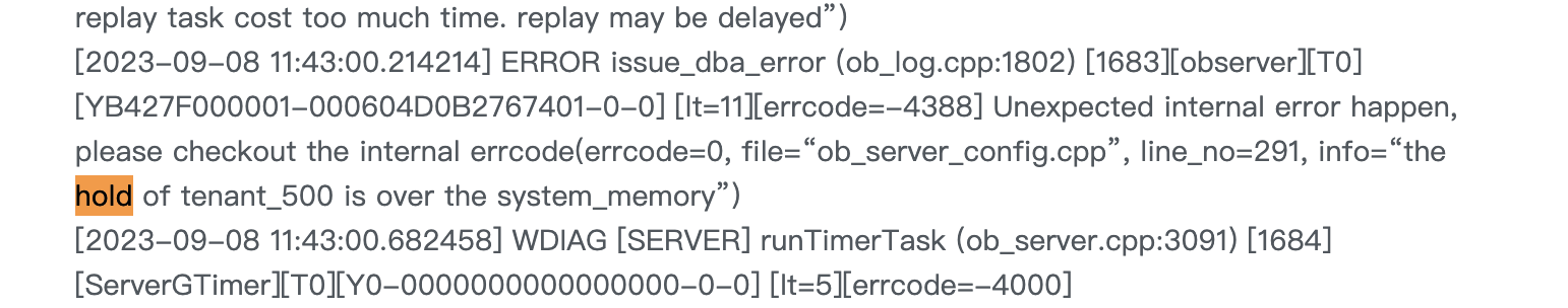

[2023-09-07 11:05:52.156] [ERROR] Traceback (most recent call last):
[2023-09-07 11:05:52.156] [ERROR] File “core.py”, line 1574, in start_cluster
[2023-09-07 11:05:52.156] [ERROR] File “core.py”, line 1666, in _start_cluster
[2023-09-07 11:05:52.156] [ERROR] File “core.py”, line 184, in call_plugin
[2023-09-07 11:05:52.156] [ERROR] File “_plugin.py”, line 324, in call
[2023-09-07 11:05:52.156] [ERROR] File “_plugin.py”, line 286, in _new_func
[2023-09-07 11:05:52.156] [ERROR] File “/root/.obd/plugins/oceanbase-ce/3.1.0/connect.py”, line 136, in connect
[2023-09-07 11:05:52.156] [ERROR] cursor = Cursor(ip=server.ip, port=server_config[‘mysql_port’], tenant=’’, password=password if password is not None else ‘’, stdio=stdio)
[2023-09-07 11:05:52.156] [ERROR] File “_stdio.py”, line 901, in wrapper
[2023-09-07 11:05:52.156] [ERROR] File “/root/.obd/plugins/oceanbase-ce/3.1.0/connect.py”, line 45, in init
[2023-09-07 11:05:52.156] [ERROR] self._connect()
[2023-09-07 11:05:52.156] [ERROR] File “/root/.obd/plugins/oceanbase-ce/3.1.0/connect.py”, line 75, in _connect
[2023-09-07 11:05:52.156] [ERROR] self.db = mysql.connect(host=self.ip, user=self.user, port=int(self.port), password=str(self.password),
[2023-09-07 11:05:52.157] [ERROR] File “/root/.oceanbase-all-in-one/obd/usr/obd/lib/site-packages/pymysql/connections.py”, line 353, in init
[2023-09-07 11:05:52.157] [ERROR] self.connect()
[2023-09-07 11:05:52.157] [ERROR] File “/root/.oceanbase-all-in-one/obd/usr/obd/lib/site-packages/pymysql/connections.py”, line 633, in connect
[2023-09-07 11:05:52.157] [ERROR] self._request_authentication()
[2023-09-07 11:05:52.157] [ERROR] File “/root/.oceanbase-all-in-one/obd/usr/obd/lib/site-packages/pymysql/connections.py”, line 907, in _request_authentication
[2023-09-07 11:05:52.157] [ERROR] auth_packet = self._read_packet()
[2023-09-07 11:05:52.157] [ERROR] File “/root/.oceanbase-all-in-one/obd/usr/obd/lib/site-packages/pymysql/connections.py”, line 725, in _read_packet
[2023-09-07 11:05:52.157] [ERROR] packet.raise_for_error()
[2023-09-07 11:05:52.157] [ERROR] File “/root/.oceanbase-all-in-one/obd/usr/obd/lib/site-packages/pymysql/protocol.py”, line 221, in raise_for_error
[2023-09-07 11:05:52.157] [ERROR] err.raise_mysql_exception(self._data)
[2023-09-07 11:05:52.157] [ERROR] File “/root/.oceanbase-all-in-one/obd/usr/obd/lib/site-packages/pymysql/err.py”, line 143, in raise_mysql_exception
[2023-09-07 11:05:52.157] [ERROR] raise errorclass(errno, errval)
[2023-09-07 11:05:52.157] [ERROR] pymysql.err.OperationalError: (5150, ‘Tenant not in this server’)
[2023-09-07 11:05:55.164] [ERROR] OBD-1006: Failed to connect to oceanbase-ce

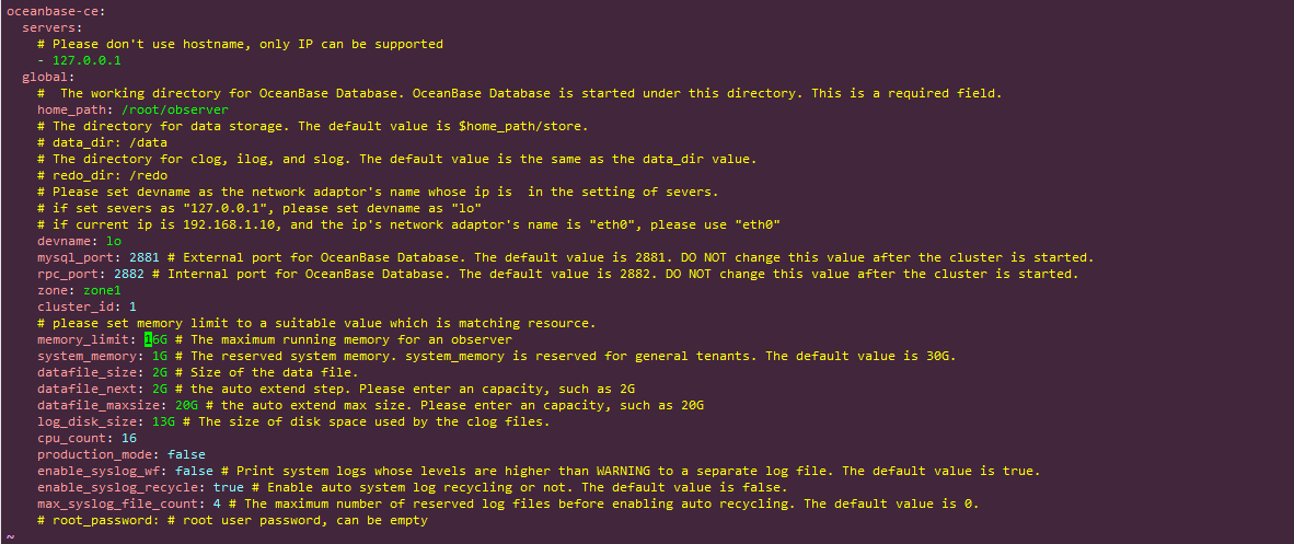

、修改配置文件
cd /root/.oceanbase-all-in-one/conf
vim mini-local-example.yaml
[root
@aa897ad8c82b
conf]# obd cluster deploy obhwxc -c mini-local-example.yaml
