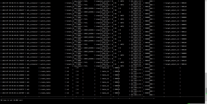

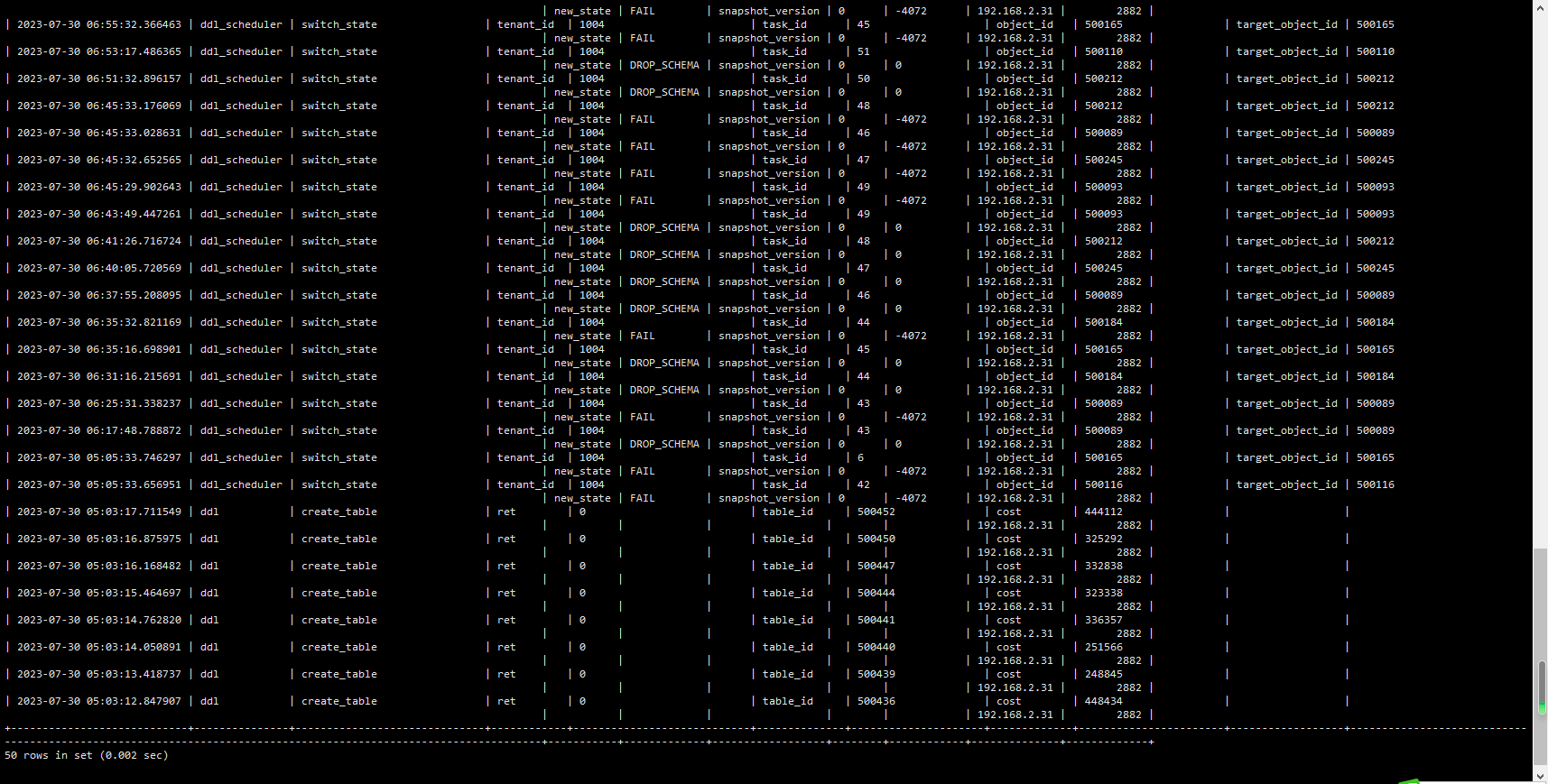

集群 sys 租户 还可以连吗?如果可以就查看集群事件日志
select * from __all_rootservice_event_History
order by gmt_create desc limit 50;

就是这个。抱歉,手机上编辑,换行失效了。
重新看看。
ERROR 4072 (HY000) : Operation canceled
OceanBase 错误码:4072
错误原因:操作被取消。
解决方式:请联系技术支持人员协助排查。
前面几次 drop 都失败了。看最后好像成功了。

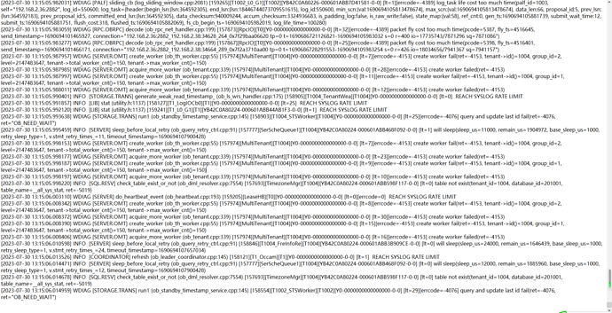

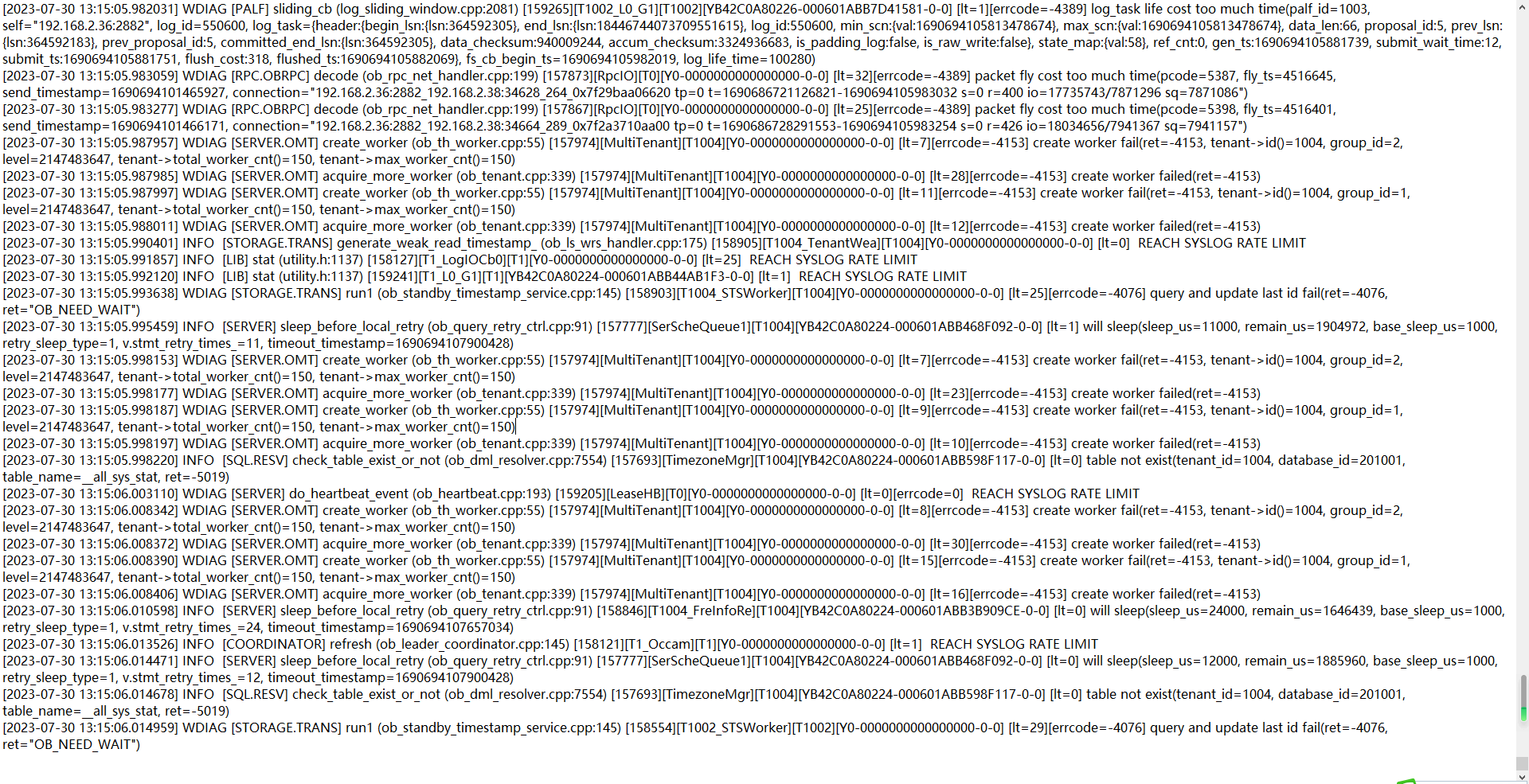

有可能clog满了。
在observer.log里找找最后的几个error日志

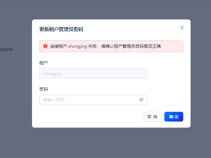

后来重新启动集群,租户就无法链接使用了

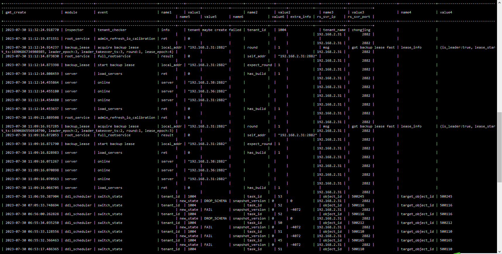

  • 集群事件
mysql> select gmt_create , module , event, name1 , value1 , name2, value2, name3, value3 , name4, value4, rs_svr_ip  from `__all_rootservice_event_history` areh  WHERE 1=1  and module in ('inspector') order by gmt_create desc limit 50;
| gmt_create                 | module    | event          | name1 | value1                     | name2     | value2 | name3       | value3    | name4 | value4 | rs_svr_ip    |
| 2023-07-30 17:33:16.689315 | inspector | tenant_checker | info  | tenant maybe create failed | tenant_id | 1004   | tenant_name | zhongjing |       |        | 192.168.2.31 |
| 2023-07-30 17:23:16.696941 | inspector | tenant_checker | info  | tenant maybe create failed | tenant_id | 1004   | tenant_name | zhongjing |       |        | 192.168.2.31 |
| 2023-07-30 17:13:16.720380 | inspector | tenant_checker | info  | tenant maybe create failed | tenant_id | 1004   | tenant_name | zhongjing |       |        | 192.168.2.31 |
| 2023-07-30 16:53:16.707005 | inspector | tenant_checker | info  | tenant maybe create failed | tenant_id | 1004   | tenant_name | zhongjing |       |        | 192.168.2.31 |
| 2023-07-30 16:43:16.695955 | inspector | tenant_checker | info  | tenant maybe create failed | tenant_id | 1004   | tenant_name | zhongjing |       |        | 192.168.2.31 |
| 2023-07-30 16:33:16.695132 | inspector | tenant_checker | info  | tenant maybe create failed | tenant_id | 1004   | tenant_name | zhongjing |       |        | 192.168.2.31 |
| 2023-07-30 16:23:16.702886 | inspector | tenant_checker | info  | tenant maybe create failed | tenant_id | 1004   | tenant_name | zhongjing |       |        | 192.168.2.31 |
| 2023-07-30 16:13:16.693379 | inspector | tenant_checker | info  | tenant maybe create failed | tenant_id | 1004   | tenant_name | zhongjing |       |        | 192.168.2.31 |
| 2023-07-30 15:53:16.695980 | inspector | tenant_checker | info  | tenant maybe create failed | tenant_id | 1004   | tenant_name | zhongjing |       |        | 192.168.2.31 |
| 2023-07-30 15:43:16.703068 | inspector | tenant_checker | info  | tenant maybe create failed | tenant_id | 1004   | tenant_name | zhongjing |       |        | 192.168.2.31 |
| 2023-07-30 15:33:16.691528 | inspector | tenant_checker | info  | tenant maybe create failed | tenant_id | 1004   | tenant_name | zhongjing |       |        | 192.168.2.31 |
| 2023-07-30 15:23:16.697069 | inspector | tenant_checker | info  | tenant maybe create failed | tenant_id | 1004   | tenant_name | zhongjing |       |        | 192.168.2.31 |
| 2023-07-30 15:13:16.703018 | inspector | tenant_checker | info  | tenant maybe create failed | tenant_id | 1004   | tenant_name | zhongjing |       |        | 192.168.2.31 |
| 2023-07-30 15:03:16.724510 | inspector | tenant_checker | info  | tenant maybe create failed | tenant_id | 1004   | tenant_name | zhongjing |       |        | 192.168.2.31 |
| 2023-07-30 14:43:16.709270 | inspector | tenant_checker | info  | tenant maybe create failed | tenant_id | 1004   | tenant_name | zhongjing |       |        | 192.168.2.31 |
| 2023-07-30 14:33:16.702649 | inspector | tenant_checker | info  | tenant maybe create failed | tenant_id | 1004   | tenant_name | zhongjing |       |        | 192.168.2.31 |
| 2023-07-30 14:23:16.702348 | inspector | tenant_checker | info  | tenant maybe create failed | tenant_id | 1004   | tenant_name | zhongjing |       |        | 192.168.2.31 |
| 2023-07-30 14:13:16.715567 | inspector | tenant_checker | info  | tenant maybe create failed | tenant_id | 1004   | tenant_name | zhongjing |       |        | 192.168.2.31 |
| 2023-07-30 14:03:16.704032 | inspector | tenant_checker | info  | tenant maybe create failed | tenant_id | 1004   | tenant_name | zhongjing |       |        | 192.168.2.31 |
| 2023-07-30 13:53:16.738872 | inspector | tenant_checker | info  | tenant maybe create failed | tenant_id | 1004   | tenant_name | zhongjing |       |        | 192.168.2.31 |
| 2023-07-30 13:43:16.703645 | inspector | tenant_checker | info  | tenant maybe create failed | tenant_id | 1004   | tenant_name | zhongjing |       |        | 192.168.2.31 |
| 2023-07-30 13:33:16.886478 | inspector | tenant_checker | info  | tenant maybe create failed | tenant_id | 1004   | tenant_name | zhongjing |       |        | 192.168.2.31 |
| 2023-07-30 13:22:24.859281 | inspector | tenant_checker | info  | tenant maybe create failed | tenant_id | 1004   | tenant_name | zhongjing |       |        | 192.168.2.31 |
| 2023-07-30 13:12:24.795293 | inspector | tenant_checker | info  | tenant maybe create failed | tenant_id | 1004   | tenant_name | zhongjing |       |        | 192.168.2.31 |
| 2023-07-30 13:02:24.802519 | inspector | tenant_checker | info  | tenant maybe create failed | tenant_id | 1004   | tenant_name | zhongjing |       |        | 192.168.2.31 |
| 2023-07-30 12:42:24.837876 | inspector | tenant_checker | info  | tenant maybe create failed | tenant_id | 1004   | tenant_name | zhongjing |       |        | 192.168.2.31 |
| 2023-07-30 12:32:24.841124 | inspector | tenant_checker | info  | tenant maybe create failed | tenant_id | 1004   | tenant_name | zhongjing |       |        | 192.168.2.31 |
| 2023-07-30 12:22:24.850756 | inspector | tenant_checker | info  | tenant maybe create failed | tenant_id | 1004   | tenant_name | zhongjing |       |        | 192.168.2.31 |
| 2023-07-30 12:12:24.821512 | inspector | tenant_checker | info  | tenant maybe create failed | tenant_id | 1004   | tenant_name | zhongjing |       |        | 192.168.2.31 |
| 2023-07-30 12:02:24.828829 | inspector | tenant_checker | info  | tenant maybe create failed | tenant_id | 1004   | tenant_name | zhongjing |       |        | 192.168.2.31 |
| 2023-07-30 11:52:24.885350 | inspector | tenant_checker | info  | tenant maybe create failed | tenant_id | 1004   | tenant_name | zhongjing |       |        | 192.168.2.31 |
| 2023-07-30 11:32:24.918770 | inspector | tenant_checker | info  | tenant maybe create failed | tenant_id | 1004   | tenant_name | zhongjing |       |        | 192.168.2.31 |
32 rows in set (0.01 sec)

  • 集群节点日志
节点 38
[ob@mysql_master_38 log]$ grep ERROR *.log*
observer.log:[2023-07-30 17:55:22.996369] WDIAG [SERVER] nonblock_get_leader (ob_inner_sql_connection.cpp:2137) [73976][][T0][Y0-0000000000000000-0-0] [lt=5][errcode=-4014] user tenant has been dropped(ret=-4014, ret="OB_INNER_STAT_ERROR", tenant_id=1)
observer.log:[2023-07-30 17:55:23.145750] INFO  [SHARE.SCHEMA] init_sys_table_name_map (ob_schema_struct.cpp:225) [73976][][T0][Y0-0000000000000000-0-0] [lt=6] set tenant space table name(key=14220930887511194059, table={database_id:201006, name_case_mode:2, table_name:"ALL_VIRTUAL_TENANT_ERROR_REAL_AGENT"}, strlen=35)
observer.log.20230730132251509:[2023-07-30 13:22:42.350161] WDIAG [SERVER] nonblock_get_leader (ob_inner_sql_connection.cpp:2137) [67917][][T0][Y0-0000000000000000-0-0] [lt=5][errcode=-4014] user tenant has been dropped(ret=-4014, ret="OB_INNER_STAT_ERROR", tenant_id=1)
observer.log.20230730132251509:[2023-07-30 13:22:42.502547] INFO  [SHARE.SCHEMA] init_sys_table_name_map (ob_schema_struct.cpp:225) [67917][][T0][Y0-0000000000000000-0-0] [lt=6] set tenant space table name(key=14220930887511194059, table={database_id:201006, name_case_mode:2, table_name:"ALL_VIRTUAL_TENANT_ERROR_REAL_AGENT"}, strlen=35)
rootservice.log:[2023-07-30 11:11:49.417542] WDIAG [RS] get_frozen_status (ob_major_freeze_helper.cpp:416) [62190][T1001_Occam][T1001][Y0-0000000000000000-0-0] [lt=12][errcode=-4121] fail to get freeze info(ret=-4121, ret="OB_RPC_SEND_ERROR", frozen_scn={val:0}, tenant_id=1001)
rootservice.log:[2023-07-30 11:11:49.417556] WDIAG [RS] get_frozen_scn (ob_major_freeze_helper.cpp:431) [62190][T1001_Occam][T1001][Y0-0000000000000000-0-0] [lt=13][errcode=-4121] fail to get frozen info(ret=-4121, ret="OB_RPC_SEND_ERROR")
rootservice.log:[2023-07-30 11:11:49.417685] WDIAG [RS] refresh_tenant_info (ob_tenant_info_loader.cpp:215) [62339][T1002_TenantInf][T1002][Y0-0000000000000000-0-0] [lt=15][errcode=-4121] failed to load tenant info(ret=-4121, ret="OB_RPC_SEND_ERROR", tenant_id=1002)
rootservice.log:[2023-07-30 11:11:49.417703] WDIAG [RS] run2 (ob_tenant_info_loader.cpp:130) [62339][T1002_TenantInf][T1002][Y0-0000000000000000-0-0] [lt=2][errcode=-4121] failed to update tenant info(ret=-4121, ret="OB_RPC_SEND_ERRO ", tenant_id=1002, sql_proxy_=0x5597c6003dc8)
rootservice.log:[2023-07-30 11:11:49.417822] WDIAG [RS] get_frozen_status (ob_major_freeze_helper.cpp:416) [62346][T1002_Occam][T1002][Y0-0000000000000000-0-0] [lt=12][errcode=-4121] fail to get freeze info(ret=-4121, ret="OB_RPC_SEND_ERROR", frozen_scn={val:0}, tenant_id=1002)
rootservice.log:[2023-07-30 11:11:49.417837] WDIAG [RS] get_frozen_scn (ob_major_freeze_helper.cpp:431) [62346][T1002_Occam][T1002][Y0-0000000000000000-0-0] [lt=15][errcode=-4121] fail to get frozen info(ret=-4121, ret="OB_RPC_SEND_ERROR")
trace.log.20230730124658196:[2023-07-30 11:09:36.066898] [62131][T1_L0_G0][T1002][YB42C0A80226-000601ABAD50FAE5-0-0] {"trace_id":"000601ab-a4c7-b6c6-fc30-ebb8034b2916","name":"sql_compile","id":"000601ab-a4c7-b6d9-7961-08fb3608177d","start_ts":1690686575851225,"end_ts":1690686575900455,"parent_id":"000601ab-a4c7-b6ca-2ed2-512fedc7df7a","is_follow":false,"tags":[{"sql_id":"98F8E1830AFEA651EFE0E2A3A969973B"},{"database_id":201001},{"plan_hash":8814062241771393325},{"hit_plan":false},{"sql_text":"select /*+ MONITOR_AGENT QUERY_TIMEOUT(100000000) */ count(*) as cnt from CDB_INDEXES where status in ('ERROR','UNUSABLE')"}]}
trace.log.20230730124658196:[2023-07-30 11:12:28.376874] [64532][T1_L0_G0][T1003][YB42C0A80226-000601ABB8320F27-0-0] {"trace_id":"000601ab-af0c-c696-998f-be86cb5c6bce","name":"sql_compile","id":"000601ab-af0c-c6b1-e28a-3205fe95ff3c","start_ts":1690686748149425,"end_ts":1690686748186642,"parent_id":"000601ab-af0c-c69e-de7c-3d19ff6c7b04","is_follow":false,"tags":[{"sql_id":"98F8E1830AFEA651EFE0E2A3A969973B"},{"database_id":201001},{"plan_hash":8814062241771393325},{"hit_plan":false},{"sql_text":"select /*+ MONITOR_AGENT QUERY_TIMEOUT(100000000) */ count(*) as cnt from CDB_INDEXES where status in ('ERROR','UNUSABLE')"}]}
节点 31
-bash-4.2$ grep ERROR *.log*
observer.log.20230730131509404:[2023-07-30 13:12:24.795219] ERROR issue_dba_error (ob_log.cpp:1792) [227269][RSInspectTask][T0][Y0-0000000000000000-0-0] [lt=1][errcode=-4388] Unexpected internal error happen, please checkout the internal errcode(errcode=0, file="ob_root_inspection.cpp", line_no=216, info="tenant maybe create failed")
observer.log.20230730174008674:[2023-07-30 13:22:46.689828] WDIAG [SERVER] nonblock_get_leader (ob_inner_sql_connection.cpp:2137) [248833][][T0][Y0-0000000000000000-0-0] [lt=5][errcode=-4014] user tenant has been dropped(ret=-4014, ret="OB_INNER_STAT_ERROR", tenant_id=1)
节点 36
