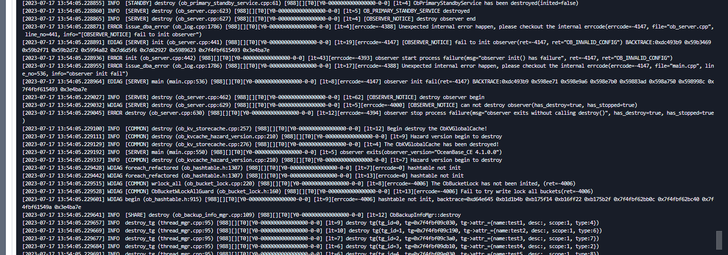

按照教程部署oceanbase,observer日志打印请求报500
caller=server/http.go:101:func1: request: from 192.168.0.232, method GET, path /api/ob/readiness, response: status code 500

这个是容器的日志吧,默认是里面 cable 进程的,看起来是一直在重启 observer,应该是某种原因 observer 进程挂了,得看下 observer 的日志,可以登录到容器里, kubectl exec -it sapp-xxx -n obcluster -c observer -- bash 然后看下 /home/admin/oceanbase/log/observer.log

[2023-07-17 13:54:05.225588] ERROR issue_dba_error (ob_log.cpp:1786) [988][][T0][Y0-0000000000000000-0-0] [lt=12][errcode=-4388] Unexpected internal error happen, please checkout the internal errcode(errcode=-4147, file=“ob_server.cpp”, line_no=1489, info=“some config setting is not valid”)
实际生效的参数应该有问题,看下部署时候的配置参数和 strings ~/observer/etc/observer.config.bin有什么不一样的,特别是内存和磁盘参数。
