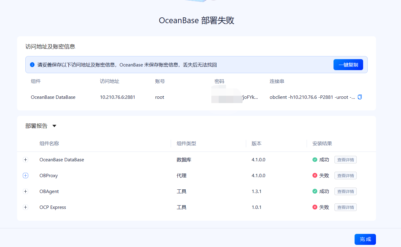

部署单个机器测试,部署失败!!!!
【 OB or 其他组件 】obd
【 使用版本 】4.1.0.0
【问题描述】提示OBProxy失败、OCP Express 失败
就最小化,自动部署,其他啥都是默认的
【问题现象及影响】
OBProxy 检测启动失败
可是我看到进程有启动啊

[2023-06-15 15:19:23.714] [DEBUG] - Call obproxy-ce-py_script_start_check-3.1.0 for obproxy-ce-4.1.0.0-7.el7-2a9d9bf67f179dcca2a8c9e7c77373d94e7e2abe
[2023-06-15 15:19:23.714] [INFO] Check before start obproxy
[2023-06-15 15:19:23.714] [DEBUG] -- root@10.210.76.6 execute: cat /root/xzcoceanbase/obproxy/run/obproxy-10.210.76.6-2883.pid
[2023-06-15 15:19:23.735] [DEBUG] -- exited code 1, error output:
[2023-06-15 15:19:23.736] [DEBUG] cat: /root/xzcoceanbase/obproxy/run/obproxy-10.210.76.6-2883.pid: No such file or directory
[2023-06-15 15:19:23.736] [DEBUG] -- 10.210.76.6 port check
[2023-06-15 15:19:23.736] [DEBUG] -- root@10.210.76.6 execute: bash -c 'cat /proc/net/{tcp*,udp*}' | awk -F' ' '{print $2,$10}' | grep '00000000:0B43' | awk -F' ' '{print $2}' | uniq
[2023-06-15 15:19:23.804] [DEBUG] -- exited code 0
[2023-06-15 15:19:23.804] [DEBUG] -- root@10.210.76.6 execute: bash -c 'cat /proc/net/{tcp*,udp*}' | awk -F' ' '{print $2,$10}' | grep '00000000:0B44' | awk -F' ' '{print $2}' | uniq
[2023-06-15 15:19:23.870] [DEBUG] -- exited code 0
[2023-06-15 15:19:23.871] [DEBUG] - Call obproxy-ce-py_script_start-3.1.0 for obproxy-ce-4.1.0.0-7.el7-2a9d9bf67f179dcca2a8c9e7c77373d94e7e2abe
[2023-06-15 15:19:23.871] [DEBUG] - import start
[2023-06-15 15:19:23.874] [DEBUG] - add start ref count to 1
[2023-06-15 15:19:23.876] [INFO] Start obproxy
[2023-06-15 15:19:23.876] [DEBUG] -- root@10.210.76.6 execute: ls /root/xzcoceanbase/obproxy/etc/obproxy_config.bin
[2023-06-15 15:19:23.930] [DEBUG] -- exited code 2, error output:
[2023-06-15 15:19:23.930] [DEBUG] ls: cannot access /root/xzcoceanbase/obproxy/etc/obproxy_config.bin: No such file or directory
[2023-06-15 15:19:23.931] [DEBUG] -- 10.210.76.6 port check
[2023-06-15 15:19:23.931] [DEBUG] -- root@10.210.76.6 execute: cat /root/xzcoceanbase/obproxy/run/obproxy-10.210.76.6-2883.pid
[2023-06-15 15:19:23.990] [DEBUG] -- exited code 1, error output:
[2023-06-15 15:19:23.990] [DEBUG] cat: /root/xzcoceanbase/obproxy/run/obproxy-10.210.76.6-2883.pid: No such file or directory
[2023-06-15 15:19:23.991] [DEBUG] -- starting 10.210.76.6 obproxy
[2023-06-15 15:19:23.991] [DEBUG] -- root@10.210.76.6 set env LD_LIBRARY_PATH to '/root/xzcoceanbase/obproxy/lib:'
[2023-06-15 15:19:23.991] [DEBUG] -- root@10.210.76.6 execute: cd /root/xzcoceanbase/obproxy; /root/xzcoceanbase/obproxy/bin/obproxy -o obproxy_sys_password='8c2b4886c4bb98c5a4eac2e86053165bcb9226b9',enable_strict_kernel_release=False,skip_proxy_sys_private_check=True,enable_cluster_checkout=False,proxy_mem_limited='500M' --listen_port 2883 --prometheus_listen_port 2884 --rs_list '10.210.76.6:2881' --cluster_name 'xzcoceanbase'
[2023-06-15 15:19:24.081] [DEBUG] -- exited code 0
[2023-06-15 15:19:24.082] [DEBUG] -- root@10.210.76.6 set env LD_LIBRARY_PATH to ''
[2023-06-15 15:19:24.082] [DEBUG] -- root@10.210.76.6 execute: ps -aux | grep -e '/root/xzcoceanbase/obproxy/bin/obproxy -o obproxy_sys_password=8c2b4886c4bb98c5a4eac2e86053165bcb9226b9,enable_strict_kernel_release=False,skip_proxy_sys_private_check=True,enable_cluster_checkout=False,proxy_mem_limited=500M --listen_port 2883 --prometheus_listen_port 2884 --rs_list 10.210.76.6:2881 --cluster_name xzcoceanbase$' | grep -v grep | awk '{print $2}' > /root/xzcoceanbase/obproxy/run/obproxy-10.210.76.6-2883.pid
[2023-06-15 15:19:24.160] [DEBUG] -- exited code 0
[2023-06-15 15:19:24.161] [INFO] obproxy program health check
[2023-06-15 15:19:43.750] [DEBUG] -- 10.210.76.6 program health check
[2023-06-15 15:19:43.750] [DEBUG] -- root@10.210.76.6 execute: cat /root/xzcoceanbase/obproxy/run/obproxy-10.210.76.6-2883.pid
[2023-06-15 15:19:43.772] [DEBUG] -- exited code 0
[2023-06-15 15:19:43.772] [DEBUG] -- root@10.210.76.6 execute: bash -c 'cat /proc/net/{tcp*,udp*}' | awk -F' ' '{print $2,$10}' | grep '00000000:0B43' | awk -F' ' '{print $2}' | uniq
[2023-06-15 15:19:43.836] [DEBUG] -- exited code 0
[2023-06-15 15:19:43.837] [DEBUG] -- failed to start 10.210.76.6 obproxy, remaining retries: 1
[2023-06-15 15:19:44.838] [DEBUG] -- 10.210.76.6 program health check
[2023-06-15 15:19:44.838] [DEBUG] -- root@10.210.76.6 execute: cat /root/xzcoceanbase/obproxy/run/obproxy-10.210.76.6-2883.pid
[2023-06-15 15:19:44.857] [DEBUG] -- exited code 0
[2023-06-15 15:19:44.858] [DEBUG] -- root@10.210.76.6 execute: bash -c 'cat /proc/net/{tcp*,udp*}' | awk -F' ' '{print $2,$10}' | grep '00000000:0B43' | awk -F' ' '{print $2}' | uniq
[2023-06-15 15:19:44.920] [DEBUG] -- exited code 0
[2023-06-15 15:19:44.921] [DEBUG] -- failed to start 10.210.76.6 obproxy, remaining retries: 0
[2023-06-15 15:19:44.921] [WARNING] failed to start 10.210.76.6 obproxy
[2023-06-15 15:19:44.921] [DEBUG] - sub start ref count to 0
[2023-06-15 15:19:44.921] [DEBUG] - export start
[2023-06-15 15:19:44.921] [ERROR] obproxy-ce start failed
OCP Express 提示启动失败

[2023-06-15 15:19:58.153] [DEBUG] -- connect 10.210.76.6 -P2883 -umeta@ocp -pthCX6pIdoR
[2023-06-15 15:19:59.155] [ERROR] 10.210.76.6: failed to connect meta db
[2023-06-15 15:19:59.155] [INFO] [ERROR] 10.210.76.6: failed to connect meta db
[2023-06-15 15:19:59.156] [INFO]
[2023-06-15 15:19:59.156] [DEBUG] - sub start ref count to 0
[2023-06-15 15:19:59.156] [DEBUG] - export start
[2023-06-15 15:19:59.156] [ERROR] ocp-express start failed
麻烦把obproxy的日志 /root/xzoceanbase/obproxy/log
obproxy_error.log 和 obproxy.log 打包提供一下。
白屏安装,安装失败,都会提供报错问题,和解决方案的,你看一下安装结果里面,“失败”后面的查看详情,应该有解决方案的。
