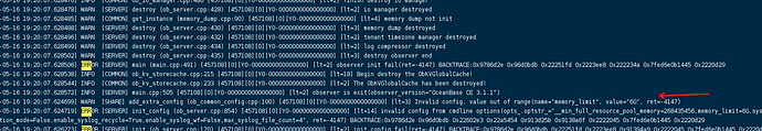

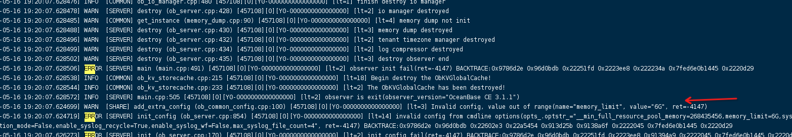

【问题描述】安装部署后启动报错
【复现路径】
【问题现象及影响】
看提示错误码2002,中间按启动的参数memory_limit=‘4G’,system_memory=‘1G’,部署的配置文件里是 memory_limit: 10G,system_memory: 2G。
报错日志如下

# The directory for data storage. The default value is $home_path/store.
# data_dir: /data
# The directory for clog, ilog, and slog. The default value is the same as the data_dir value.
# redo_dir: /redo
# Please set devname as the network adaptor’s name whose ip is in the setting of severs.
# if set severs as “127.0.0.1”, please set devname as “lo”
# if current ip is 192.168.1.10, and the ip’s network adaptor’s name is “eth0”, please use “eth0”
devname: lo
mysql_port: 2881 # External port for OceanBase Database. The default value is 2881. DO NOT change this value after the cluster is started.
rpc_port: 2882 # Internal port for OceanBase Database. The default value is 2882. DO NOT change this value after the cluster is started.
zone: zone1
cluster_id: 1
# please set memory limit to a suitable value which is matching resource.
memory_limit: 10G # The maximum running memory for an observer
system_memory: 2G # The reserved system memory. system_memory is reserved for general tenants. The default value is 30G.
datafile_size: 8G # Size of the data file.
log_disk_size: 2G # The size of disk space used by the clog files.
cpu_count: 1
production_mode: false
enable_syslog_wf: false # Print system logs whose levels are higher than WARNING to a separate log file. The default value is true.
enable_syslog_recycle: true # Enable auto system log recycling or not. The default value is false.
max_syslog_file_count: 4 # The maximum number of reserved log files before enabling auto recycling. The default value is 0.
# root_password: # root user password, can be empty
