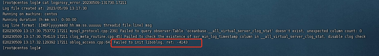

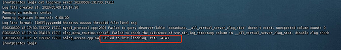

【问题描述】通过oblogproxy获取ob数据时错误日志中报: Failed to init liboblog, ret: -4143错误
【复现路径】通过oblogproxy获取ob数据时错误日志中报: Failed to init liboblog, ret: -4143错误
【问题现象及影响】
你好,这个是obcdc抛出来的,可以发一下obcdc的日志
libobcdc.log (89.4 KB)
[2023-05-09 15:15:00.609178] ERROR [TLOG] check_observer_version_valid_ (ob_log_instance.cpp:2652) [18194][][T0][Y0-0000000000000000-0-0] [lt=12] oblog_version(4.0.0.0) not compatible with observer_version(4.1.0.0), oblog_version is too old, need upgrade BACKTRACE:0x7f551dbe3a1b 0x7f551dbd5956 0x7f5515be987f 0x7f5515be9567 0x7f5515be9351 0x7f5515ca26f5 0x7f5515c8b78f 0x7f5515c83db7 0x7f5515c7dcf8 0x7f5515c7e48e 0x7f5515c7e269 0x549056 0x54ac50 0x549ad7 0x547c41 0x547ed9 0x53bbe9 0x53aff1 0x53a30a 0x53cd48 0x56644f 0x564f69 0x680369 0x680571 0x680b02 0x681212 0x564353 0x564199 0x53a7ef 0x50a64e 0x7f550dcfa555 0x5091f0
Releases · oceanbase/oblogproxy · GitHub 换下v1.1.1版本

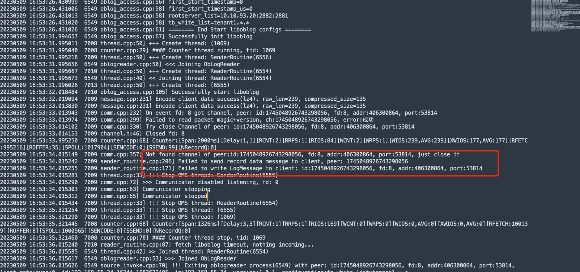

E20230509 16:53:34.015149 7009 comm.cpp:357] Not found channel of peer:id:1745048926743298056, fd:8, addr:406300864, port:53814, just close it
W20230509 16:53:34.015242 7009 sender_routine.cpp:206] Failed to send record data message to client, peer: 1745048926743298056
E20230509 16:53:34.015255 7009 sender_routine.cpp:171] Failed to write LogMessage to client: id:1745048926743298056, fd:8, addr:406300864, port:53814
请问Not found channel错误是什么引起的?
client端主动断连的报错

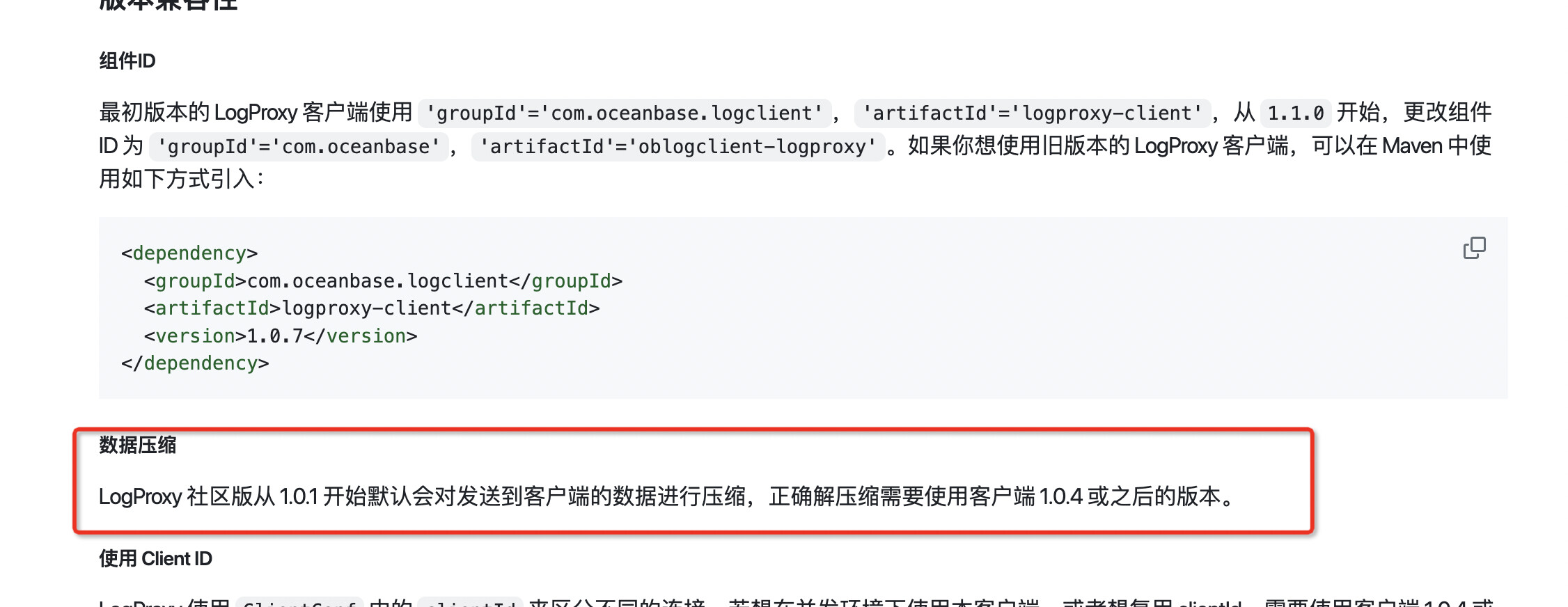

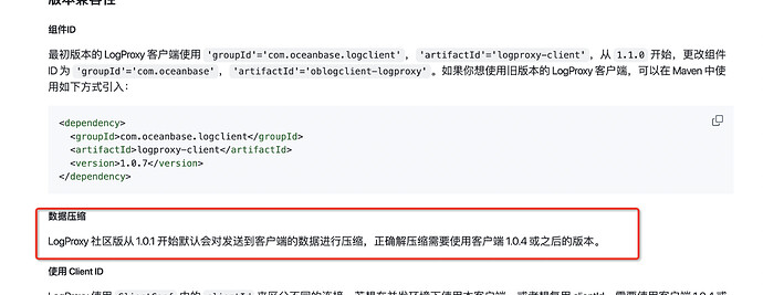

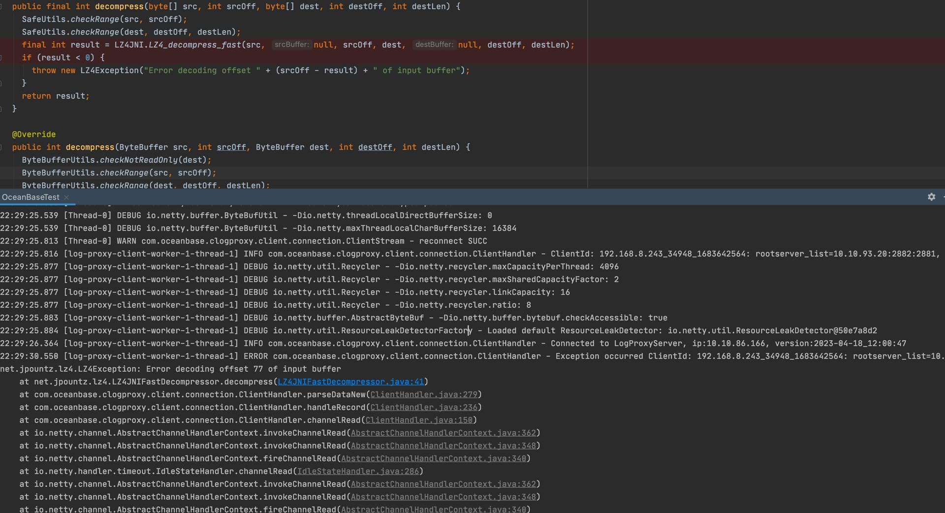

请问net.jpountz.lz4.LZ4Exception: Error decoding offset 77 of input buffer异常是什么意思?
您好,请问咱们用的client 版本是多少呢?这个是server与client 数据的压缩协议上存在问题了
建议使用1.1.0版本,https://github.com/oceanbase/oblogclient/releases
