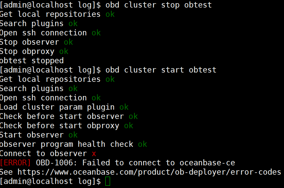

重启动报错[ERROR] OBD-1006: Failed to connect to oceanbase-ce
【 OB or 其他组件 】OB
【 使用版本 】社区版4.0
【问题描述】部署好时可以进入租户,但重启就报连接ob错误。重启动报错[ERROR] OBD-1006: Failed to connect to oceanbase-ce

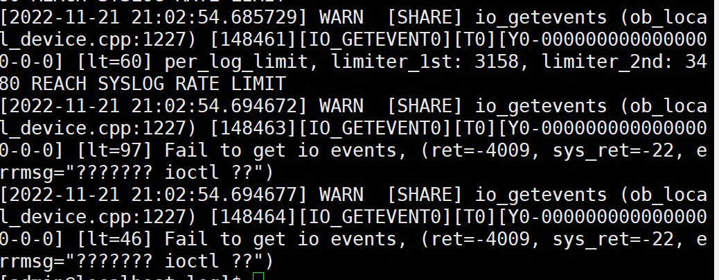

错误日志:[2022-11-21 21:02:54.680348] WARN [SHARE] io_getevents (ob_local_device.cpp:1227) [148463][IO_GETEVENT0][T0][Y0-0000000000000000-0-0] [lt=37] Fail to get io events, (ret=-4009, sys_ret=-22, errmsg="??? ioctl ??")
[2022-11-21 21:02:54.680666] WARN [SHARE] io_getevents (ob_local_device.cpp:1227) [148463][IO_GETEVENT0][T0][Y0-0000000000000000-0-0] [lt=49] per_log_limit, limiter_1st: 3158, limiter_2nd: 3480 REACH SYSLOG RATE LIMIT
[2022-11-21 21:02:54.682481] WARN [SHARE] io_getevents (ob_local_device.cpp:1227) [148460][IO_GETEVENT0][T0][Y0-0000000000000000-0-0] [lt=55] per_log_limit, limiter_1st: 3158, limiter_2nd: 3480 REACH SYSLOG RATE LIMIT
[2022-11-21 21:02:54.685084] WARN [SHARE] io_getevents (ob_local_device.cpp:1227) [148458][IO_GETEVENT0][T0][Y0-0000000000000000-0-0] [lt=77] per_log_limit, limiter_1st: 3158, limiter_2nd: 3480 REACH SYSLOG RATE LIMIT
看您的日志是通过OBD部署的,错误码是OBD-1006,有三种可能:
  1. OBD 和目标机器之间网络不连通。
  2. 对应的组件进程已经退出或者不提供服务。
  3. 账号密码不匹配。
    可以参考错误码文档
    https://www.oceanbase.com/docs/community-obd-cn-10000000000900358
