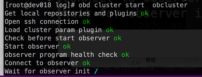

obd单机部署服务启动失败
【 OB or 其他组件 】ob
【 使用版本 】3.1.4
【问题描述】清晰明确描述问题
observer 服务单机版部署的,重启后一直卡在 observer init 环节,obd 日志也显示 init 字样,observer.log中有 ERROR partition table update task cost too much time to execute ;分区表更新任务执行过长错误。
[2022-09-15 18:34:22.418152] INFO [SERVER] ob_partition_table_updater.cpp:898 [1296][140][YB42AC119776-0005E8B19A5A9376] [lt=4]
[dc=0] batch update partition table fail, reput to queue(tasks.count()=122)
[2022-09-15 18:34:22.418215] ERROR [SERVER] check_task_status (ob_partition_table_updater.cpp:114) [1296][140][YB42AC119776-0005E
8B19A5A9377] [lt=7] [dc=0] partition table update task cost too much time to execute(*this={part_key:{tid:1100611139403779, parti
tion_id:0, part_cnt:0}, data_version:0, first_submit_time:1663224410560890, is_remove:false, with_role:true}, safe_interval=12000
0000, cost_time=13651857315, interval=1800000000) BACKTRACE:0x9a98e9e 0x986d141 0x22e9b7e 0x22e97bb 0x22e94e7 0x93f842b 0x936119c
0x9368127 0x9451863 0x944dd63 0x2ca95d4 0x2cabf02 0x9820da5 0x981f792 0x981c24f
[2022-09-15 18:34:22.418250] ERROR [SERVER] check_task_status (ob_partition_table_updater.cpp:114) [1296][140][YB42AC119776-0005E
8B19A5A9377] [lt=25] [dc=0] partition table update task cost too much time to execute(*this={part_key:{tid:1100611139403780, part
ition_id:0, part_cnt:0}, data_version:0, first_submit_time:1663224407328695, is_remove:false, with_role:true}, safe_interval=1200
00000, cost_time=13655089553, interval=1800000000) BACKTRACE:0x9a98e9e 0x986d141 0x22e9b7e 0x22e97bb 0x22e94e7 0x93f842b 0x936119
c 0x9368127 0x9451863 0x944dd63 0x2ca95d4 0x2cabf02 0x9820da5 0x981f792 0x981c24f
【问题现象及影响】
正在处理:observer-log.png…
