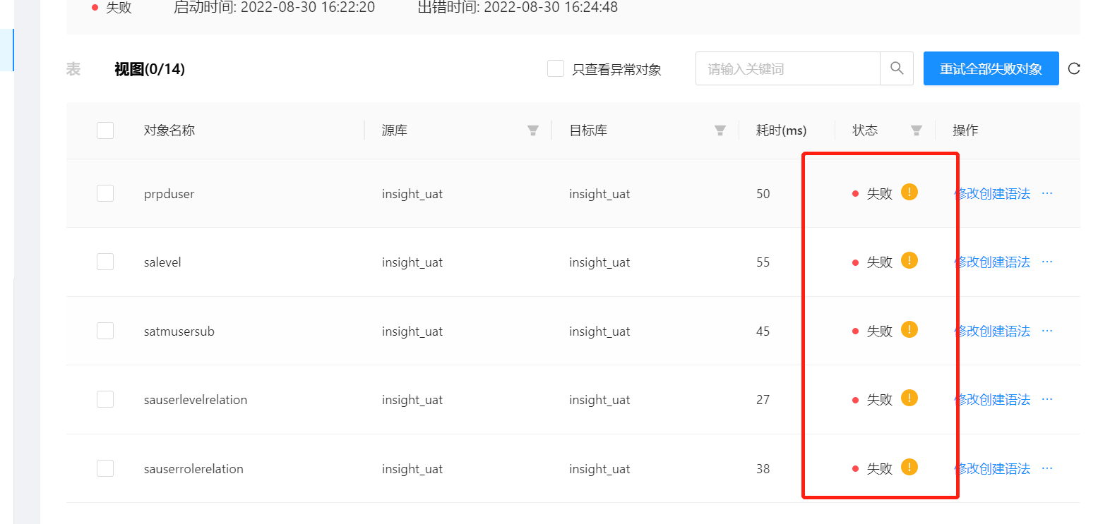

刚才的问题解决了,是因为源mysql有几个视图依赖的表没了,所以报那个错,但是其他视图在转换的时候报错了:
insight_uat
SQL SECURITY DEFINER VIEW prpduser
AS select a001
.A001735
AS USERCODE
,a001
.A001001
AS USERNAME
,a001
.A001301
AS USERENAME
,a001
.A001302
AS PASSWORD
,a001
.A001303
AS SEAL
,a001
.A001304
AS PASSWORDSETDATE
,a001
.A001305
AS PASSWORDEXPIREDATE
,a001
.A001306
AS COMCODE
,a001
.A001307
AS MAKECOM
,a001
.A001210
AS ACCOUNTCODE
,a001
.A001308
AS PHONE
,a001
.A001715
AS MOBILE
,a001
.A001209
AS ADDRESS
,a001
.A001223
AS POSTCODE
,a001
.A001309
AS EMAIL
,a001
.A001310
AS USERFLAG
,a001
.A001311
AS LOGINSYSTEM
,a001
.A001312
AS NEWUSERCODE
,(case when (a001
.A001725
= ‘014500301’) then ‘1’ else ‘0’ end) AS VALIDSTATUS
,a001
.A001313
AS ARTICLECODE
,a001
.A001314
AS FLAG
from a001
where (a001
.ORG_TYPE
= ‘2’)刚才有测试了下,相同的表和视图,5.7可以同步,8.0报视图转换语法错误,是不是oms对mysql8.0的支持有问题
