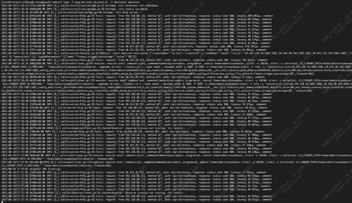

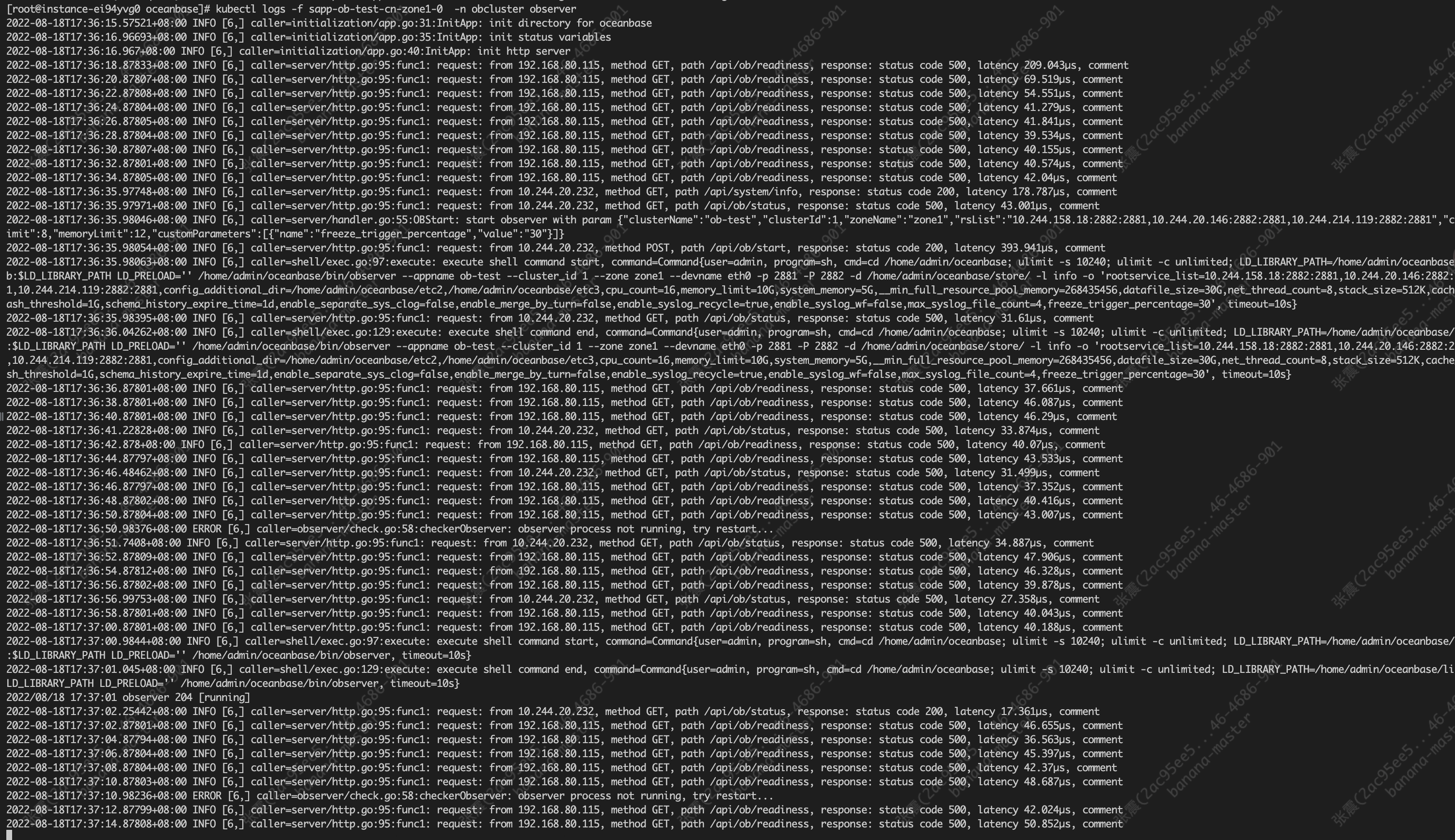

【问题描述】通过operator部署后observer日志报错健康监测接口500,不断重启
【复现路径】依照官方文档进行部署https://www.oceanbase.com/docs/community/observer-cn/V3.1.4/10000000000449661
【问题现象及影响】服务无法正常启动,服务不可用
看日志中有报错 observer process not running, 应该是 observer 进程退出了,需要看一下 observer 的日志,日志在容器里 /home/admin/oceanbase/log/observer.log。
另外,给 observer 的资源是否够用,需要确认下宿主机上的日志,是否 OOM 被 kill。

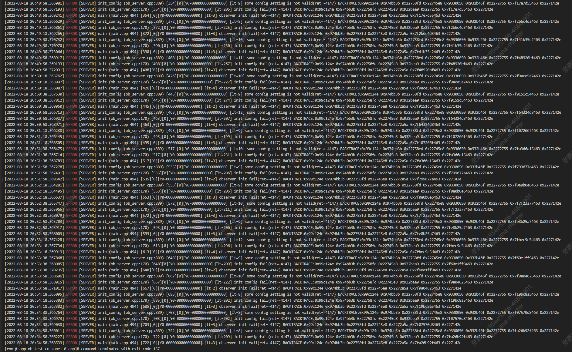

OBSERVER日志如下
资源够用 limit设置8c12G
完整observer启动日志

[root@sapp-ob-test-cn-zone1-0 admin]# cat log/observer.log|grep ERR
[2022-08-18 21:14:19.338408] INFO  [SHARE.SCHEMA] ob_schema_struct.cpp:168 [63][0][Y0-0000000000000000] [lt=5] [dc=0] set tenant space table name(key=15656453541099564691, table={database_id:6, name_case_mode:2, table_name:"ALL_VIRTUAL_ERROR_AGENT"})
[2022-08-18 21:14:19.340332] INFO  [SHARE.SCHEMA] ob_schema_struct.cpp:168 [63][0][Y0-0000000000000000] [lt=5] [dc=0] set tenant space table name(key=2868000062764514379, table={database_id:6, name_case_mode:2, table_name:"ALL_VIRTUAL_TENANT_ERROR_REAL_AGENT"})
[2022-08-18 21:14:19.342484] INFO  [SHARE.SCHEMA] ob_schema_struct.cpp:168 [63][0][Y0-0000000000000000] [lt=2] [dc=0] set tenant space table name(key=5043483467960944309, table={database_id:6, name_case_mode:2, table_name:"ALL_ERRORS"})
[2022-08-18 21:14:19.342495] INFO  [SHARE.SCHEMA] ob_schema_struct.cpp:168 [63][0][Y0-0000000000000000] [lt=5] [dc=0] set tenant space table name(key=8129345318515628085, table={database_id:6, name_case_mode:2, table_name:"DBA_ERRORS"})
[2022-08-18 21:14:19.342502] INFO  [SHARE.SCHEMA] ob_schema_struct.cpp:168 [63][0][Y0-0000000000000000] [lt=5] [dc=0] set tenant space table name(key=4571968748190436015, table={database_id:6, name_case_mode:2, table_name:"USER_ERRORS"})
[2022-08-18 21:14:19.552188] ERROR [CLOG] update_free_quota (ob_log_file_pool.cpp:465) [63][0][Y0-0000000000000000] [lt=10] [dc=0] clog disk is almost full(type_=0, total_size=3220693843968, free_quota=-120590434304, warn_percent(%)=80, limit_percent=95, used_percent(%)=83) BACKTRACE:0x99c124e 0x9754f61 0x23c18c6 0x23c14eb 0x23c1189 0x742822c 0x739c762 0x739be20 0x33160e8 0x331c276 0x3319b00 0x33181f4 0x332f678 0x3337665 0x849d411 0x849c138 0x7ddfc0a 0x9335d11 0x932b987 0x2272755 0x7fc0de754463 0x227142e
[2022-08-18 21:14:19.579312] ERROR [STORAGE] open (ob_local_file_system.cpp:402) [63][0][Y0-0000000000000000] [lt=8] [dc=0] allocate file error(ret=-4009, sys_ret=-1, store_path_="/home/admin/oceanbase/store//sstable/block_file", falloc_size=32212254720, errno=95, errmsg="Operation not supported") BACKTRACE:0x99c124e 0x9754f61 0x23c18c6 0x23c14eb 0x23c1189 0x83ad007 0x833b127 0x833a155 0x8478dd9 0x7ddfc61 0x9335d11 0x932b987 0x2272755 0x7fc0de754463 0x227142e
[2022-08-18 21:14:19.835650] ERROR [SERVER] init_storage (ob_server.cpp:1692) [63][0][Y0-0000000000000000] [lt=2] [dc=0] init partition service fail(ret=-4009, storage_env_={data_dir:"/home/admin/oceanbase/store/", default_block_size:2097152, disk_avail_space:32212254720, datafile_disk_percentage:90, redundancy_level:1, log_spec:{log_dir:"/home/admin/oceanbase/store//slog", max_log_size:268435456, log_sync_type:0}, clog_dir:"/home/admin/oceanbase/store//clog", ilog_dir:"/home/admin/oceanbase/store//ilog", clog_shm_path:"/home/admin/oceanbase/store//clog_shm", ilog_shm_path:"/home/admin/oceanbase/store//ilog_shm", index_cache_priority:10, user_block_cache_priority:1, user_row_cache_priority:1, fuse_row_cache_priority:1, bf_cache_priority:1, clog_cache_priority:1, index_clog_cache_priority:1, bf_cache_miss_count_threshold:100, ethernet_speed:1310720000}) BACKTRACE:0x99c124e 0x9754f61 0x22b0def 0x22b0a3b 0x22b0802 0x80587fb 0x9335f3e 0x932b987 0x2272755 0x7fc0de754463 0x227142e
[2022-08-18 21:14:20.126840] ERROR [SERVER] main (main.cpp:494) [63][0][Y0-0000000000000000] [lt=2] [dc=0] observer init fail(ret=-4009) BACKTRACE:0x99c124e 0x9754f61 0x2276104 0x2275beb 0x2275951 0x22745e8 0x2272a5a 0x7fc0de754463 0x227142e
[2022-08-18 21:14:44.091457] ERROR [SERVER] init_config (ob_server.cpp:889) [225][0][Y0-0000000000000000] [lt=8] some config setting is not valid(ret=-4147) BACKTRACE:0x99c124e 0x974bb3b 0x22758fd 0x22745e8 0x9330050 0x932b46f 0x2272755 0x7f60460e3463 0x227142e
[2022-08-18 21:14:44.091665] ERROR [SERVER] init (ob_server.cpp:170) [225][0][Y0-0000000000000000] [lt=201] init config fail(ret=-4147) BACKTRACE:0x99c124e 0x974bb3b 0x22758fd 0x22745e8 0x932bea9 0x2272755 0x7f60460e3463 0x227142e
[2022-08-18 21:14:44.093717] ERROR [SERVER] main (main.cpp:494) [225][0][Y0-0000000000000000] [lt=3] observer init fail(ret=-4147) BACKTRACE:0x99c124e 0x974bb3b 0x22758fd 0x22745e8 0x2272a5a 0x7f60460e3463 0x227142e
[2022-08-18 21:15:04.089825] ERROR [SERVER] init_config (ob_server.cpp:889) [243][0][Y0-0000000000000000] [lt=8] some config setting is not valid(ret=-4147) BACKTRACE:0x99c124e 0x974bb3b 0x22758fd 0x22745e8 0x9330050 0x932b46f 0x2272755 0x7f516e750463 0x227142e
[2022-08-18 21:15:04.090040] ERROR [SERVER] init (ob_server.cpp:170) [243][0][Y0-0000000000000000] [lt=207] init config fail(ret=-4147) BACKTRACE:0x99c124e 0x974bb3b 0x22758fd 0x22745e8 0x932bea9 0x2272755 0x7f516e750463 0x227142e
[2022-08-18 21:15:04.092133] ERROR [SERVER] main (main.cpp:494) [243][0][Y0-0000000000000000] [lt=3] observer init fail(ret=-4147) BACKTRACE:0x99c124e 0x974bb3b 0x22758fd 0x22745e8 0x2272a5a 0x7f516e750463 0x227142e
[2022-08-18 21:15:24.085863] ERROR [SERVER] init_config (ob_server.cpp:889) [261][0][Y0-0000000000000000] [lt=9] some config setting is not valid(ret=-4147) BACKTRACE:0x99c124e 0x974bb3b 0x22758fd 0x22745e8 0x9330050 0x932b46f 0x2272755 0x7f5f63533463 0x227142e
[2022-08-18 21:15:24.086077] ERROR [SERVER] init (ob_server.cpp:170) [261][0][Y0-0000000000000000] [lt=206] init config fail(ret=-4147) BACKTRACE:0x99c124e 0x974bb3b 0x22758fd 0x22745e8 0x932bea9 0x2272755 0x7f5f63533463 0x227142e
[2022-08-18 21:15:24.088203] ERROR [SERVER] main (main.cpp:494) [261][0][Y0-0000000000000000] [lt=3] observer init fail(ret=-4147) BACKTRACE:0x99c124e 0x974bb3b 0x22758fd 0x22745e8 0x2272a5a 0x7f5f63533463 0x227142e
[2022-08-18 21:15:44.086344] ERROR [SERVER] init_config (ob_server.cpp:889) [279][0][Y0-0000000000000000] [lt=8] some config setting is not valid(ret=-4147) BACKTRACE:0x99c124e 0x974bb3b 0x22758fd 0x22745e8 0x9330050 0x932b46f 0x2272755 0x7ff757be5463 0x227142e
[2022-08-18 21:15:44.086549] ERROR [SERVER] init (ob_server.cpp:170) [279][0][Y0-0000000000000000] [lt=198] init config fail(ret=-4147) BACKTRACE:0x99c124e 0x974bb3b 0x22758fd 0x22745e8 0x932bea9 0x2272755 0x7ff757be5463 0x227142e
[2022-08-18 21:15:44.088716] ERROR [SERVER] main (main.cpp:494) [279][0][Y0-0000000000000000] [lt=2] observer init fail(ret=-4147) BACKTRACE:0x99c124e 0x974bb3b 0x22758fd 0x22745e8 0x2272a5a 0x7ff757be5463 0x227142e
[2022-08-18 21:16:04.087419] ERROR [SERVER] init_config (ob_server.cpp:889) [297][0][Y0-0000000000000000] [lt=9] some config setting is not valid(ret=-4147) BACKTRACE:0x99c124e 0x974bb3b 0x22758fd 0x22745e8 0x9330050 0x932b46f 0x2272755 0x7f80210dc463 0x227142e
[2022-08-18 21:16:04.087620] ERROR [SERVER] init (ob_server.cpp:170) [297][0][Y0-0000000000000000] [lt=193] init config fail(ret=-4147) BACKTRACE:0x99c124e 0x974bb3b 0x22758fd 0x22745e8 0x932bea9 0x2272755 0x7f80210dc463 0x227142e
[2022-08-18 21:16:04.089627] ERROR [SERVER] main (main.cpp:494) [297][0][Y0-0000000000000000] [lt=3] observer init fail(ret=-4147) BACKTRACE:0x99c124e 0x974bb3b 0x22758fd 0x22745e8 0x2272a5a 0x7f80210dc463 0x227142e
[2022-08-18 21:16:24.089581] ERROR [SERVER] init_config (ob_server.cpp:889) [318][0][Y0-0000000000000000] [lt=8] some config setting is not valid(ret=-4147) BACKTRACE:0x99c124e 0x974bb3b 0x22758fd 0x22745e8 0x9330050 0x932b46f 0x2272755 0x7f6bca6f1463 0x227142e
[2022-08-18 21:16:24.089821] ERROR [SERVER] init (ob_server.cpp:170) [318][0][Y0-0000000000000000] [lt=233] init config fail(ret=-4147) BACKTRACE:0x99c124e 0x974bb3b 0x22758fd 0x22745e8 0x932bea9 0x2272755 0x7f6bca6f1463 0x227142e
[2022-08-18 21:16:24.091864] ERROR [SERVER] main (main.cpp:494) [318][0][Y0-0000000000000000] [lt=3] observer init fail(ret=-4147) BACKTRACE:0x99c124e 0x974bb3b 0x22758fd 0x22745e8 0x2272a5a 0x7f6bca6f1463 0x227142e
[2022-08-18 21:16:44.086144] ERROR [SERVER] init_config (ob_server.cpp:889) [336][0][Y0-0000000000000000] [lt=9] some config setting is not valid(ret=-4147) BACKTRACE:0x99c124e 0x974bb3b 0x22758fd 0x22745e8 0x9330050 0x932b46f 0x2272755 0x7fe4a42f9463 0x227142e
[2022-08-18 21:16:44.086381] ERROR [SERVER] init (ob_server.cpp:170) [336][0][Y0-0000000000000000] [lt=229] init config fail(ret=-4147) BACKTRACE:0x99c124e 0x974bb3b 0x22758fd 0x22745e8 0x932bea9 0x2272755 0x7fe4a42f9463 0x227142e
[2022-08-18 21:16:44.088492] ERROR [SERVER] main (main.cpp:494) [336][0][Y0-0000000000000000] [lt=3] observer init fail(ret=-4147) BACKTRACE:0x99c124e 0x974bb3b 0x22758fd 0x22745e8 0x2272a5a 0x7fe4a42f9463 0x227142e
[2022-08-18 21:17:04.087921] ERROR [SERVER] init_config (ob_server.cpp:889) [354][0][Y0-0000000000000000] [lt=9] some config setting is not valid(ret=-4147) BACKTRACE:0x99c124e 0x974bb3b 0x22758fd 0x22745e8 0x9330050 0x932b46f 0x2272755 0x7f3411c2e463 0x227142e
[2022-08-18 21:17:04.088137] ERROR [SERVER] init (ob_server.cpp:170) [354][0][Y0-0000000000000000] [lt=209] init config fail(ret=-4147) BACKTRACE:0x99c124e 0x974bb3b 0x22758fd 0x22745e8 0x932bea9 0x2272755 0x7f3411c2e463 0x227142e
[2022-08-18 21:17:04.090253] ERROR [SERVER] main (main.cpp:494) [354][0][Y0-0000000000000000] [lt=3] observer init fail(ret=-4147) BACKTRACE:0x99c124e 0x974bb3b 0x22758fd 0x22745e8 0x2272a5a 0x7f3411c2e463 0x227142e
[2022-08-18 21:17:24.090458] ERROR [SERVER] init_config (ob_server.cpp:889) [372][0][Y0-0000000000000000] [lt=8] some config setting is not valid(ret=-4147) BACKTRACE:0x99c124e 0x974bb3b 0x22758fd 0x22745e8 0x9330050 0x932b46f 0x2272755 0x7fb2e5b56463 0x227142e
[2022-08-18 21:17:24.090667] ERROR [SERVER] init (ob_server.cpp:170) [372][0][Y0-0000000000000000] [lt=202] init config fail(ret=-4147) BACKTRACE:0x99c124e 0x974bb3b 0x22758fd 0x22745e8 0x932bea9 0x2272755 0x7fb2e5b56463 0x227142e
[2022-08-18 21:17:24.092749] ERROR [SERVER] main (main.cpp:494) [372][0][Y0-0000000000000000] [lt=3] observer init fail(ret=-4147) BACKTRACE:0x99c124e 0x974bb3b 0x22758fd 0x22745e8 0x2272a5a 0x7fb2e5b56463 0x227142e
[2022-08-18 21:17:44.090925] ERROR [SERVER] init_config (ob_server.cpp:889) [390][0][Y0-0000000000000000] [lt=8] some config setting is not valid(ret=-4147) BACKTRACE:0x99c124e 0x974bb3b 0x22758fd 0x22745e8 0x9330050 0x932b46f 0x2272755 0x7f84b543d463 0x227142e
[2022-08-18 21:17:44.091148] ERROR [SERVER] init (ob_server.cpp:170) [390][0][Y0-0000000000000000] [lt=216] init config fail(ret=-4147) BACKTRACE:0x99c124e 0x974bb3b 0x22758fd 0x22745e8 0x932bea9 0x2272755 0x7f84b543d463 0x227142e
[2022-08-18 21:17:44.093222] ERROR [SERVER] main (main.cpp:494) [390][0][Y0-0000000000000000] [lt=2] observer init fail(ret=-4147) BACKTRACE:0x99c124e 0x974bb3b 0x22758fd 0x22745e8 0x2272a5a 0x7f84b543d463 0x227142e
[2022-08-18 21:18:04.084728] ERROR [SERVER] init_config (ob_server.cpp:889) [408][0][Y0-0000000000000000] [lt=9] some config setting is not valid(ret=-4147) BACKTRACE:0x99c124e 0x974bb3b 0x22758fd 0x22745e8 0x9330050 0x932b46f 0x2272755 0x7f697b13a463 0x227142e
[2022-08-18 21:18:04.084936] ERROR [SERVER] init (ob_server.cpp:170) [408][0][Y0-0000000000000000] [lt=201] init config fail(ret=-4147) BACKTRACE:0x99c124e 0x974bb3b 0x22758fd 0x22745e8 0x932bea9 0x2272755 0x7f697b13a463 0x227142e
[2022-08-18 21:18:04.087038] ERROR [SERVER] main (main.cpp:494) [408][0][Y0-0000000000000000] [lt=3] observer init fail(ret=-4147) BACKTRACE:0x99c124e 0x974bb3b 0x22758fd 0x22745e8 0x2272a5a 0x7f697b13a463 0x227142e
