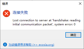

无法连接到数据库
【问题描述】无法连接到数据库
【复现路径】创建,链接
Communications link failure
The last packet sent successfully to the server was 0 milliseconds ago. The driver has not received any packets from the server.
Can not read response from server. Expected to read 4 bytes, read 0 bytes before connection was unexpectedly lost.

1、检查监听服务器监听端口是否正常启动。
2、感觉是握手通信包没有通,连接丢失,感觉可能有安全设备限制了。
