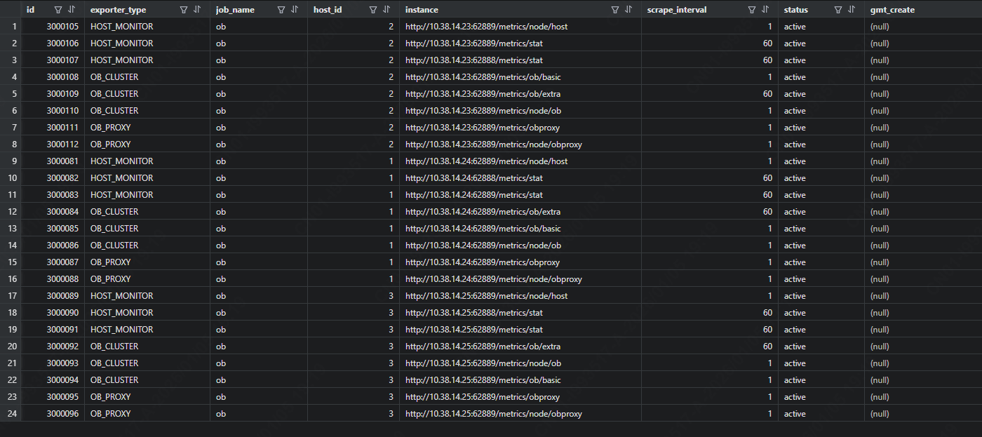

连接到 OCP Meta 租户后查看:
MySQL [(none)]> use ocp;
Database changed
MySQL [ocp]> select * from ocp_exporter_address where instance like '%xx.xxx.211.84%';
select * from ocp_exporter_address where instance like ‘%10.38.14.23%’ union all
select * from ocp_exporter_address where instance like ‘%10.38.14.24%’ union all
select * from ocp_exporter_address where instance like ‘%10.38.14.25%’

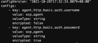

这个里面的密码 手动改过么?

我记得是没有改过,怎么验证 这个?
