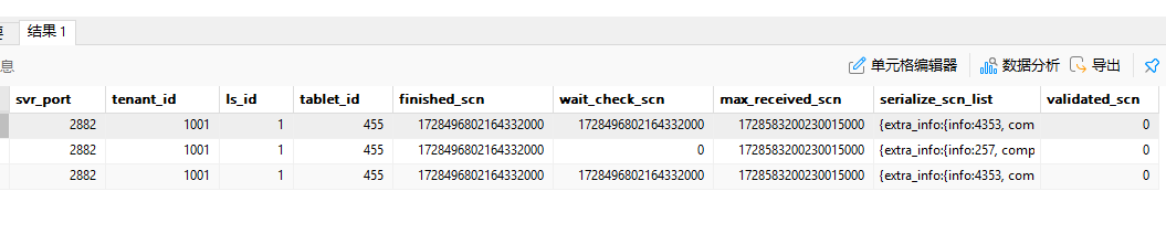

  2. 检查是否有除原报错的之外的未完成的分区合并任务
    select * from __all_virtual_tablet_compaction_info where max_received_scn > finished_scn;
    和已经报错4016的tablet_id做对比,是否有未完成的分区合并任务,如果有的话,需要等待完成

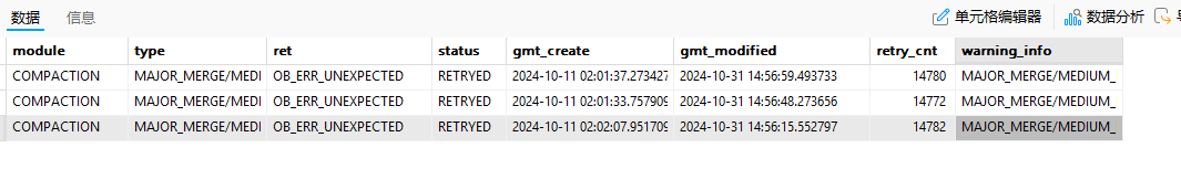

    select * from __all_virtual_dag_warning_history;
等待完成后

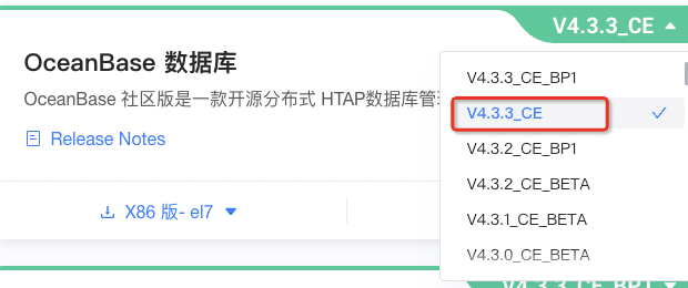

3.下载最新的433rpm包,将rpm包解压后替换原来部署路径下的 ~/observer/bin/observer文件

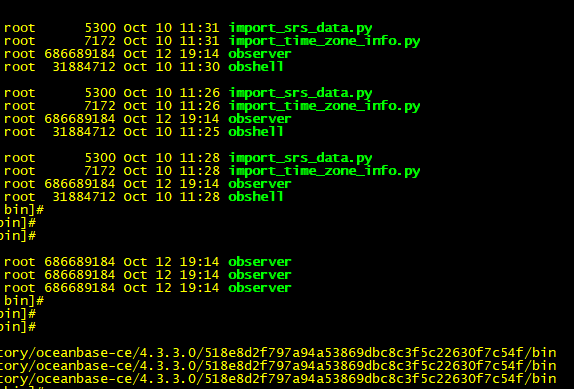

-rwxr-xr-x 1 root root      5300 Oct 22 17:28 import_srs_data.py
-rwxr-xr-x 1 root root      7172 Oct 22 17:28 import_time_zone_info.py
-rwxr-xr-x 1 root root 687995472 Oct 22 20:51 observer
-rwxr-xr-x 1 root root  32080992 Oct 22 17:30 obshell
只需替换observer即可
麻烦给个ocp界面该集群合并状态截图,当前433版本详细版本号
1.看下详细版本号
./observer -V

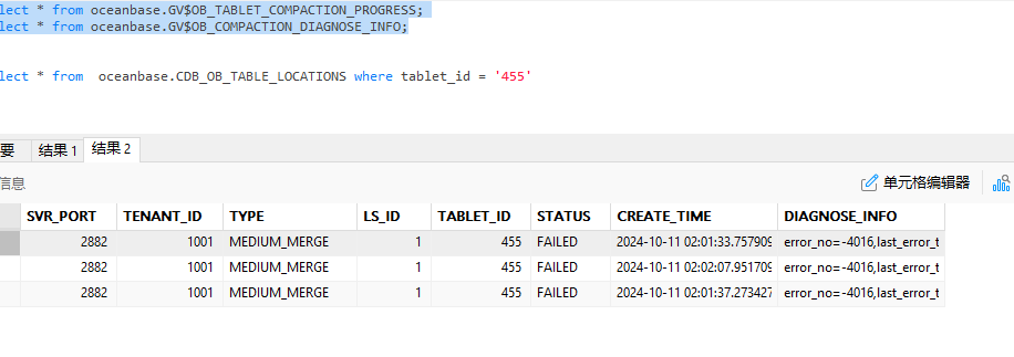

2.failed to merge partition(ret=-4016)报错应该在升级前就有了
grep “failed to merge partition” observer.log
3.根据1,2的结果 你可能需要替换下433版本的observer 二进制文件
参考下 OCP报警:failed to merge partition,错误码=4016 - #9,来自 旭辉
4.完成3后再升级4331
第2步只是检查有没有其他合并在进行,卡着的4016还是卡着,不用处理

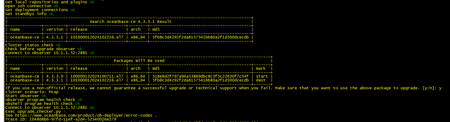

 obd cluster upgrade obtest -c oceanbase-ce -V 4.3.3.1
Get local repositories and plugins ok
Open ssh connection ok
Get deployment connections ok
Get standbys info ok
cluster scenario: htap
Start observer ok
observer program health check ok
obshell program health check ok
Connect to observer 10.1.1.52:2881 ok
Exec upgrade_checker.py x
[2024-11-01 09:08:00.460] [DEBUG] __main__.MyError: 'upgrade checker failed with 2 reasons: [1 tenant is merging, please check] , [6 tablet is merging, please check] '
[2024-11-01 09:08:00.460] [DEBUG] [16850] Failed to execute script executer27
