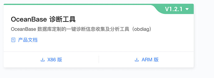

obdiag工具可以从官网的下载链接去下:https://www.oceanbase.com/softwarecenter
使用文档:https://www.oceanbase.com/docs/common-obdiag-cn-1000000000164123
